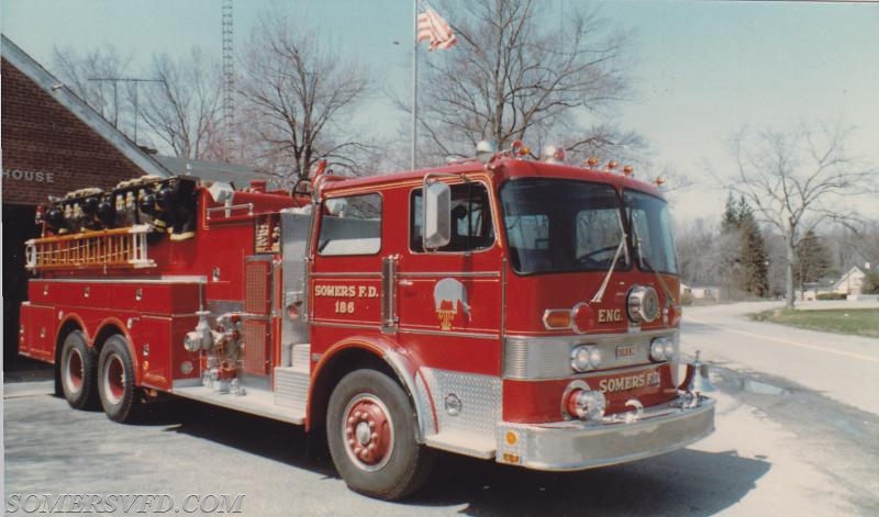

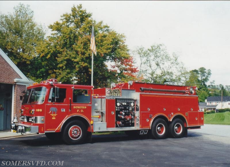

We were donated a truck that was originally from sommers fire dept in weschester county ny. it started as a 1979 Oren and in 1991 was sent to pierce and refurbished with a new cab and body. this truck went to greenville TN area and mcdonald fire dept donated it to us. this is all we know about the truck it has a 8v-92 detroit and a 4 speed allison auto. 1500 g.p.m. waterous pump. i know its not a mack but i figured some of the members on here would know something about this truck. thank you in advance. joe
It should be the old Engine 186.  Its a tandem axle right? somersvfd.com  I remember this rig well.  My department was two towns south.  Website says it was originally a 1000gpm pump not 1500gpm.... Although Pierce may have put a larger  pump on it during the refurb.

the pump has for sure been upgraded we had it pump tested last friday during our anual test on our trucks and it passed with flying colors 1500 gpm. we have been told it has a 2,000 gal a 2,200 gal and a 2,800 gal tank. pierce couldn't give me any info except it was refurbed for somers.
