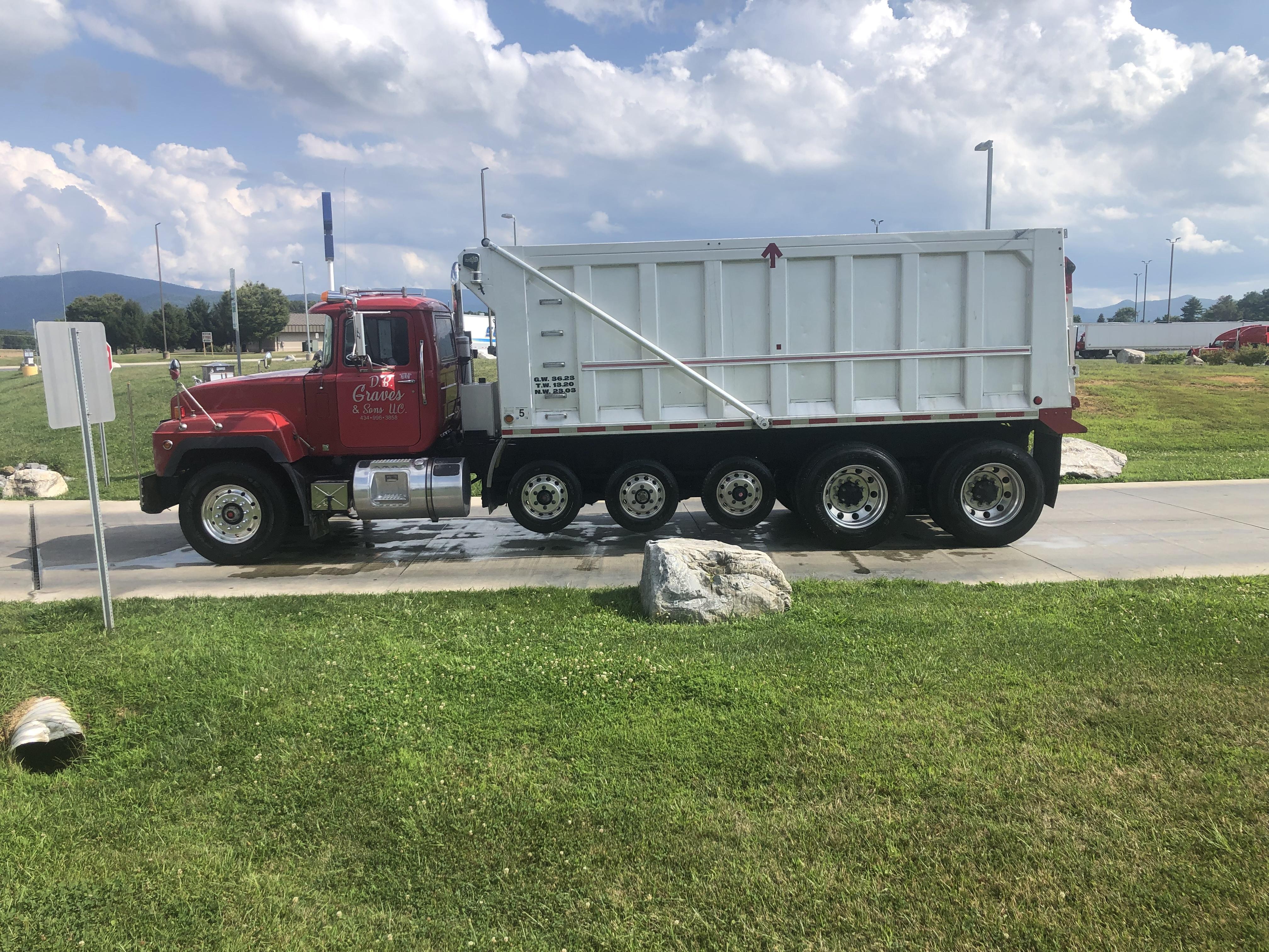

Update on the truck.
I took it to my Mack shop it turned out to be the guy that rebuilt the motor put a junkyard jakebrake housing on the high side. So it had not had the update spring kit installed. So the high side was hung open slightly and that’s why the motor was doing what is was doing. Now it’s all fixed it runs like a top and pull’s like no other.
Just wanted to update everyone for the knowledge
also thanks for you guys and your advice and knowledge it’s what makes this place so helpful.
