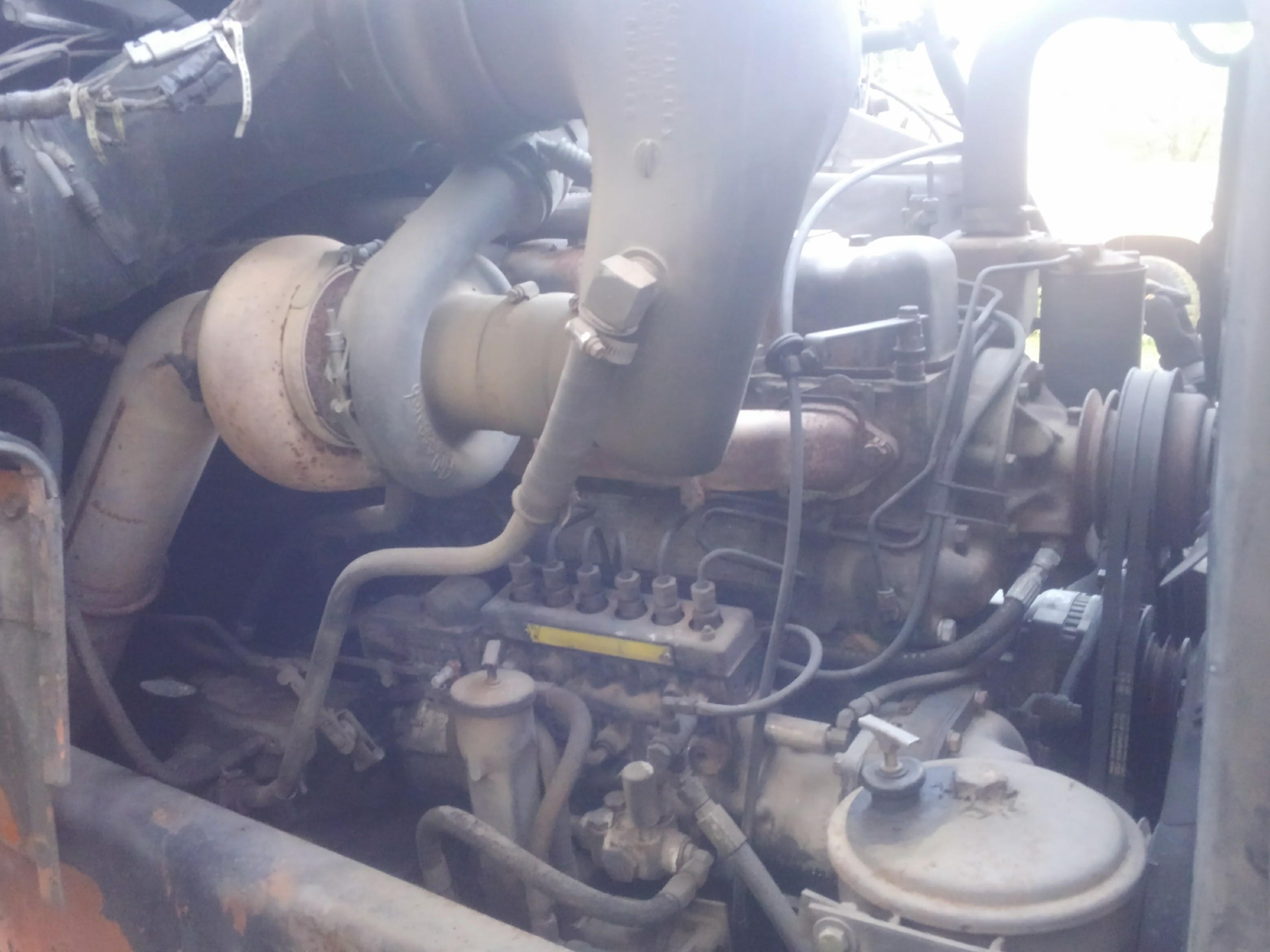

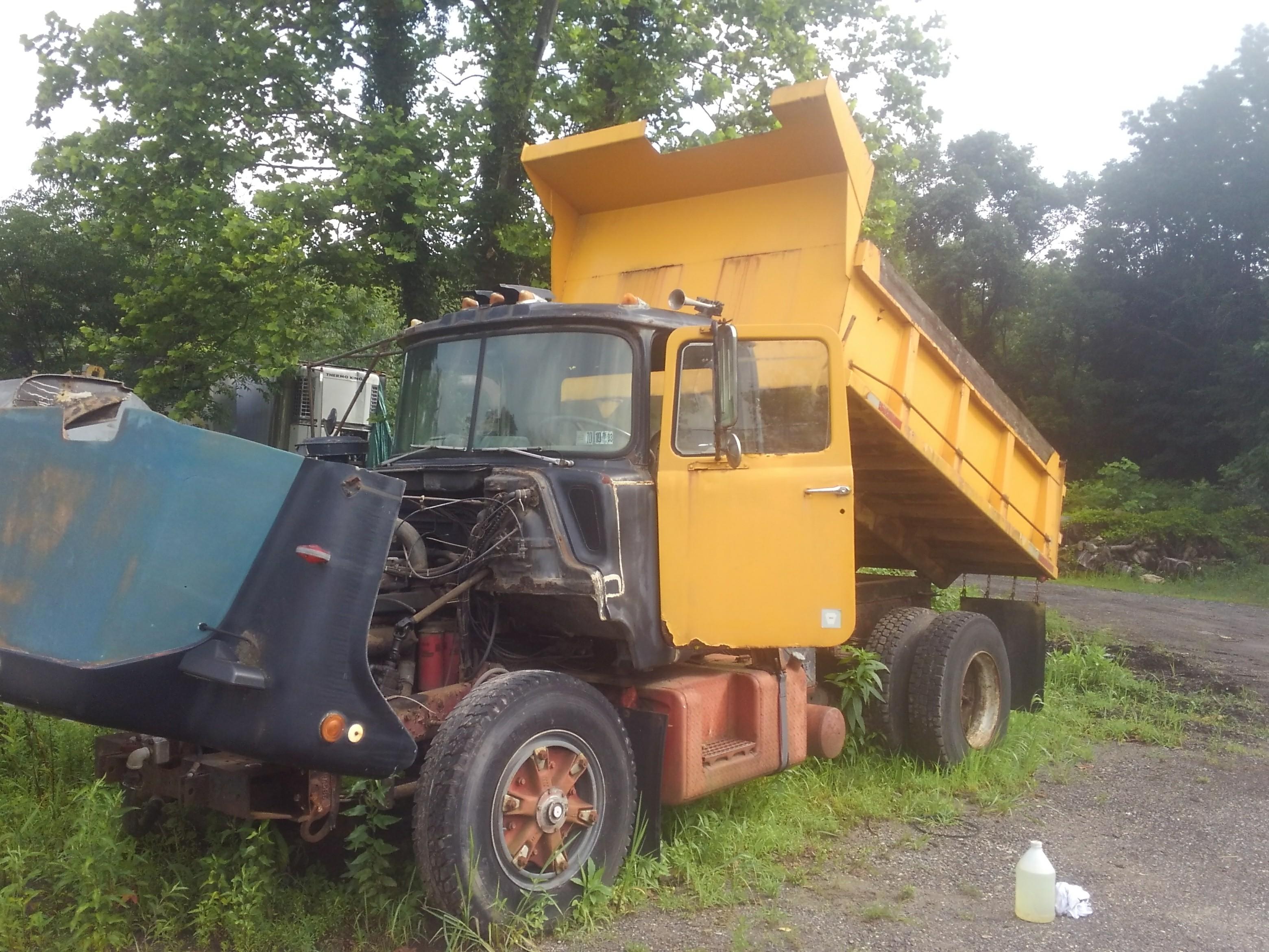

😭 Got this bad boy started up, hasn't run in a few years, was last on the road for snow work in '02, but we have started it and moved it once every 5 years or so. (I think Rob had one of these posts recently about how auto guys make a huge deal about starting their gassers for the first time in 2 years, deisel guys just drop a battery in and hit it!)  Started and ran good, shut it off after a few minutes. A couple hours later it won't start! Cranks good, but isn't getting fuel. We cracked the return line off the injection pump and don't get any fuel gushing out when we crank it.
Did I read somewhere recently that the fuel shutoff rack can stick internally? Could this be the cause? I can almost guarantee the fuel filters haven't been changed since the 90's, we're going to start there. No hand primer pump on the truck, we'll have to pick one up. Suggestions?  1976ish U685T.

Peer in the tank for Schmegma clogging the pick up tube. Had some old fuel grow algae or some thing from sitting and running it disturbed it and floated in to the fuel pick up. Also had some micro bug build a home in the fuel cap vent so try it with them off.

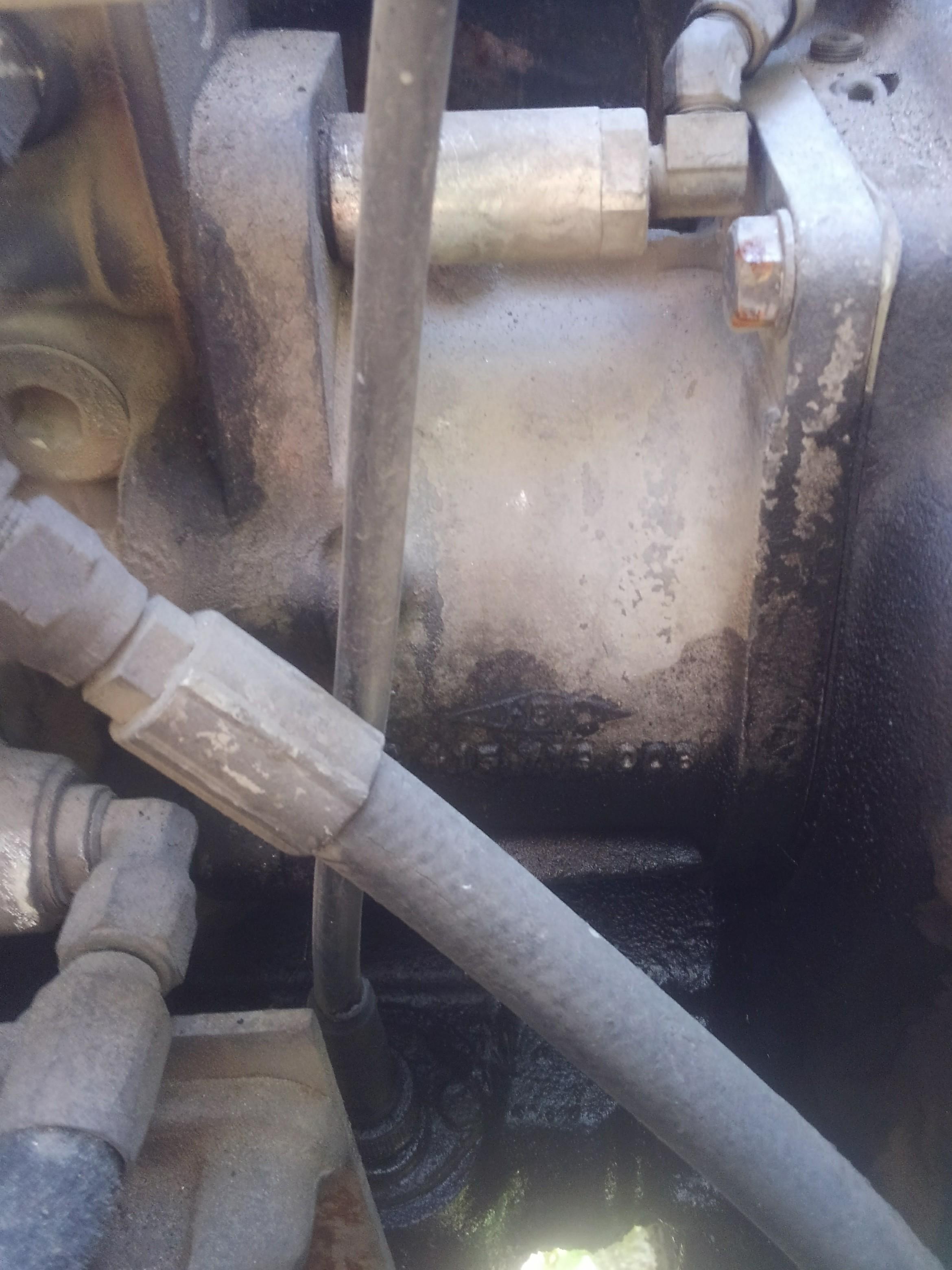

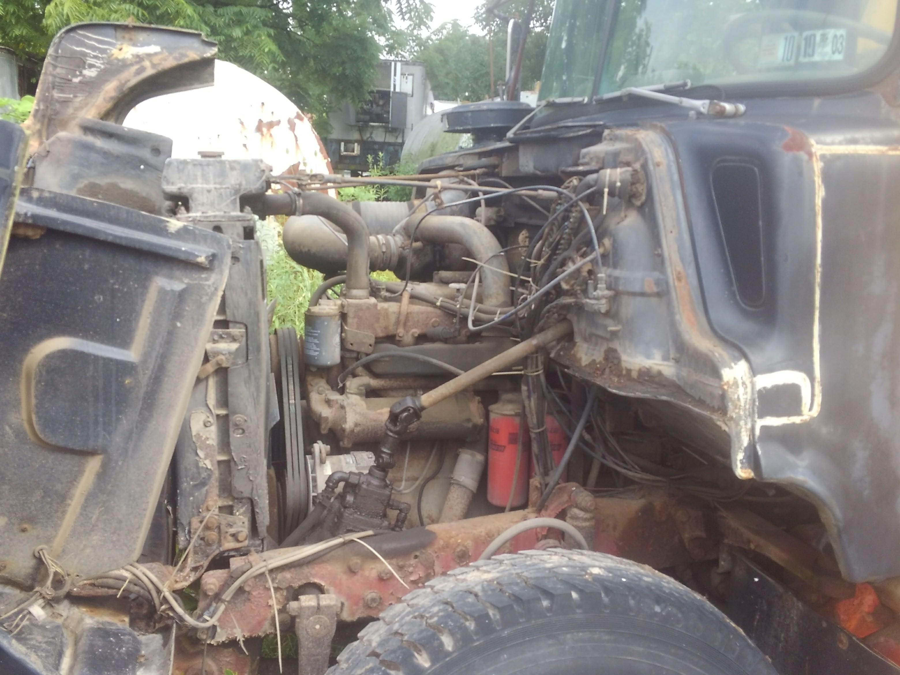

The four valve E6 engines used Robert Bosch pumps in the later years of the engine. The front pump mounting is completely different from the American Bosch and they are not interchangeable. The later two valve engines, (EM6-285/300) could have had a Robert Bosch pump, or American Bosch, as I've seen both. I don't know if the two valve engine front cover and the four valve front cover are interchangeable to swap injection pump styles or not. They very well may be but I've never seen an ENDT-676 engine with a Robert Bosch pump installed myself.
I do believe this is a Robert Bosch mounted on a 1976 endt676 inside my retired 1980 DM686SX.
I think you'll note in the picture that the front of the pump actually is 4 bolts. But they use an adapter that uses a 3 bolt pattern to bolt to the block. You can just see one of the bosses on the pump side of the adapter. I can double check later to make sure I'm right, but I believe all endt pumps have an adapter section between them and the block.

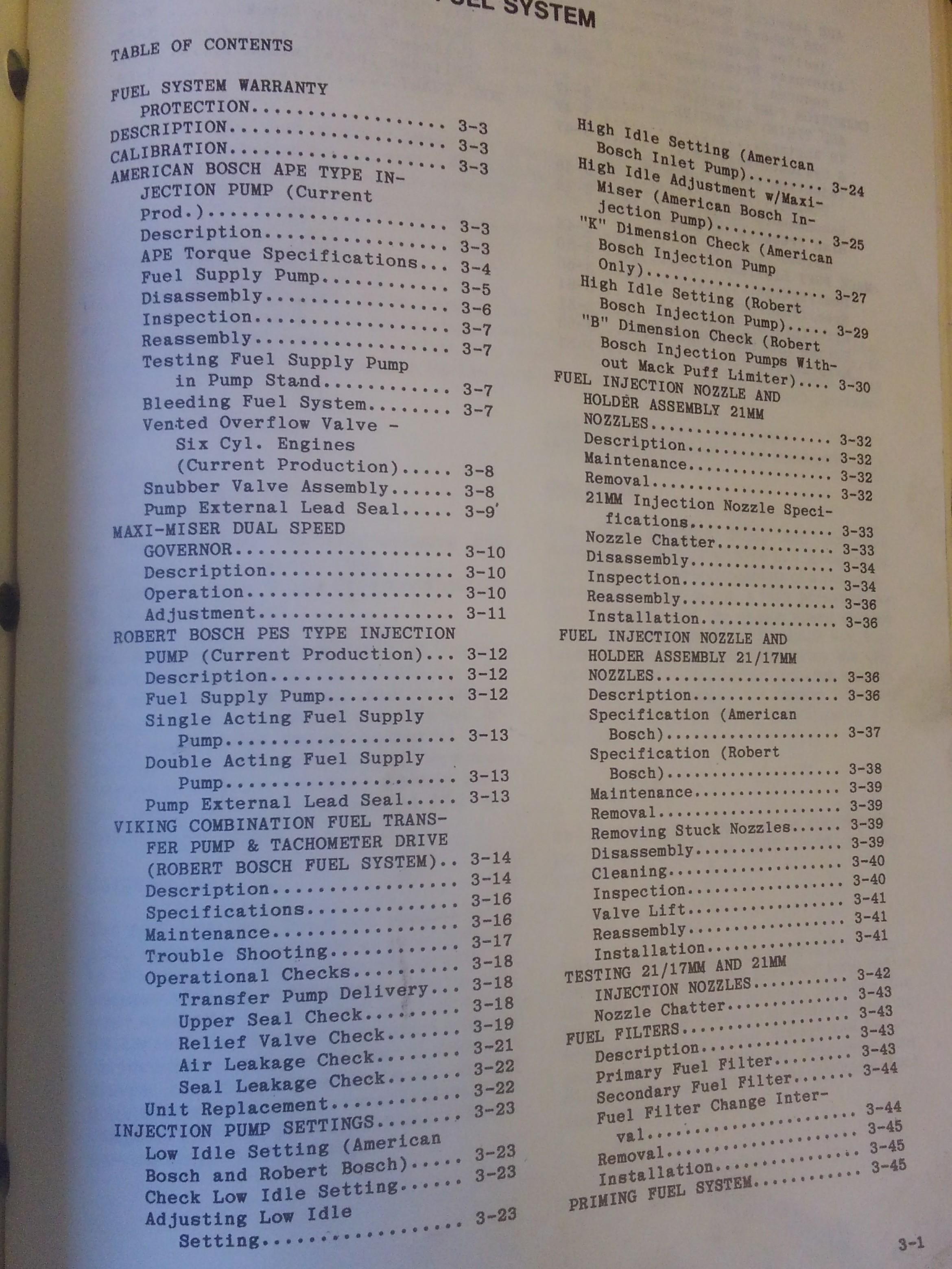

Here is my Mack book. Robert Bosch is mentioned up front in every engine book I have in binder #1, both 2vh and 4vh engines.  American Bosch is mentioned through 1983 and then in 1984 American Bosch became "United Technologies Diesel Systems".

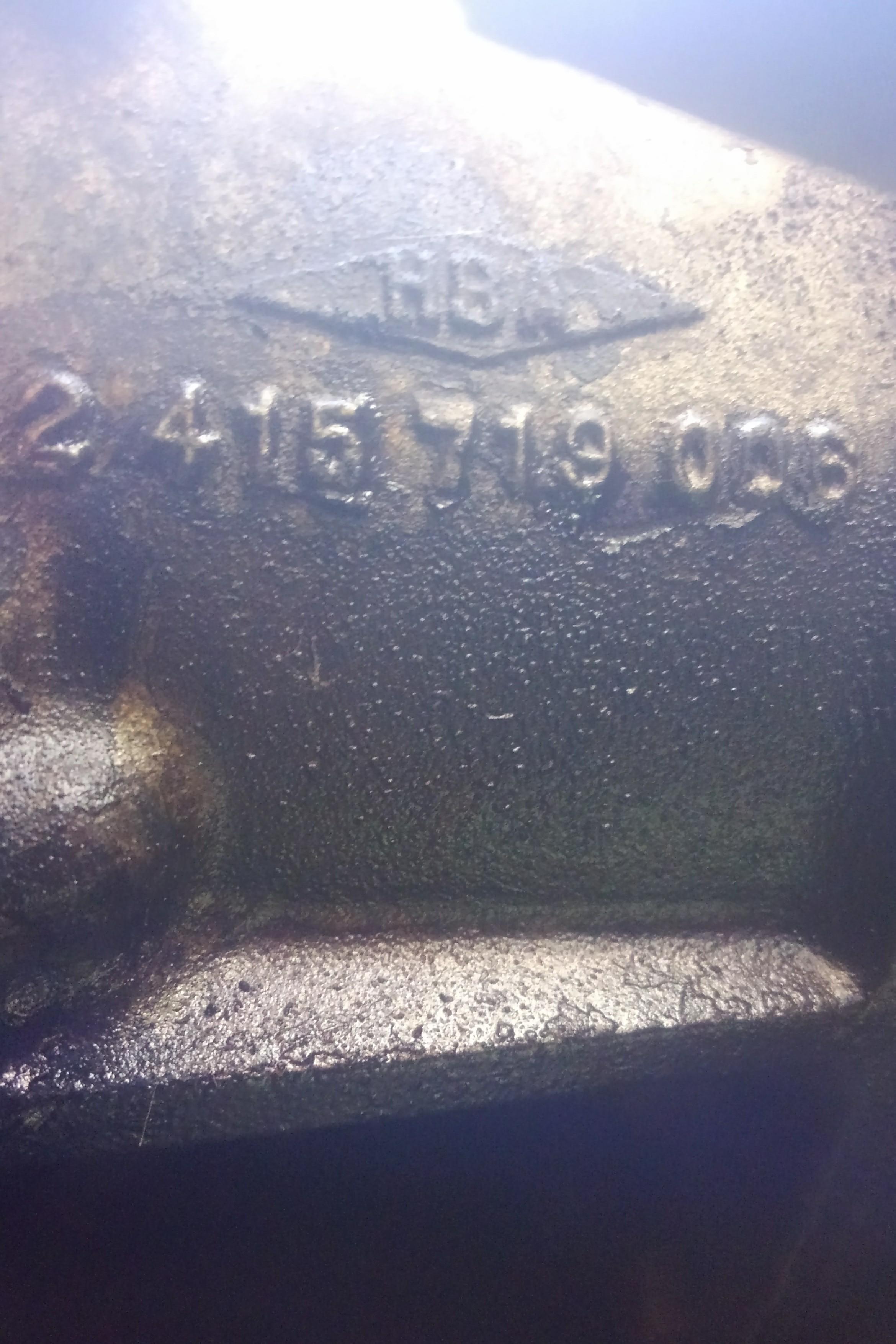

And the casting number on the Robert Bosch adapter.
Back to my original post, it was the supply line my dad cracked on the pump and got nothing. Shut down lever has resistance, so we're looking at algea.  We've had algea issues before in other equipment that's sat, I just misunderstood which line my dad cracked.
