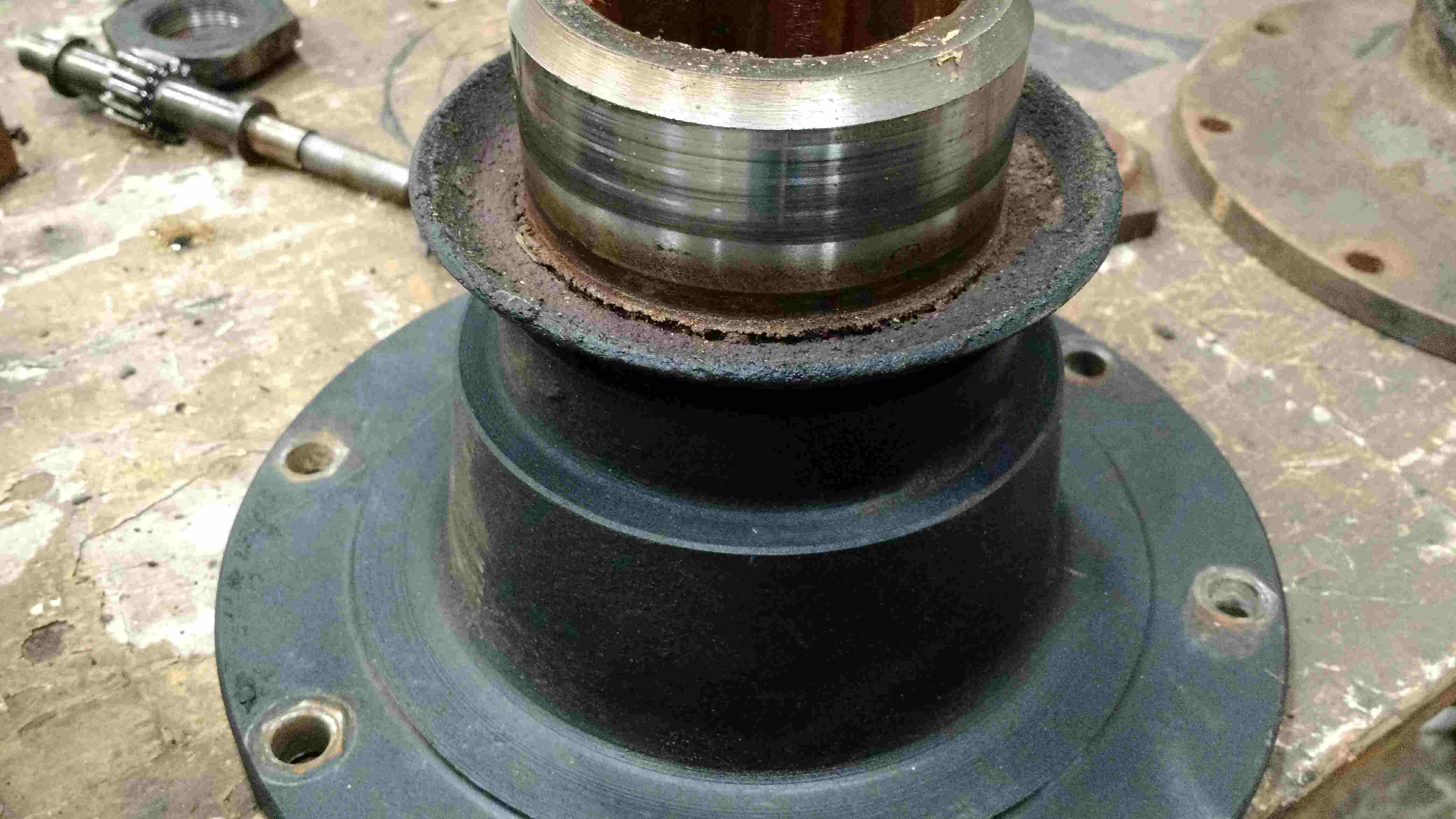

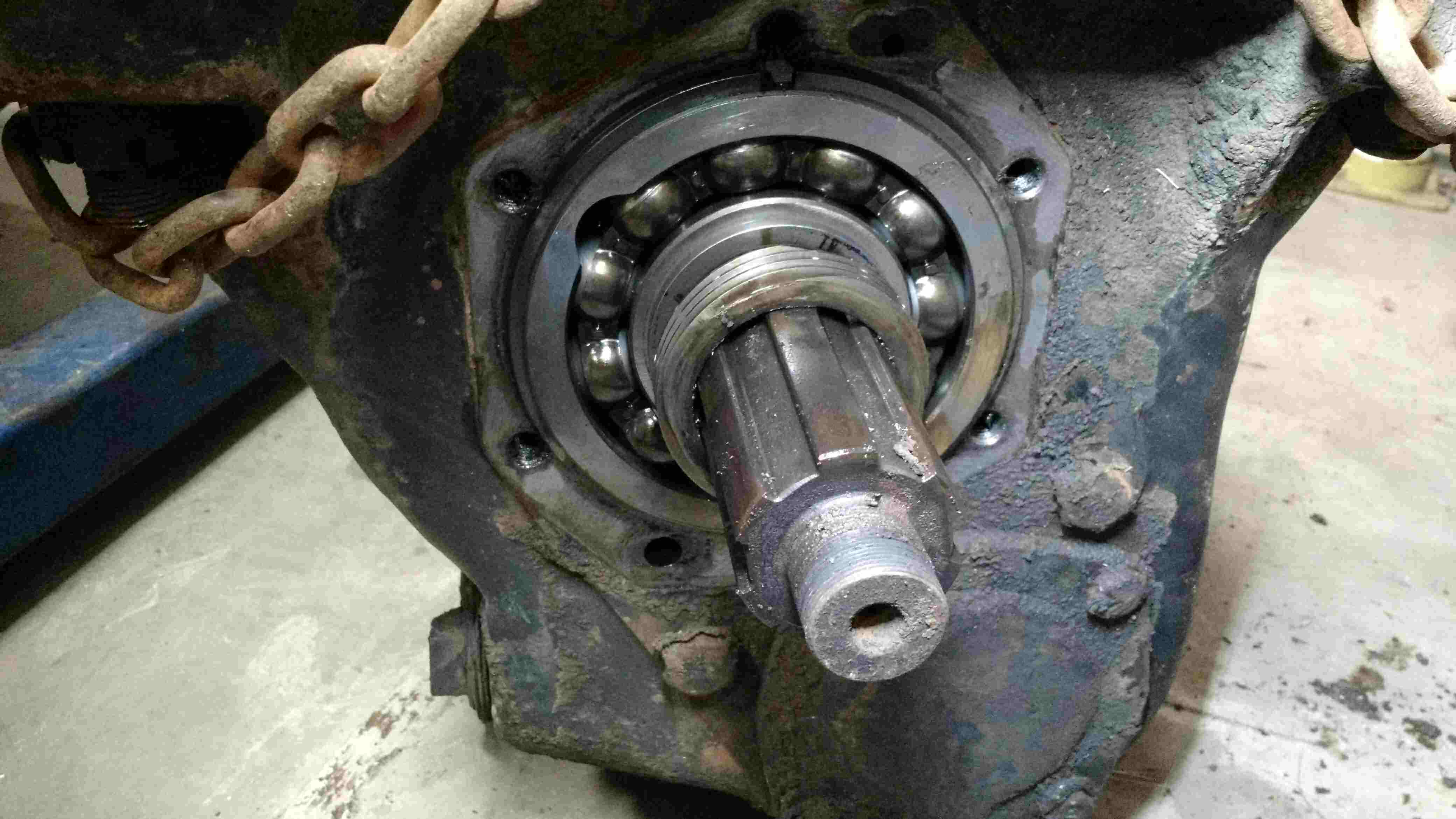

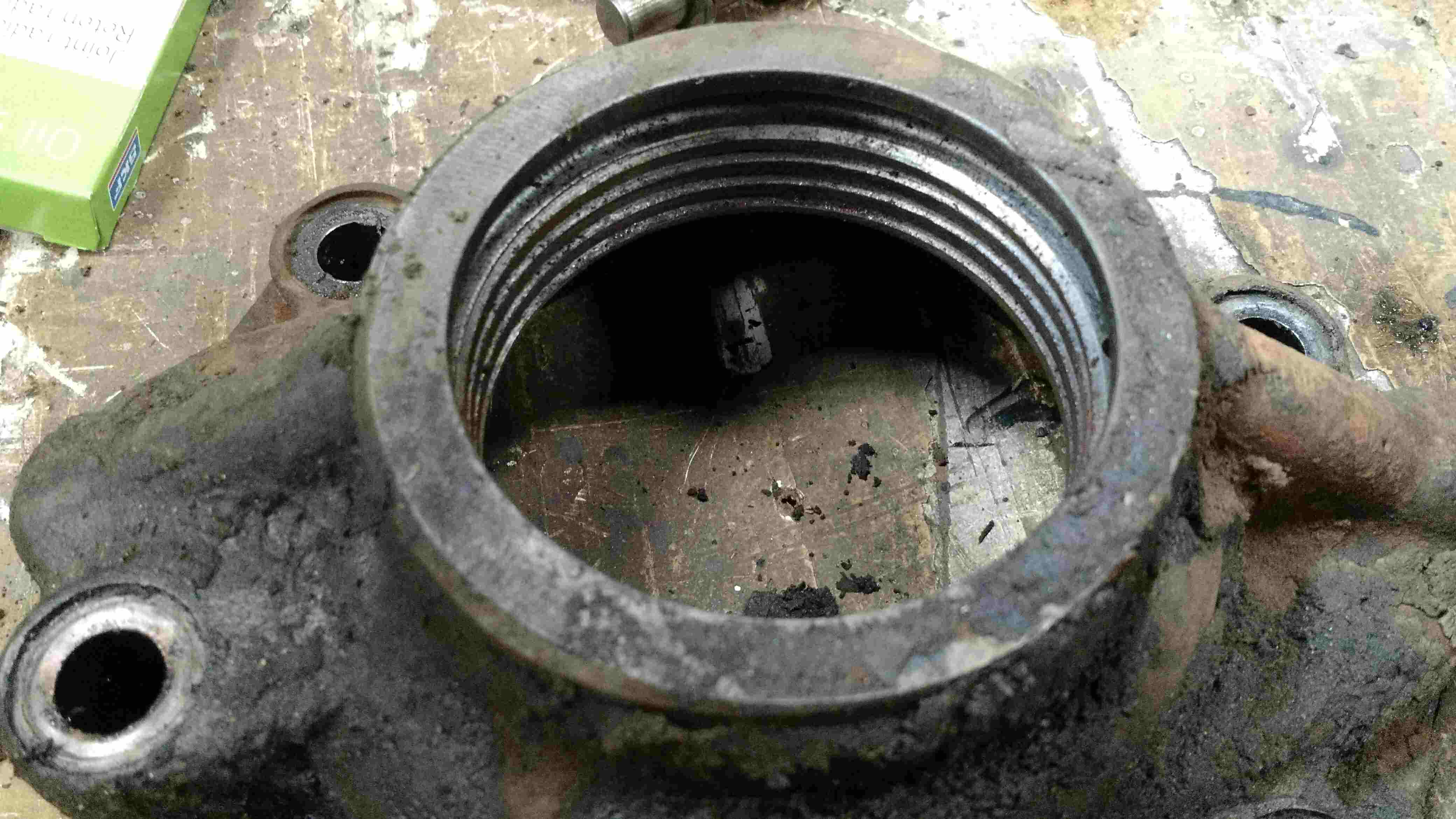

I'm swapping the Spicer 8341-c auxiliary transmission in my IH, and in the process I need to swap the rear driveshaft flange.  I figured I would replace the seal, but there doesn't appear to be one.  Is this possible?  I'm I missing something?  I included a picture of the back of the transmission with the speedo housing and flange removed, as well as pictures of the speedo housing and flange.  Thanks, Andy

  Look at bearing  caps and related parts. pages 6 & 7 show a seal, check numbers of unit against your to be sure. the C designation may be later

I had looked at that manual, and it shows the front and rear as using the same seal.  I got the number off the front seal and ordered two from NAPA, then I took the rear apart and couldn't find it.  I guess that manual shows a later version with a traditional seal.   Unfortunately, I don't work on stuff like this very often, so I just wanted to make sure I wasn't missing something.   Thanks, Andy
