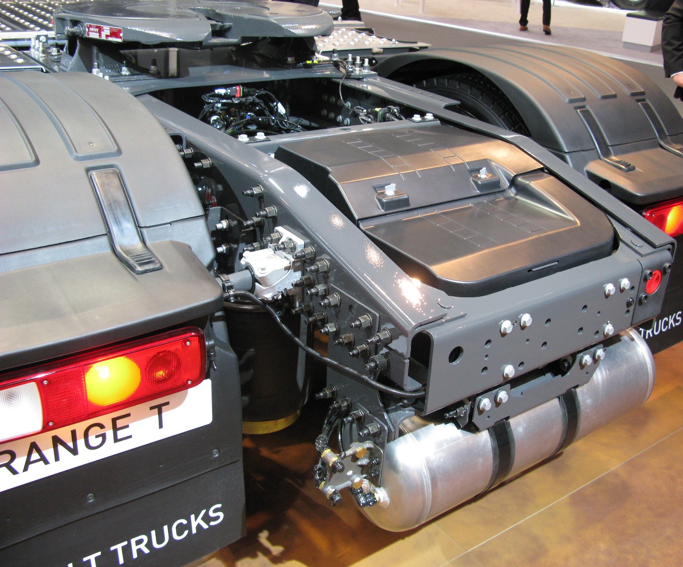

I've never liked the primitive way full fenders are mounted in North America, rigidly to the frame without any insulation at the frame mounting point. The every day road shock beats them to death. The fender supporting tubes should be mounted into frame mounts with rubber insulation within (e.g. picture below), or the tubes rigidly mounted to the chassis with rubber insulation at the fender mounting points, so as to allow a bit of "give".
