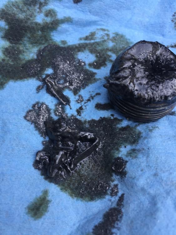

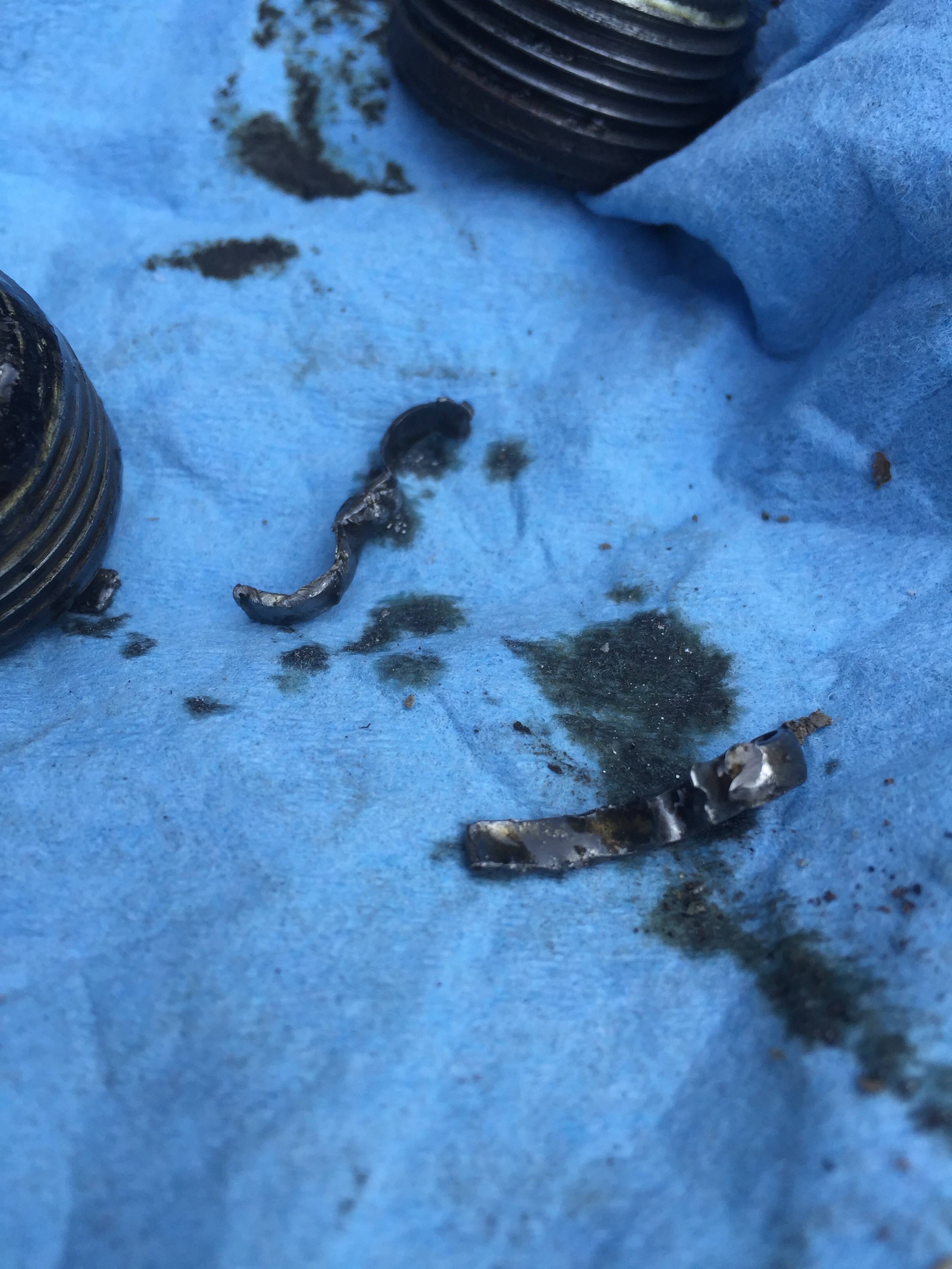

Anybody got any clue where these pieces came from? I thought maybe a bearing race but the shape and size of them doesn't seem to fit any bearing that would be in this tranny. These came out of a T310MLR
Yeah the tranny has a pro on it. I thought maybe it was part of the cage for a roller bearing but the 1/4" half loops with a pin in the centre didn't look right to me
Edited by brenner
No range shift issues or any noises from the trans. Hoping it came from the pto. If it is the bearing on the range shift would there be any play in the output shaft? Or would I be able to pull the top cover at the back of the trans and see it?
Edited by brenner
No the Out put shaft is supported by the Big  rear Case ball  bearing the range  pack hub is supported  off the tail shaft by the small ball bearing!
The rest are tapper roller.
That is really the only small ball bearing in the trans that I can think of. Hopefully Glenn is correct and its pto related!
