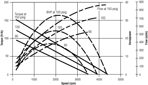

Hi Monty,
My starter is a Ingersoll Rand 150BMP 32hp
http://www.irtools.com/airstarters/vane_guide.aspx
Regards,
Rod.
http://www.cvisairstarters.com/airstarters...lrand/150bm.php
and click on "150BMP Performance Curve"
So from this, you can see that initial air pressure is very important.
