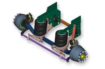

Lots of guys around here are now running "steerable" lift axles, which are similar to a front steer axle. This type has spring loaded shock absorbers on the tie rod to keep the wheels centered, but also allow the wheels to "steer" into the turn.
Here's a steerable lift axle:

Thad, It could depend on the axle weight that is legally allowed on the lift axle in the locality where the truck is operated.
If Bullhead is allowed 20k on the lift axle, that would probably be the reason he is running a "fixed" lift axle with dual wheels.
There are 20,000 lb capacity steerable lift axles available, but unless you would run flotation tires such as 425/65 R 22.5, single tires would not be rated for that weight.
Here in WI we're only allowed 10k on each lift axle, so steerables with 11R22.5 or Lo Profile 22.5's are more than adequate.
We've still got some older trucks with fixed lift axles in the fleet where I work now, but the new ones that we put together now are getting steerables.

I run 315 80 R22.5 on the steerable lift axle they are rated for 9,000 lbs. apiece legal in Penna. and New Jersey for 18,000 lbs. Some states are making steerable lift axles mandatory on new trucks. New York State is one. A friend of mine wanted to get R Permit for New York State and they would not let him as his truck is 2007 and has fixed lift axle on it. Joe D.
Hello everyone. Here's a couple answers. My truck tares in at 12,700kg (27,998 pounds) with half a tank of fuel (300 litres). It was a little lighter new, but I put a pintle plate and hitch on and have some thick conveyor belting on the inside of the tailgate. That Beau-Roc Diamond Line box is 900 pounds lighter than a post style box, but I will never buy another Beau-Roc. Lots of problems like all the welds breaking (after 3 months of hauling asphalt, legal loads) and they wouldn't stand behind their warranty. Said it was driver abuse :angry: I am legal to gross 35,700kg (78,704 pounds), so I usually carry 22 to 23 metric tonnes. Our weight laws in Ontario require you to have 101" from the steer to the lift. And wide axle spacings on the drives. I can gain a ton by going to a 72" axle spread, but don't feel it justifies the added tire scrub and wear and tear to the truck. You definately have to lift the axle for tight corners (they want us to run 90 psi. in them, I don't). And I leave it up off road most of the time. HK Trucking is right, most steerables reqire super singles which would knock one tonne off my legal payload. Plus the added cost to buy, so most of us just lift. I never have any odd tire wear, so they aren't too bad. I did price a Granite with that Simard air ride twin steer front end and they were about $20,000 compared to about $7000.00 for a lift. They are a nice set up though, especially the air ride ones, because you can dump the pressure in the second axle to get better traction when stuck. If guys would get the rates up we could afford to buy that nice fancy stuff. The twin steers are real popular around the Ottawa, Quebec area. I'd like my next truck to be a Titan with that setup. I have some pics I'll try to get up in the gallery soon of a Granite at the Toronto show with the twin steer.
