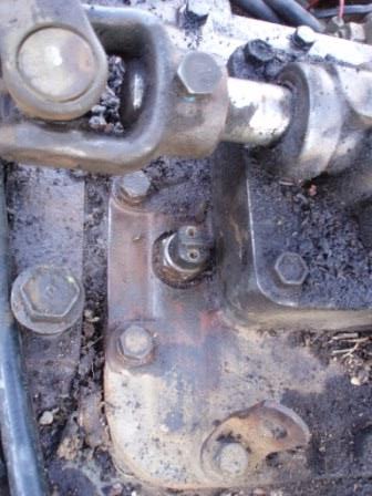

Bear with me, I am a logger and an experimental mechanic...but how is the reverse light wired? I have one mounted to the tower at the back of the truck, but there are no wires. And how does the transmission communicate that it is in R and signal the light to burn?

Could this be it? The little mushroom thing with two holes in it? And is wiring as simple as getting a replacement plug and then running one wire to power and one to the light?

Yes that would be it, it looks to me that if just put 2 screws in it and use that as your switching point to the light you'll have it. If you dig around your frame near that point you may find the 2 wires "dangling" that belong to that switch.

Okay. Thanks.
