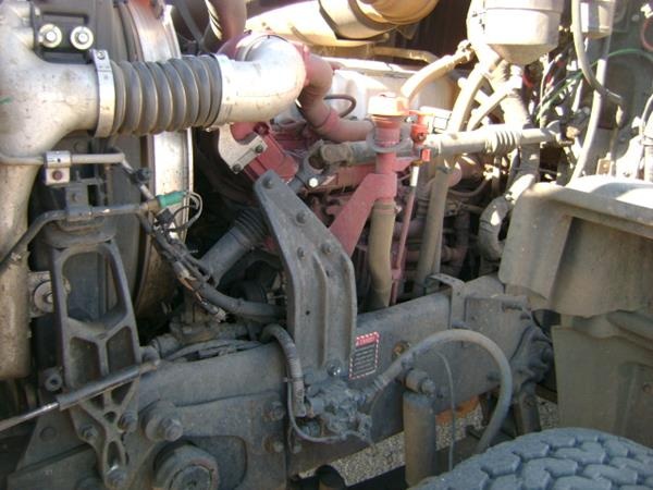

The only thing I can say is make sure it burns the DEF. They started using it in 10 sometime. The MP8 motors seem to be doing alright but there are some issues with truck components. If possible get a horton air engage engine fan clutch. The 08 to 10 with the DPF and no DEF will cost you a fortune to keep on the road especially if in severe duty service. The camelback suspension with the greasable brass trunnion is also something to stay away from. They went back to the rubber trunnion sometime in 11. Another Volvo deal where there was nothing wrong with their design, so they say, but then went back to old style that works.

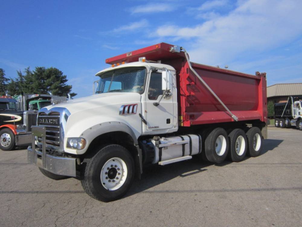

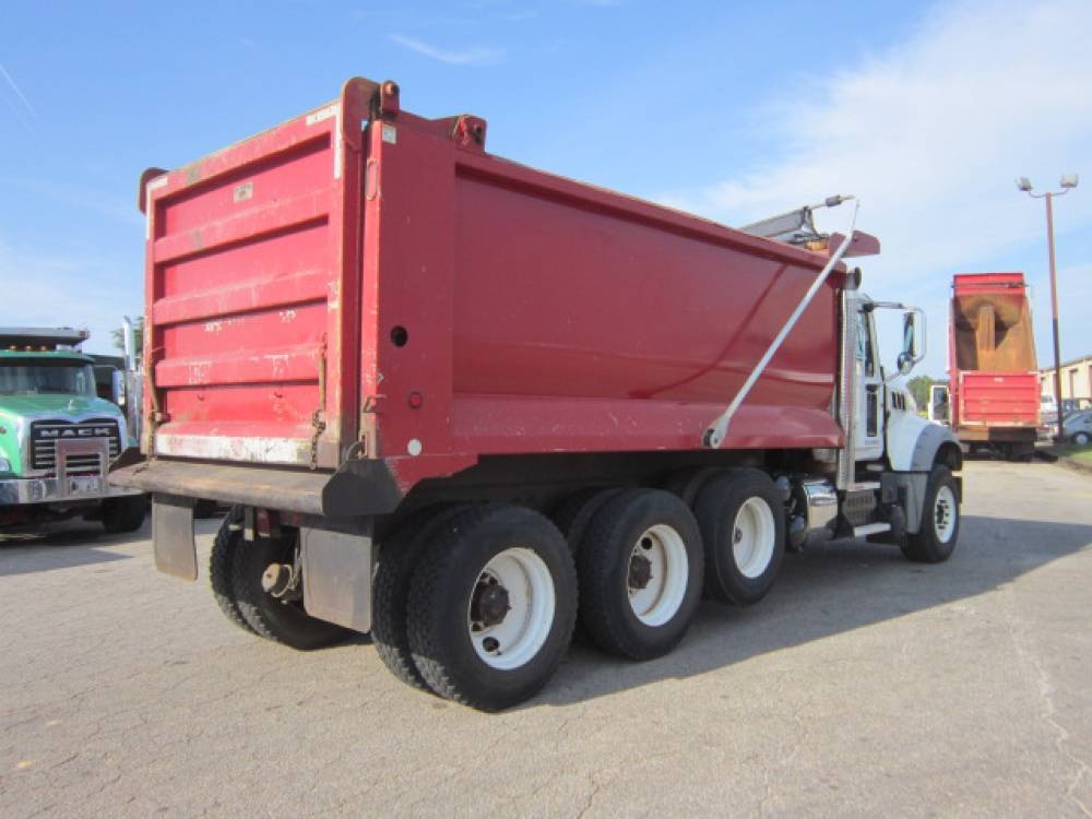

Does this sound good? 2012 Mack GU713 --- Tri Axle, MP7 Mack 405 HP, Allison Automatic, 4.50 Ratio, 18,000 Front Axle, 46,000 Rear Axle, 222" Wheelbase, 20' 7" Bridge, Camelback, Thick Frame, 2 Stage Engine Brake, Air Brake, Differential Lock, 16' HARDOX STEEL OX Dump Body, 60" Sides, High Lift Gate, Air Gate, Electric Tarp, Steel Front Wheels, Single Stack, Aluminum Fuel Tank, Daylite Doors, Peep Window, Air Ride Cab, High Level Interior, Chrome Gauge Package, Heated Mirrors, Cruise Control, Tilt & Telescopic Steering Wheel, AM/FM CD, P/S, AC. Price is $139k

its not bad but u can probably get a new 2014 granite with your spec and automatic for 30k more with a new truck waranty, ur color,
This one comes with 150k mile warranty on #7 injector and 500k mile warranty on all major components.
Do you think I should wait a few more months of running and go new? What type of warranty comes on new truck?
