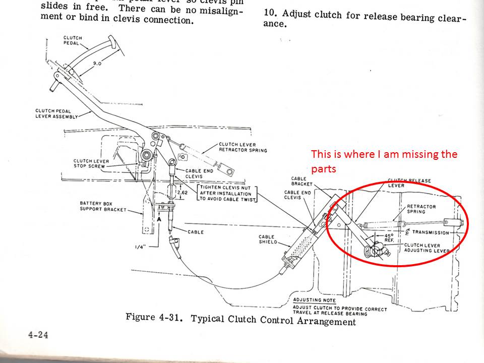

Looking for pics or parts pages for my 1980 R model

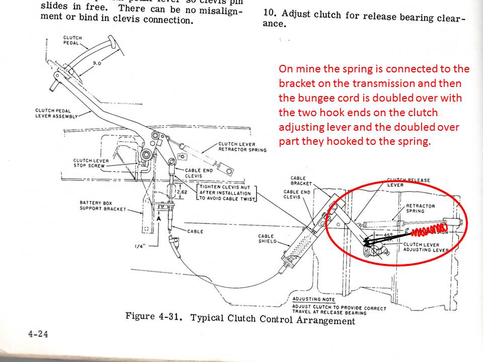

Just doing some TLC today and I think I am missing parts on the clutch linkage as it has a spring and a bungy cord hooked to it and the throttle cable for fast idle is zip tied to the rod and the spring is hooked to a oil line.
One of the previous owners must of had some good rigging skills as it was not obvously noticable and I drove over 140 miles without issue and by looking at some of the other fixes who ever it was could fix just about anything with bungy cords

mine is a little different set up than that one, my clutch cable goes through the upper fire wall down to clutch release lever
post-10018-0-00004800-1368019622_thumb.j
This is what mine looks like, I think there is enough to see what part I am missing
post-10018-0-35846500-1368019635_thumb.j
I scanned a bunch of online auction site pictures and came up with the peice for the throttle control and made one, the spring hooked to a little bracket on the compressor, when I started looking I found it, the hole that hold the spring was broken so I took it off and made one.
