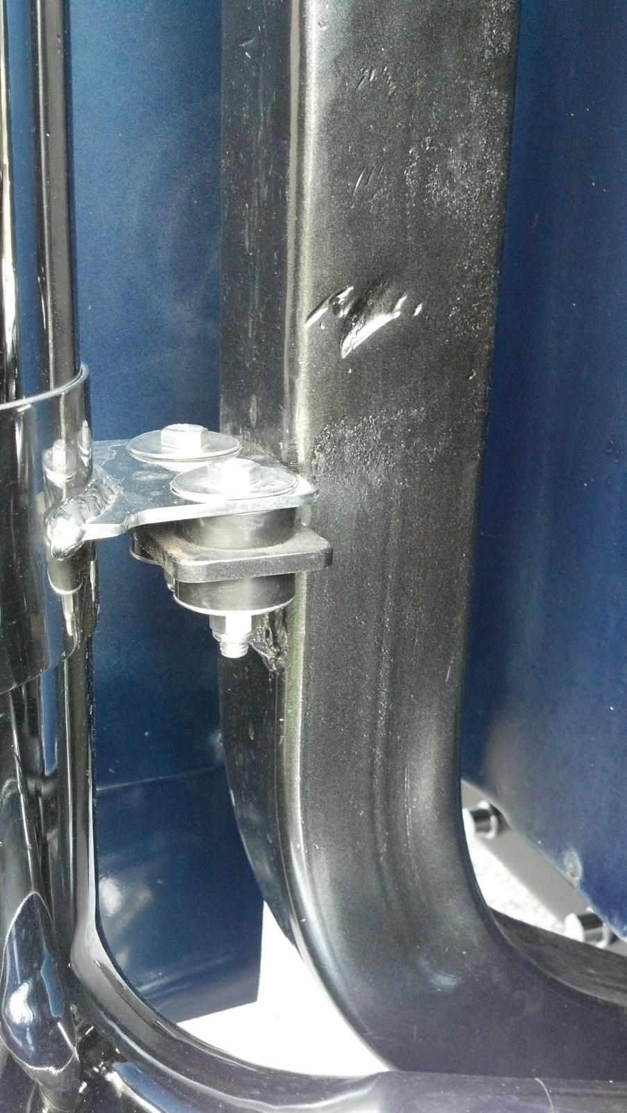

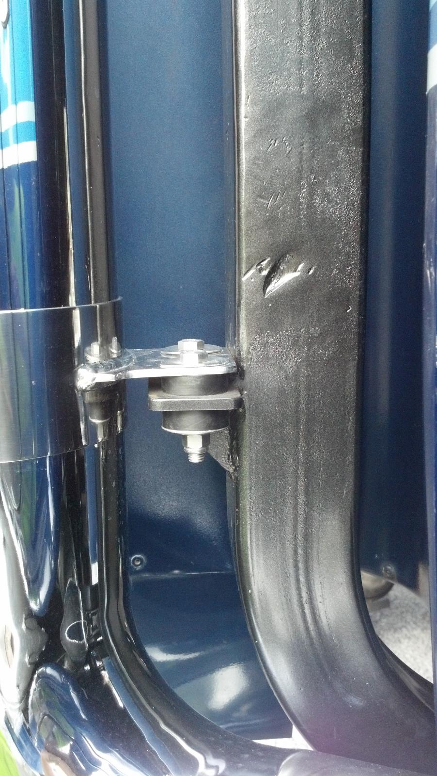

I like it, I bet it talks to you with that little pipe and the turnout so near the cab, I agree on the rubber I used United Pacific rubber bushings for peterbilt exhaust to do mine they work great for one piece over another and help support the weight of the stack, I dont know about that design might need some more engineering to make it last for ya.
Heres the pics I got of my exhaust mount, it works pretty good so far, I cut the factory mounts off the hangers and welded what you see on to mate with the mounting clamps.
post-5240-0-23945300-1353463349_thumb.jp
post-5240-0-24067700-1353463386_thumb.jp
