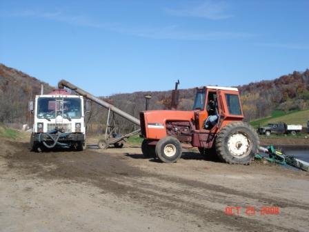

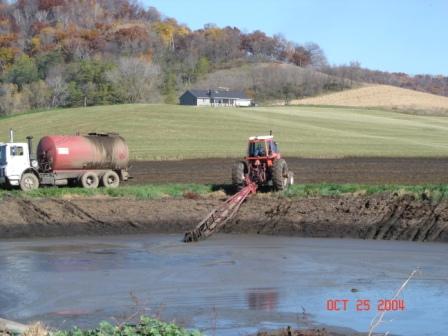

1st picture is us loading manure, the second picture is us stirring manure (for those of you not familiar, a 50 foot aparatus with a big boat prop) churns a lot of sh$% but takes a lot of HP!!

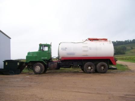

I have a dmm 6x6. It has a 237 5 speed trans. and tc150 transfer case.
Here's my dilema, I pump cow manure and never have reliable HP (tractor), most of my farmers' tractors are underpowered, They overheat because of the severe duty i put them under, and the fact that most farmers only use a fraction of their horsepower, so their radiators and air filters are plugged, I show up with my agi/pump (which will bring a 200 hp tractor to it's knee's) and after 15 minutes of agitation or loading we are stalled because of an overheated tractor. I have rented in the past from a local Allis Chalmers salvage yard, but once again i'm using junk, and i'm broke down. so a reliable tractor is my current weak link.
My Idea is to take my 6x6 (about a 77, with a weaping head gasket, which I will fix) shorten the wheel base as short as possible (for manueverability) Hook a drive shaft to the PTO output of the transfer case run a driveshaft to the back of the truck into 2 90 degree gearboxes, ( with an overall gear reduction of about 2 to 1) build a hitch comparable to a tractor, run a small hydraulic pump out the front (alrady has crank shaft adapter and bracket in place) for hydraulic needs, walla a mack Tractor "Macktor".
I will run the the transmission in 5th so my driveline from the truck will run at engine speed. I need about 1000 rpm at my pto shaft but turning the oposite as what comes out of the transmission, with the 2 90 degree gearboxes I can make the direction change... I know that overheating the transmission and transfer case will probably be a problem, I can run coolers on both with circulating pumps.
WHat I need from someone here is a source for the PTO Adapter for the back of the MACK TC 150 transfer case. ANy help or insite would be appreciated!! :SMOKIE-LFT::SMOKIE-LFT:
