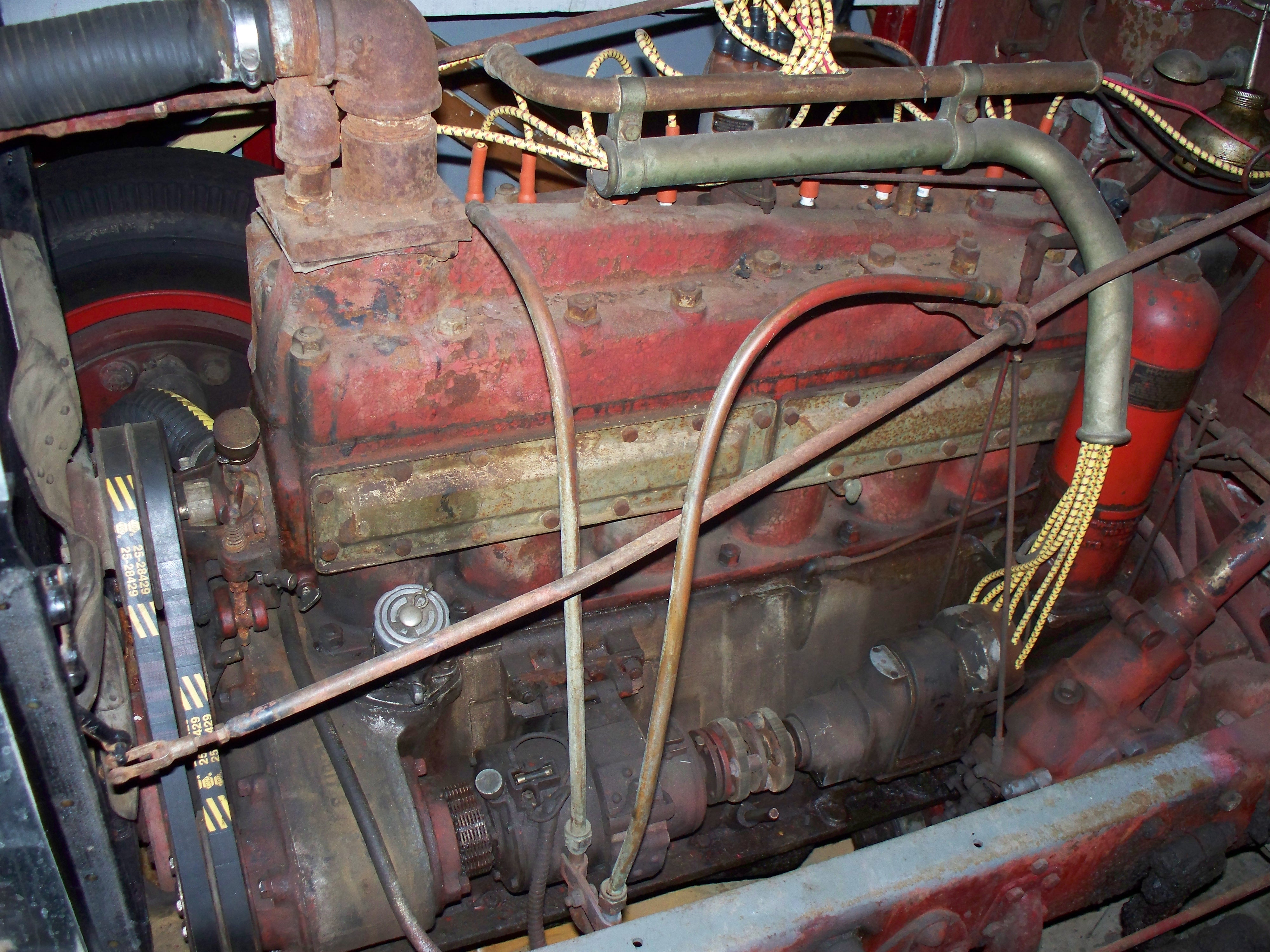

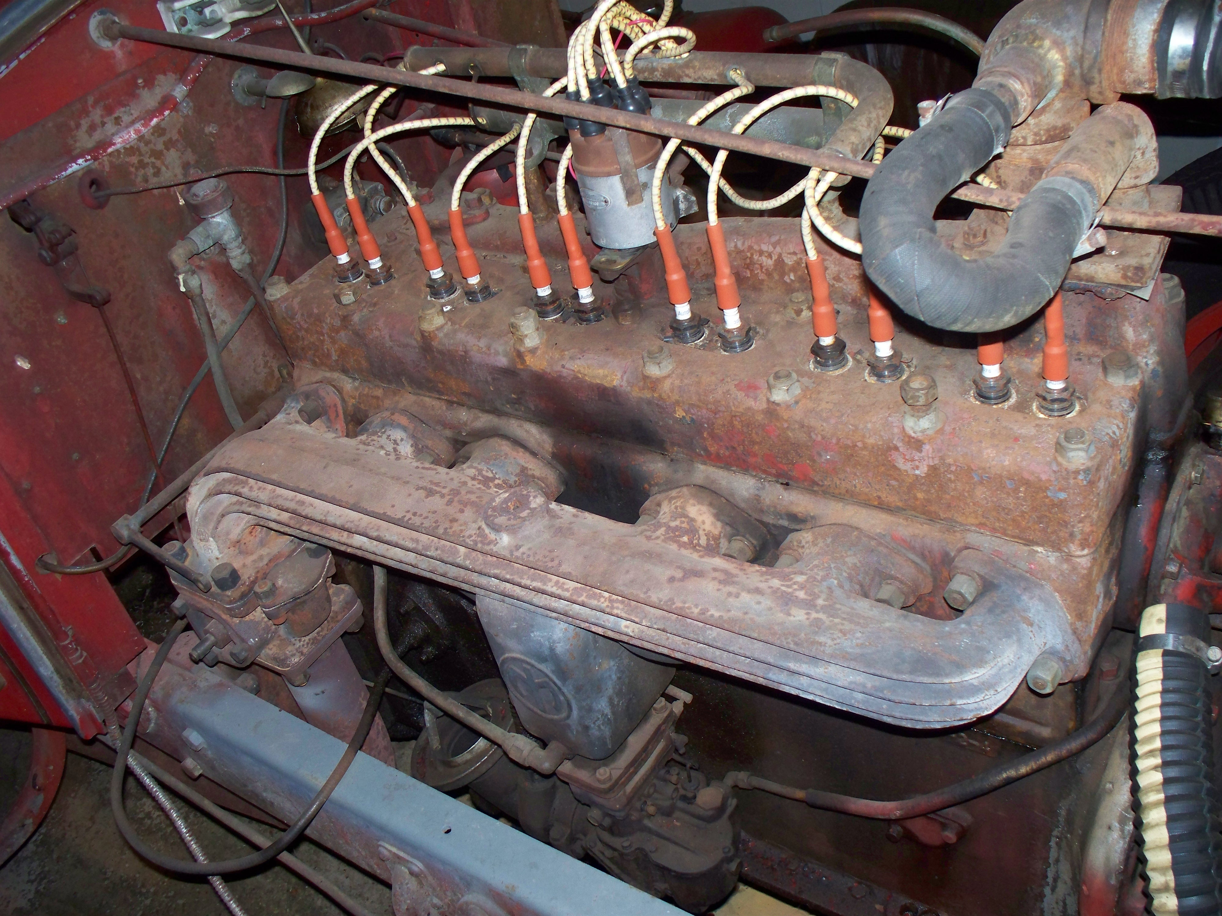

Note the non-original upper radiator hose manifold... Looking for an original one of those... Thoughts?
That manifold and hoses were for additional cooling if needed while on long pumping calls. The engines were ran at a higher speed to pump and if they got too warm then you could open a valve and it would circulate the cooler tank or hydrant water through the engine. You could just pull off the hoses and pipe nipples and put plugs in.
Because raw water runs through these from the pump these are notorious for freezing and cracking. If you retain tham make sure they are drained by blowing compressed air through the lines. Most owners block the lines off under the rig to prevent an unwanted freeze.

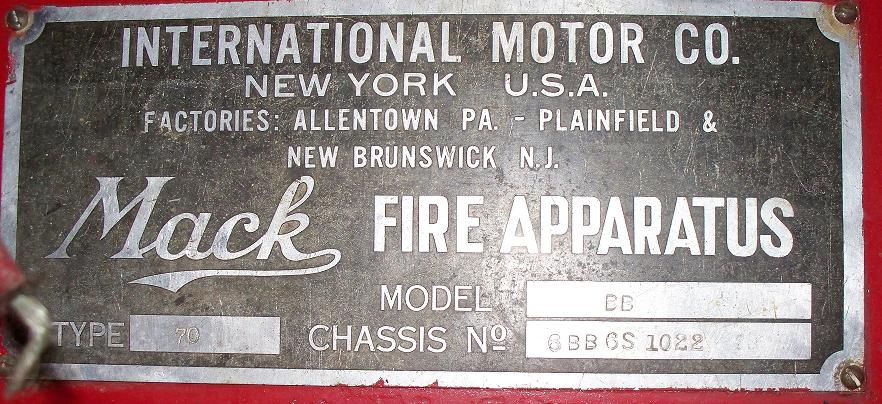

I'm now looking for a factory identification plate. Seems your truck has that one still on the dash.
Will make that engine pics for you of course.
My truck is complete for the most part so I didn't have to source any major parts.
I don't have a plate, but I think it is held on with screws, and could possibly remove it and scan or photograph it if nessesary.
