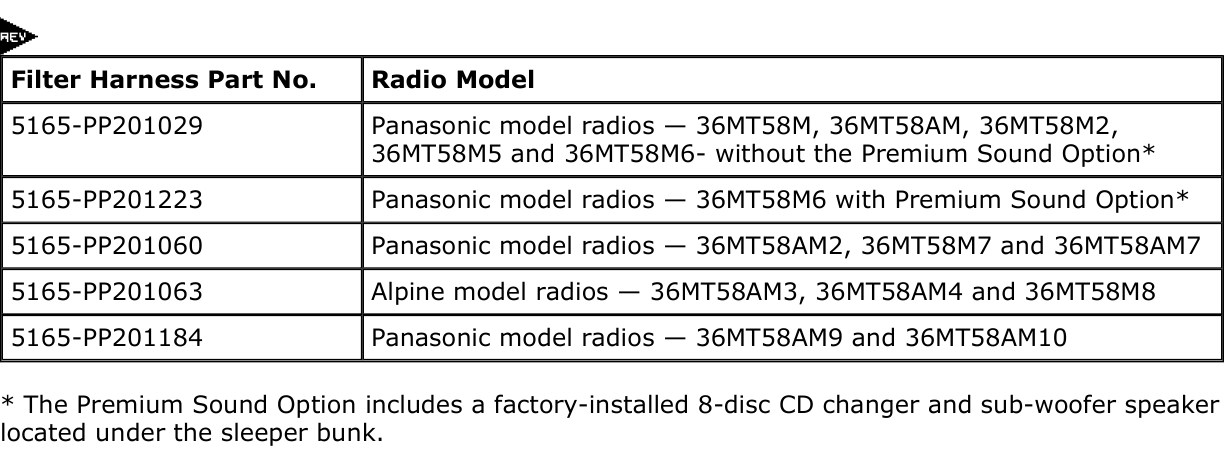

The noise on the AM band may be caused by interference caused by the EUPs, dash dimmer switch, heated mirrors, etc. If this is the case there is a ground strap and noise filter kit available from Mack, installation is outlined in SB742-002. Part number for the kit depends on the radio. The Service Bulletin was issued in 2001, so I would assume your truck already has the kit installed from the factory, but it may not.

Yeah, that's exactly how the problem is described in the bulletin, noise/static increasing with engine speed. I think it's supposed to take about 30 minutes to install with the dash mounted stereo.
The kit number appears to depend on the part number of the radio installed. If it's the factory radio it should have a part number on it. Here's the list of radios and the ground strap/filter part numbers:

I screwed up, the number for the ground cable for all of the radios was part No. 5165-PP201118 (thought it was listed on the chart). There is nothing listed for Sony, but one of the noise filters might fit, I'm not sure though. Might be be able to get something compatible from a radio shop too, sounds like it's probably just a diode or a resistor wired inline from the power supply and a wire to the ground cable that would be attached to the back of the radio.
