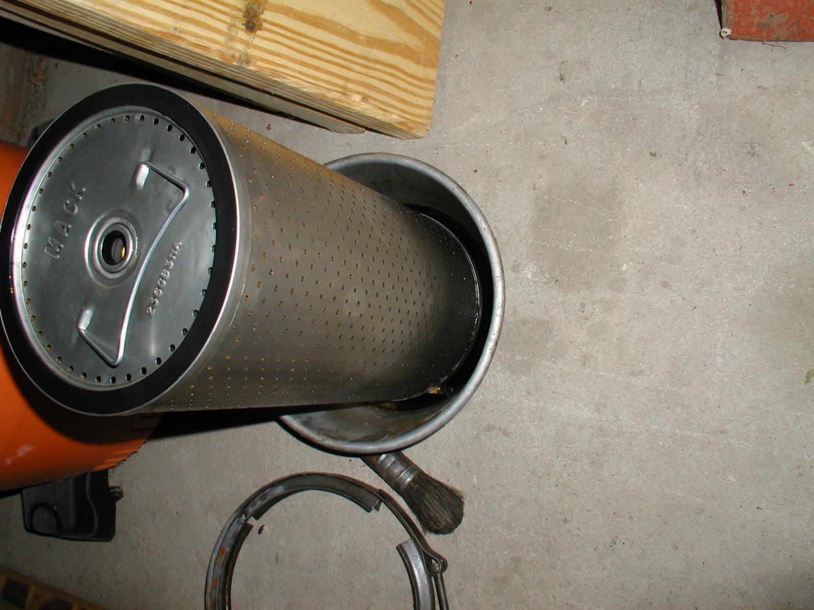

  3. I found a Baldwin P 706 M at T.H.E. Company in Mt Pleasant Iowa, about 30 miles from home. They had eight of them in stock. No local companies had anything in stock and would had to order. Its already installed and as soon as the weather cools off I will fire it up to check for leaks, this evening probably. Will drive the B to Hamilton IL for display this Friday thru Sunday. Thanks all for the very good information. Victor

  6. The small one that truck repair provided was the second one they ordered, I might take it back and see if they want to try the third time. I was planning on taking it to the western Illinois Threshers next Thusday, friday and Sunday and time is running short.
  7. Yes, they changed the oil, replaced the pan and valve cover gaskets but came up with a small cartridge. Vince handled this.
  8. I need to find a replacement oil filter cartridge for my 58 B 61 with the 711 engine. I have tried all the local parts stores and no luck. Its the large one approx 7 1/2 by 15 inches. Any advice would sure be appreciated. thanks
