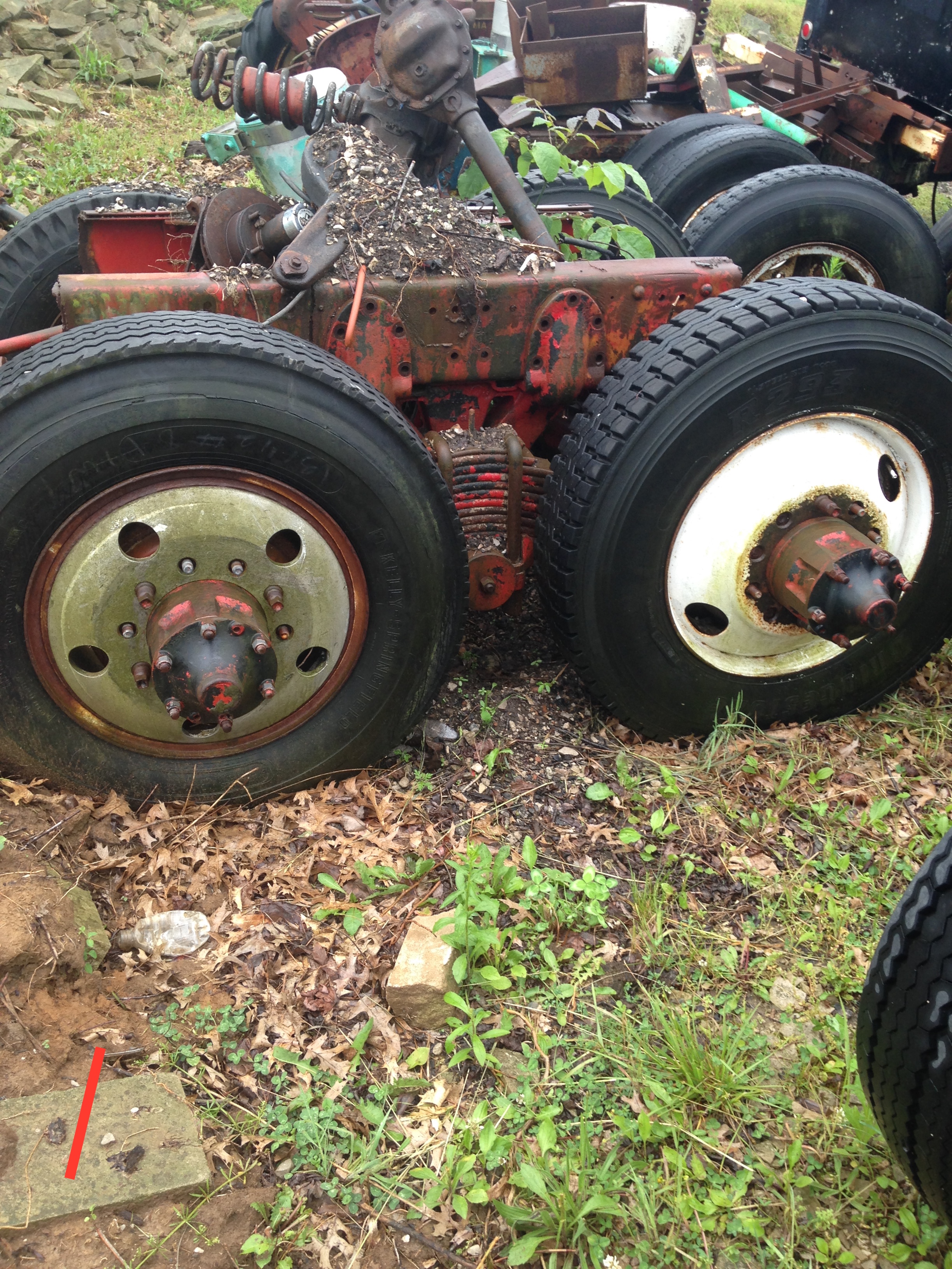

For sale budd hubs and brake drums for a 44,000 lbs. rear axle. If interested PM me here, I will get a hold of you. $100.00 dollars.I have the hubs off and ready to be picked up, saved the wheel bearings also. Need to make room for new building. Fred p.s. 5 hole budd not for sale, It's just holding it up for now.

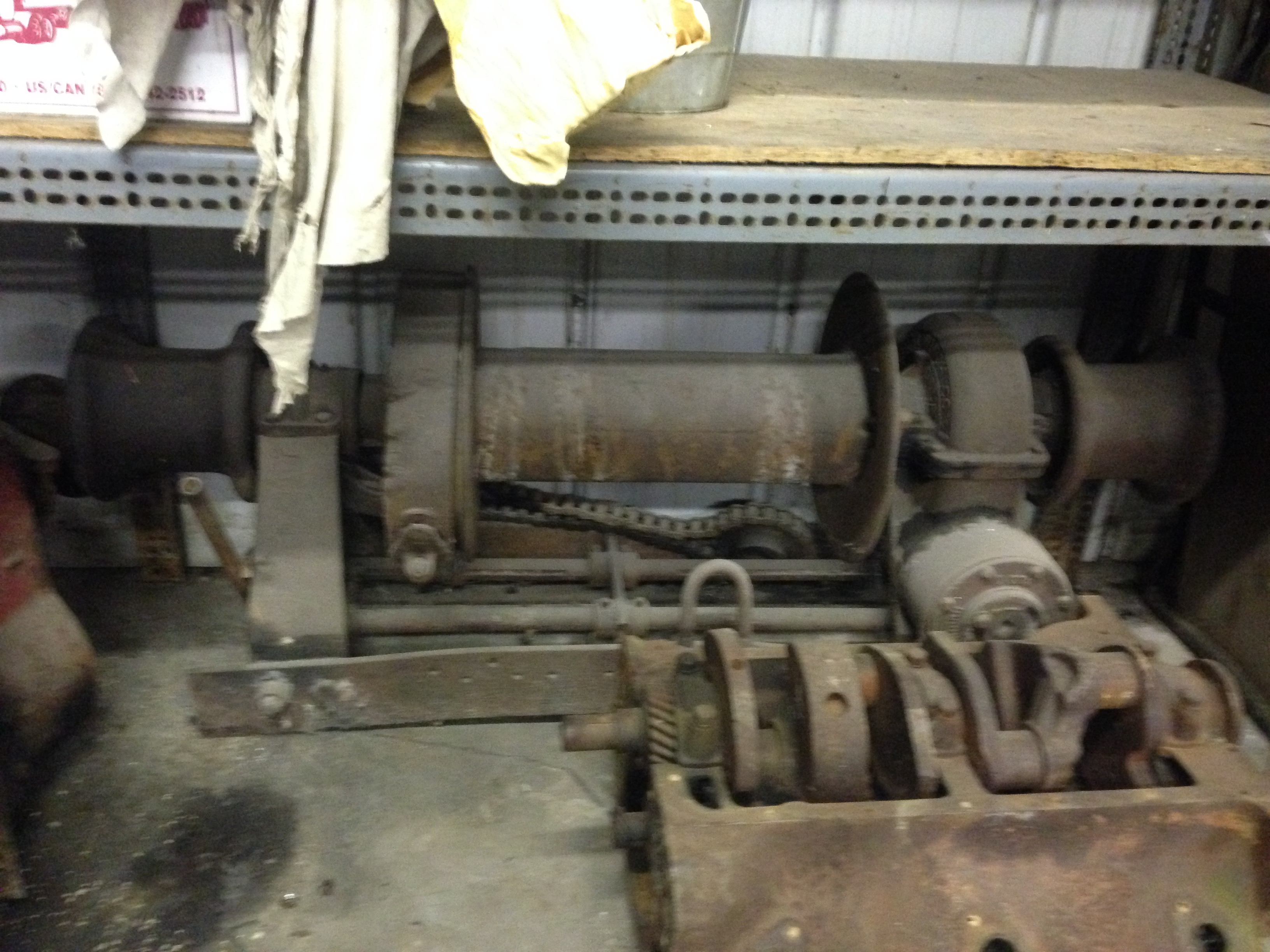

I have a Tulsa Winch that I have no idea the size or capacity. I know its not a super large one I think its around 25,000 # but I have no idea. Condition is really unknown but appears all there. If you want pictures pm me. or numbers off the thing tell me what you need to know. $500 Fred
I have a cut-off from b61, I believe it to be a 44,000 pound unit. The axles are the two piece design. Has low gears in the 6.50 range. If you are looking for hubs to convert to budd wheels here it is. $750.00 pm me here Fred

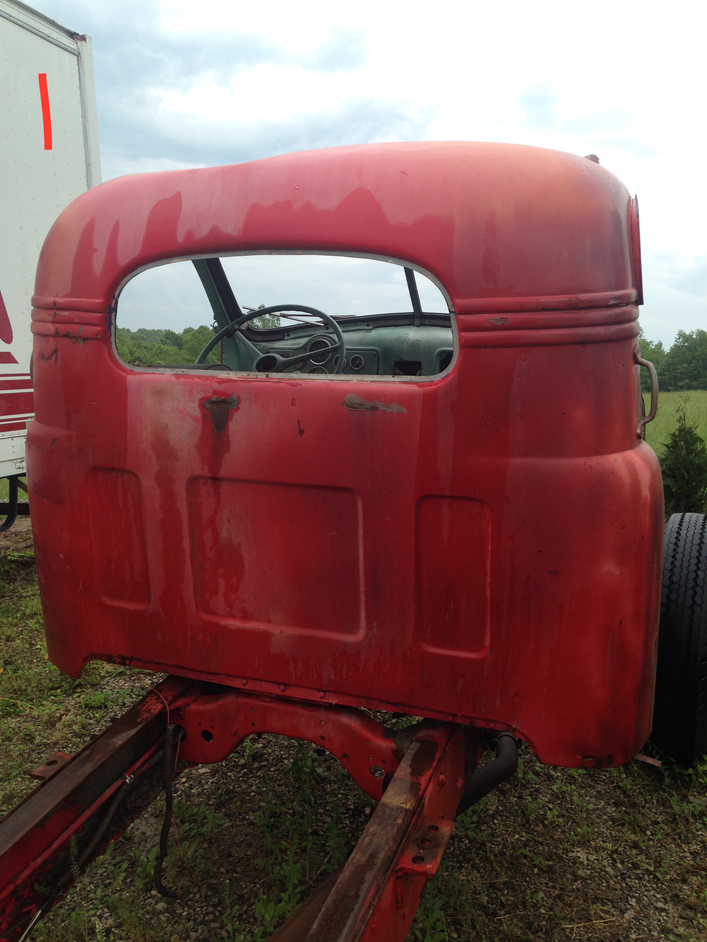

I have a spare cab that is from a b61 mixer truck. It's from a diesel truck and has a few interior nick nacks left. No doors and roof is beat up, but otherwise no rust some cracks in floor where seat is bolted. Will provide pictures if any interest pm me ask for Fred $1000 or best offer

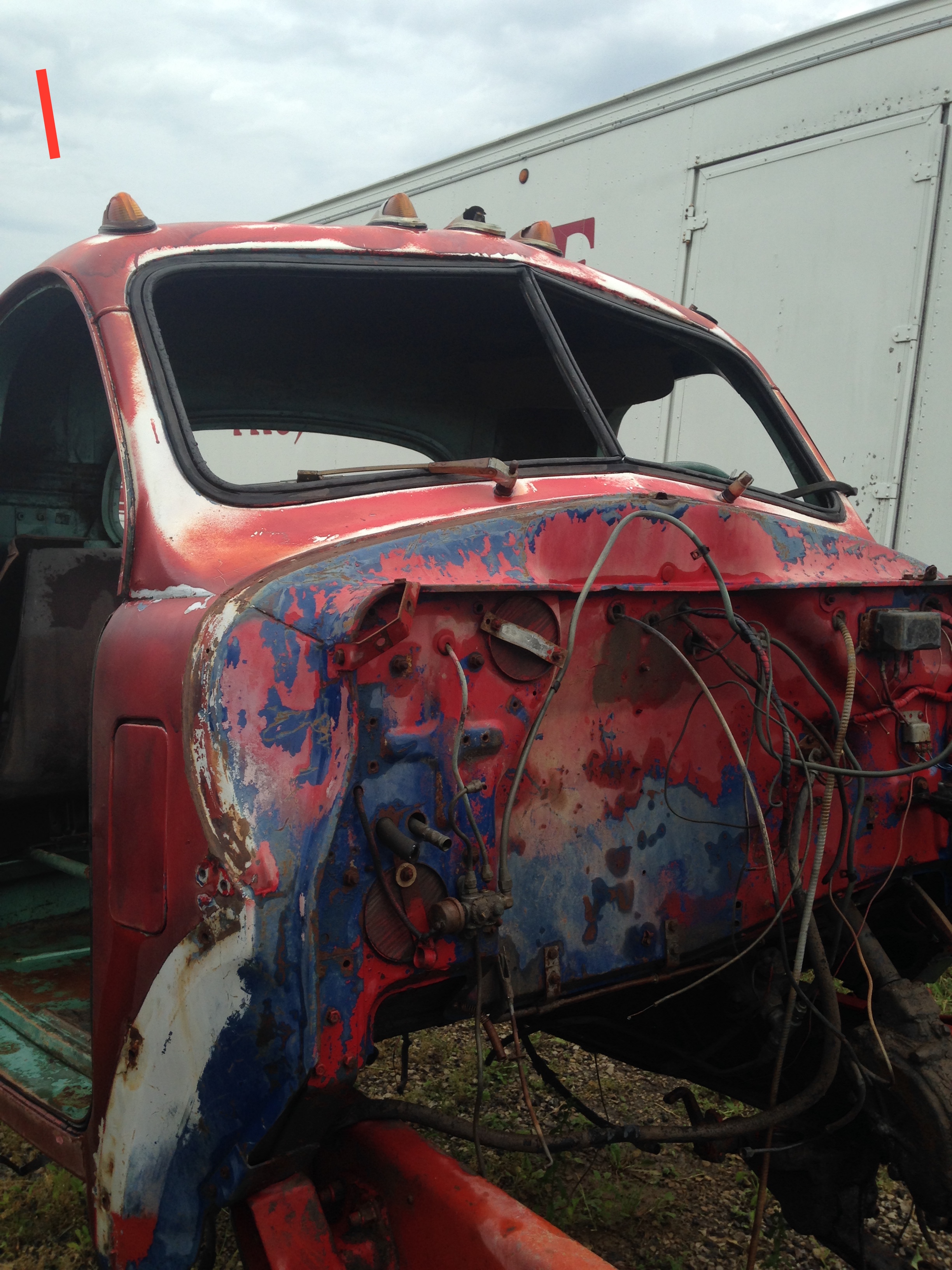

I have a spare cab that I am wanting to sell. No rust but lots of dents and the like. Has a "sunken" floor so it is for a B70 or B80 series truck. It is the B style cab. Pictures available on request if any interest. Cab shell only no doors, or glass. Any interior stuff left inside is bonus for you. $300. ask for Fred pm me if interested
