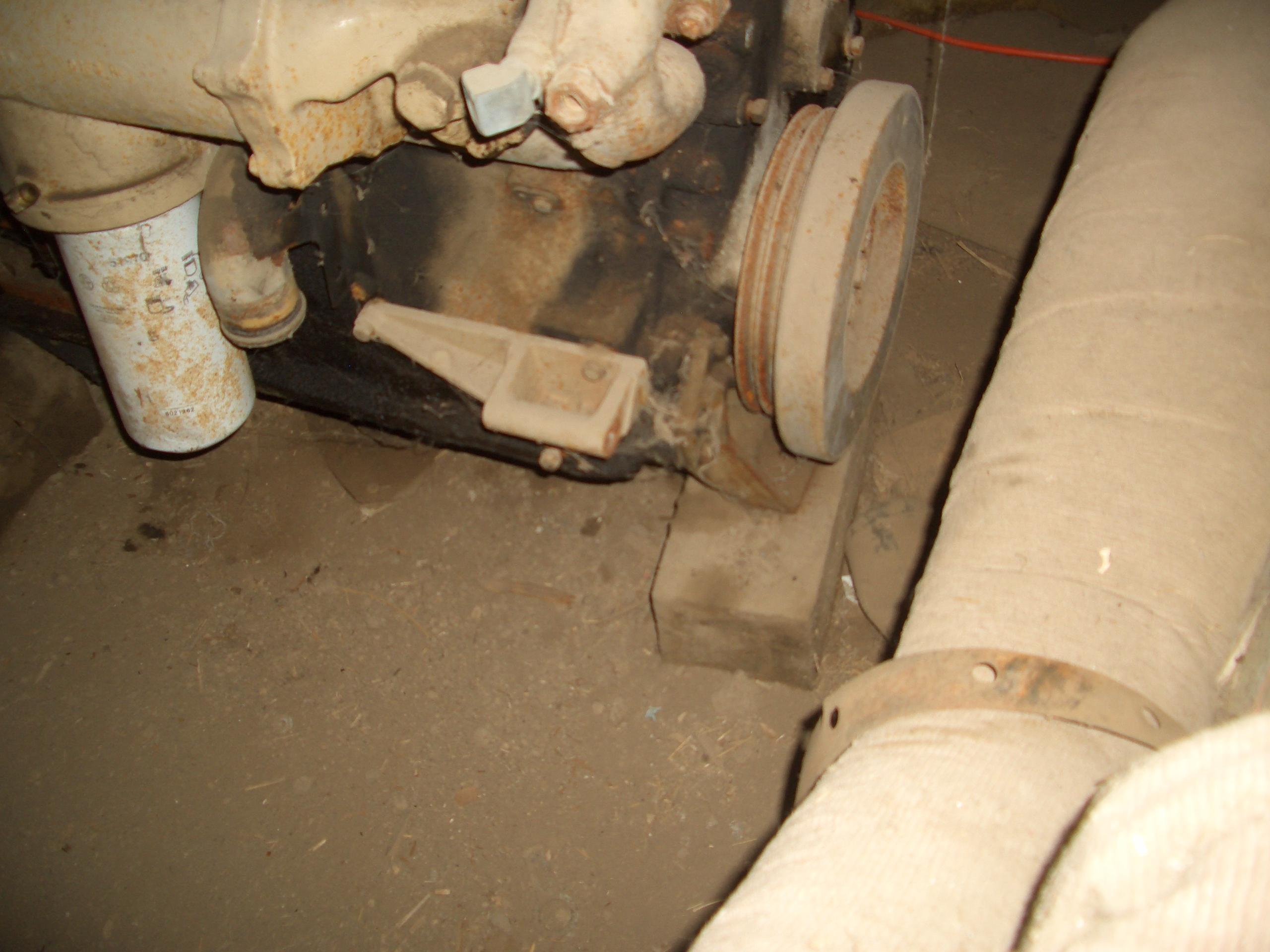

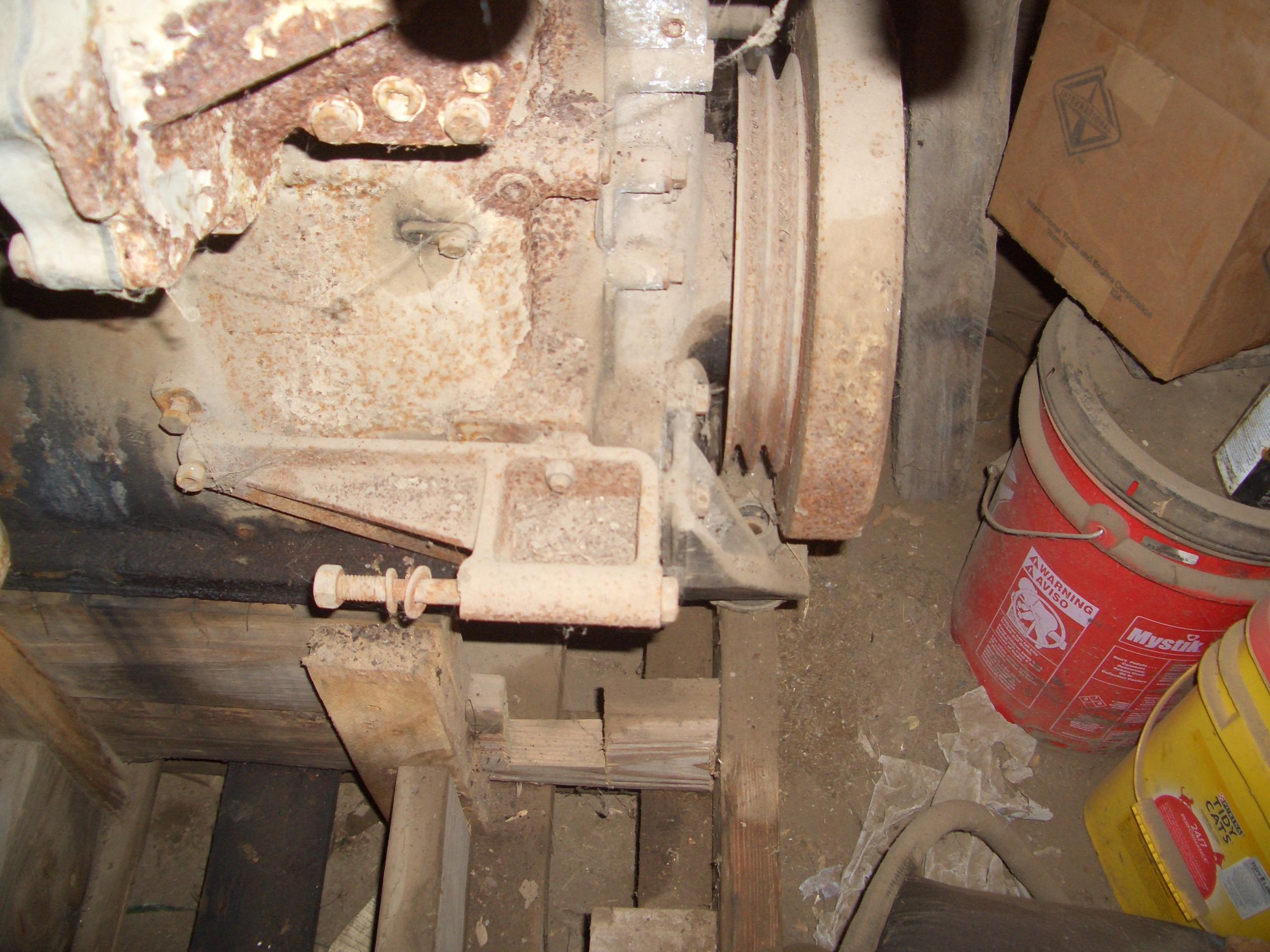

  5. I might have a Big Cam alternator mount. what does your big cam have on the front of the engine. Big Cam 3 should have duel belt sheeves behind the damper for alternator drive. am I mixing you up with another guy who has a Big Cam 3 and you have an old Cummins?

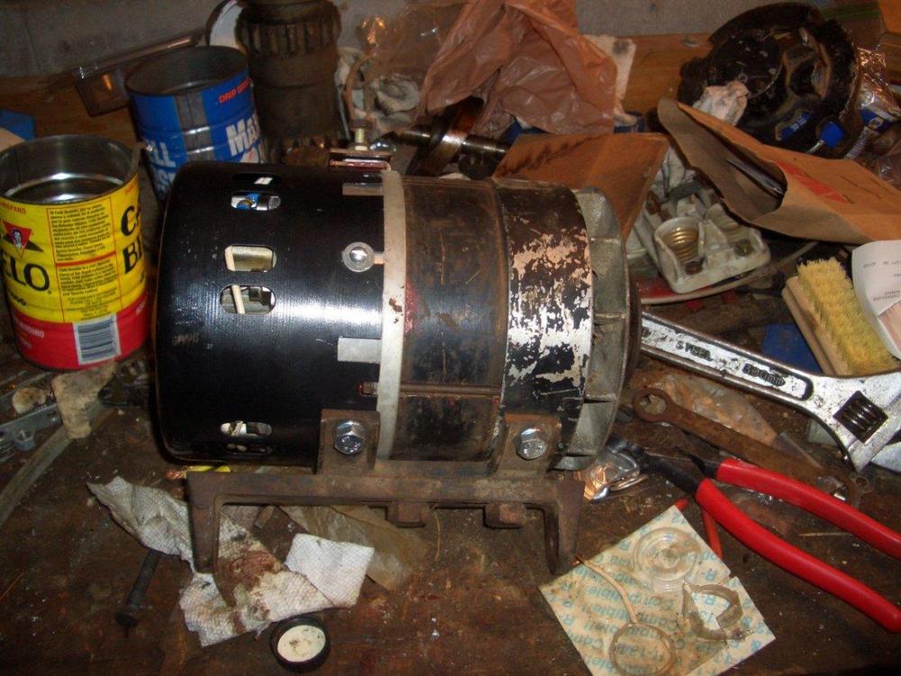

  13. Let us know how it turns out. I will freely admit I have more to learn on motors and how the current flows in them. simple 2 pole generators or motors it really only can have one flow path. I am less sure when it comes to 4 pole esp with how the windings are on the armature.

  15. That light gauge wire is enough to balance any slight difference in the current through the paired coil path, but I don't think it is heavy enough to carry a full 1/2 of the current draw of the starter. Yes, mine have that wire also. I don't remember what gauge it is, something like 14 or maybe 12 at the most. Like I said, I don't know what is going with those coils, they are NOT the same as the stock set-up. I am just guessing here, but I wonder if for 12 volt they ran all the coils in series, but in that case there should be a large conductor tying the two "hot" brushes together, the same size as the series coil stock itself. That little wire can not carry that kind of current. All I can tell you for sure, is that is not how the stock motor is set-up. If you can, bolt the pan back up and run it for a few hours to flush more gunk out of the block, use RTV or the old gasket so you don't waste a new gasket until the final time the pan goes up. I was surprised by how much more stuff came out after the 1st cleaning.
