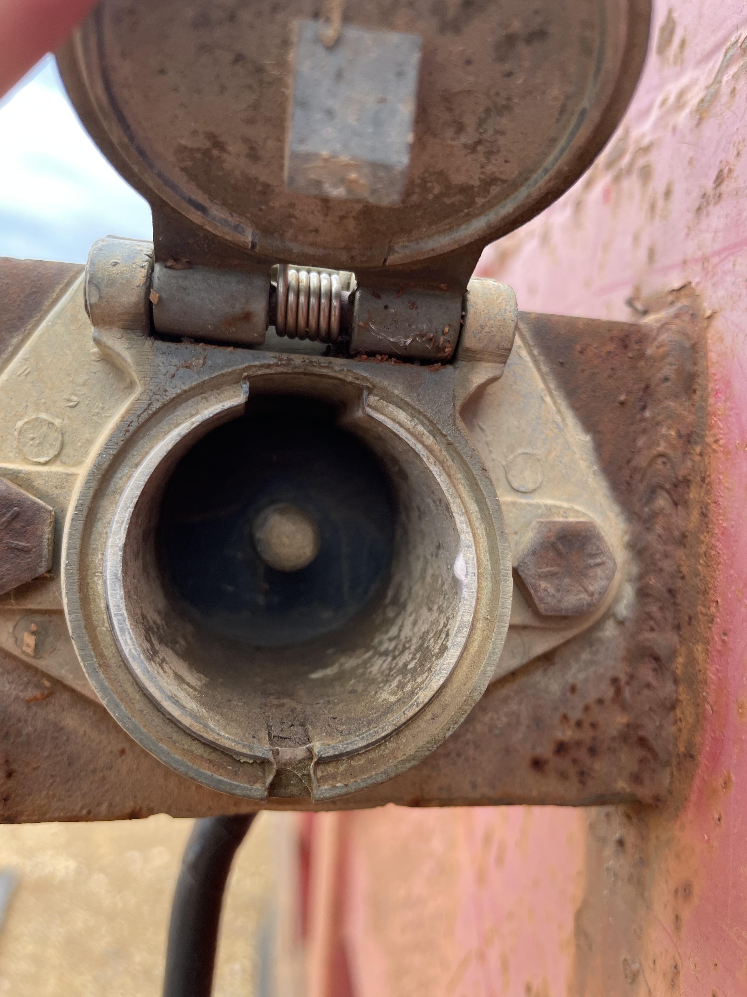

This is the trailer plug on my dumptruck
Ricky Beals replied to Ricky Beals's topic in Electrical, Electronics and Lighting
Ok thanks guys for the input. I’m going take it off. -
