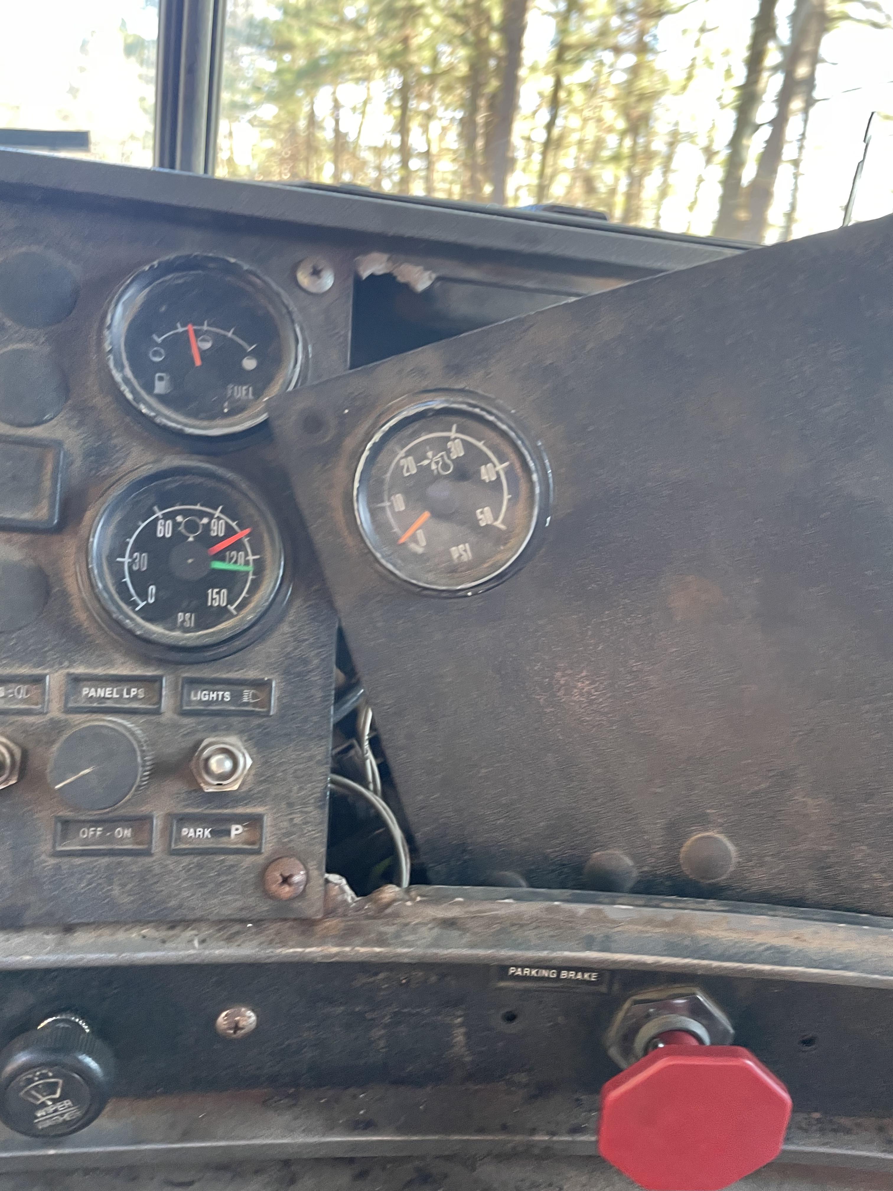

	When bringing the 2000 rd688 home yesterday I was watching the air gauge and the red and green would peg 120. The green would stay at 120 but the red would move down to 100 then bounce back to 120 just to start back down to 100. when shutting truck off I can hear a lot of air coming out of the ac vent in middle of truck. Any idea where this is coming from and how to access it? Thanks Ricky
	Posted a new photo in the original post with new question. Trying to see if the single psi gauge came standard on this truck or if it was an add on. It hasn’t moved showing any air so not sure what it’s for. this may be a boost gauge. I read where it doesn’t show boost unless there is a load on truck so may be why I have seen it move.
	Good call Mark that turned the light off. I’m guessing when this light comes on you need to respect it and find the problem. second problem!! Did this gauge come with truck or was it an add on. It’s a psi gauge but not working or i have yet seen gauge move? its not letting me add the photo and same phone I took the first photo with. I may have to start another thread
