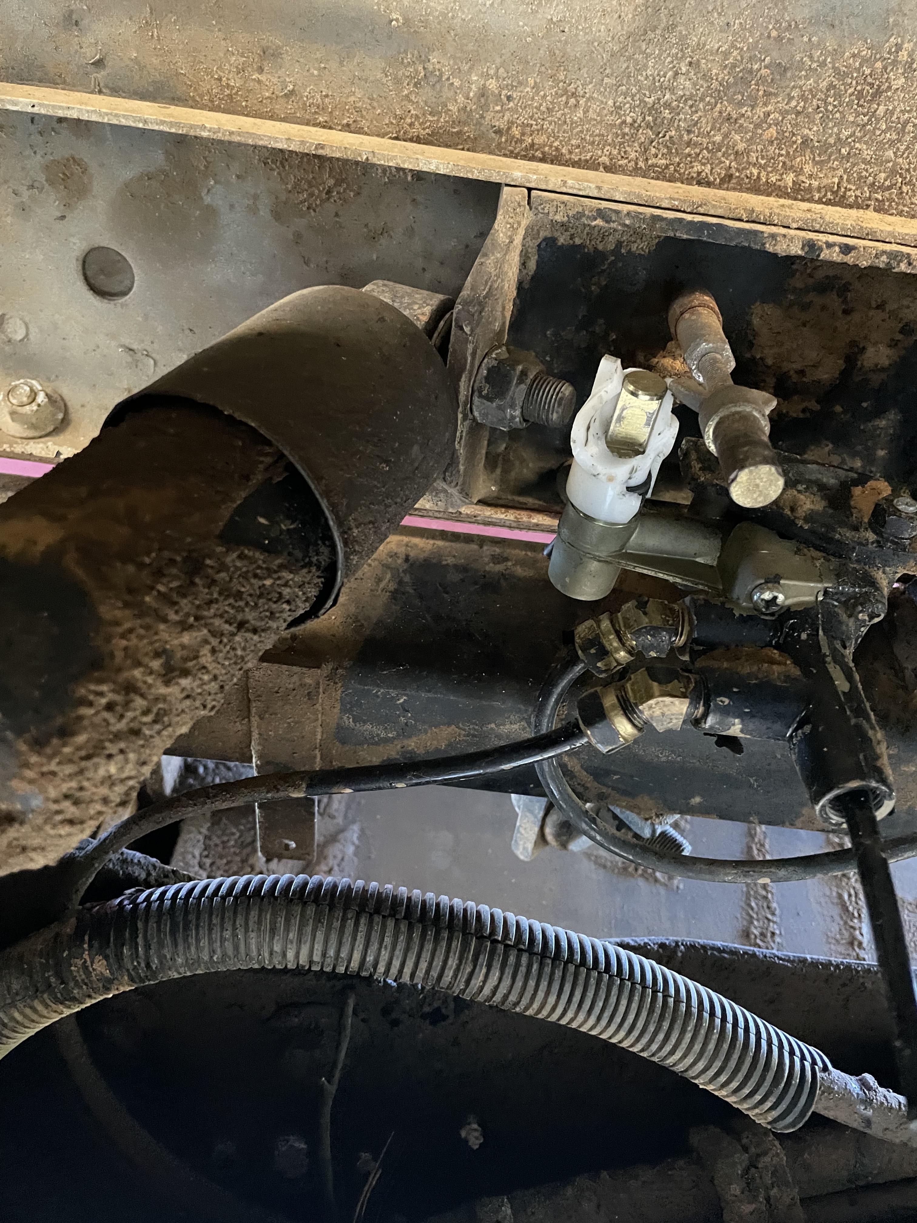

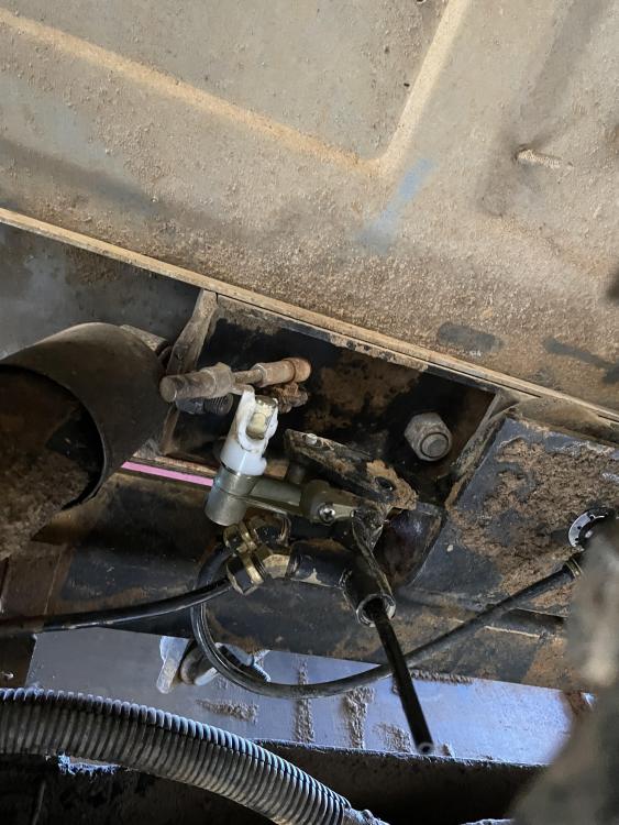

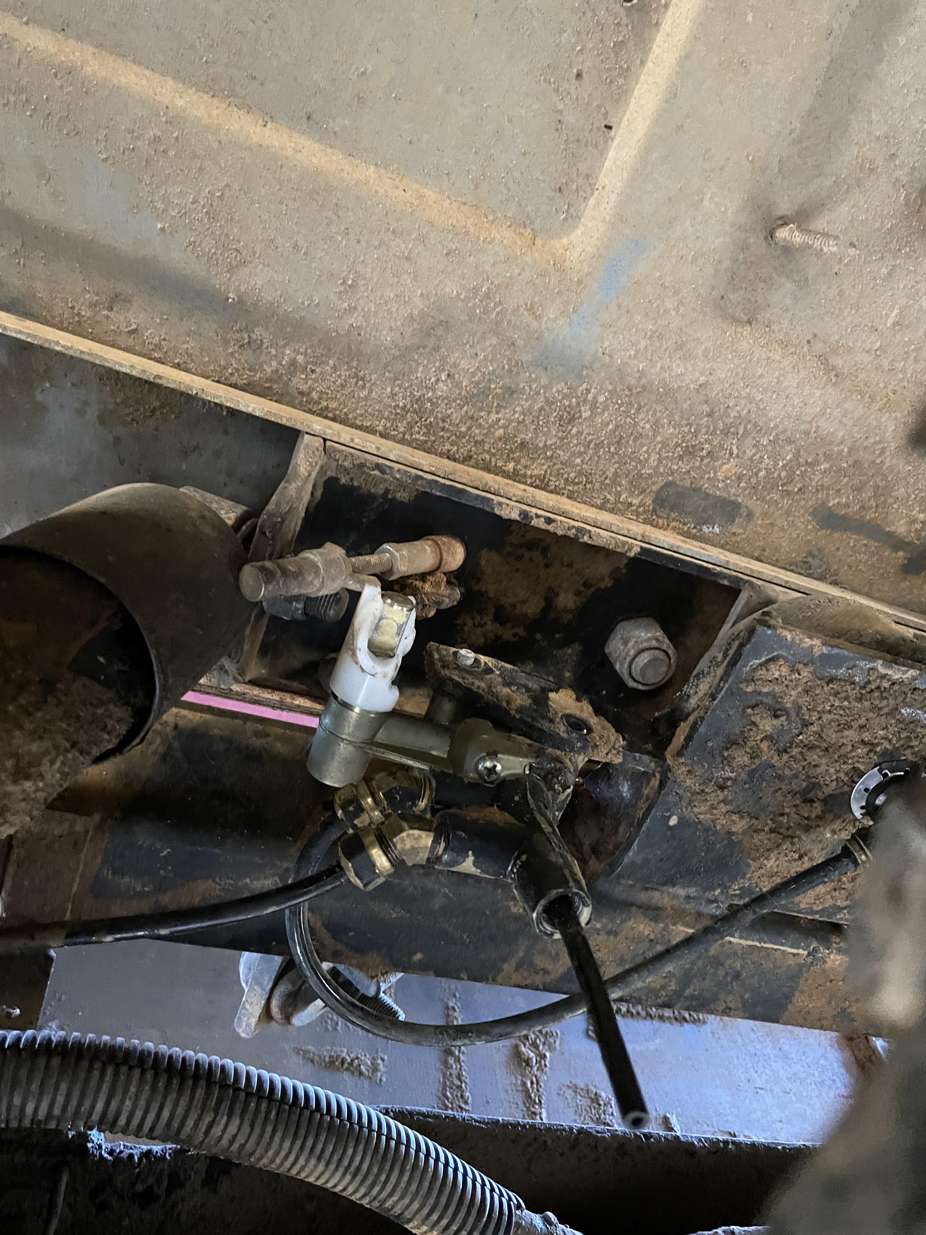

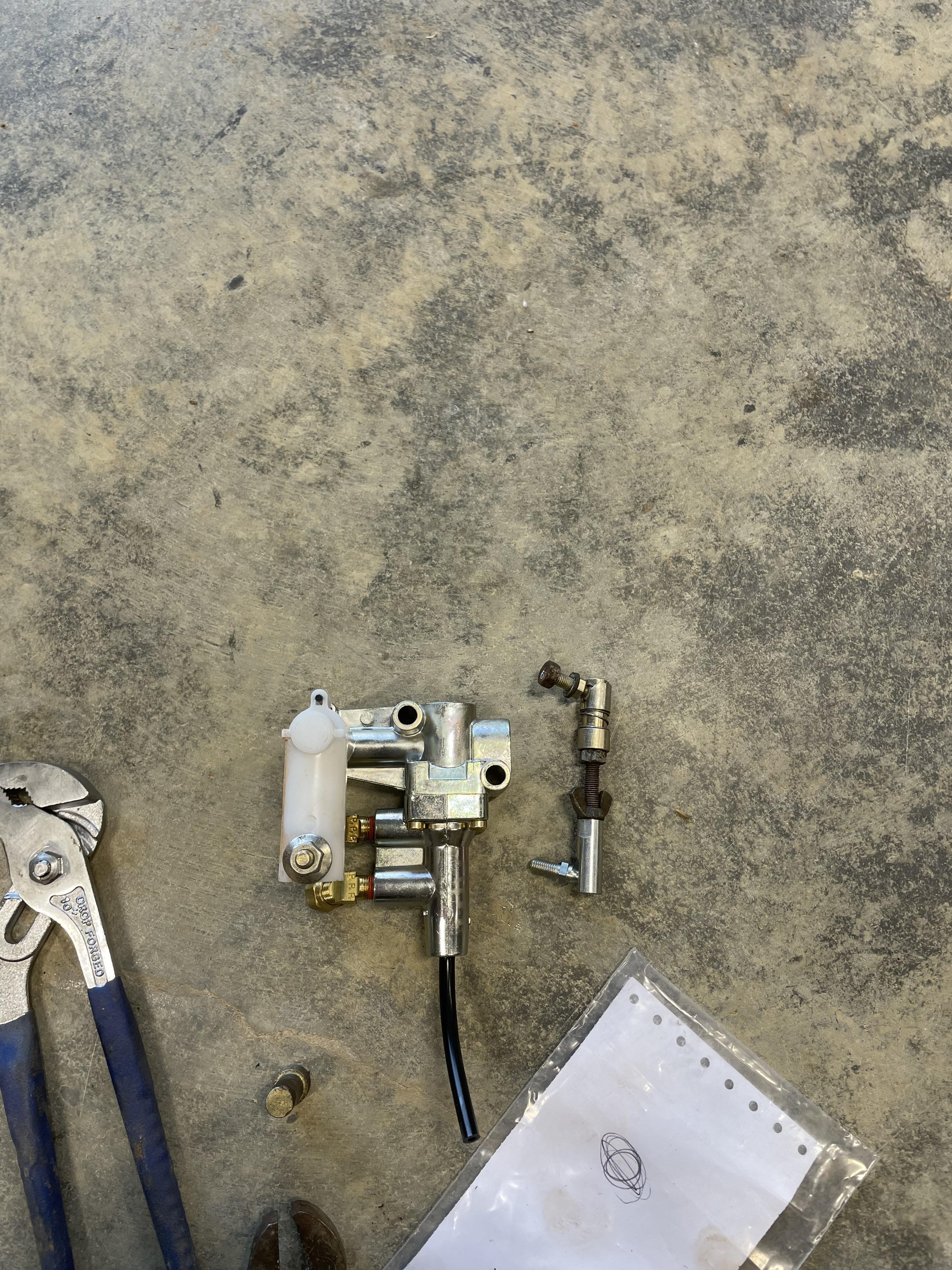

Sorry guys I have been busy with a dozer that I had to have and believe me I wish I had never bought the damn thing. I got a lot of irons in the fire. Transmission is a Eaton fuller 8ll. The shop called me yesterday to tell me truck is ready. I never have gotten the truck since I dropped it off 1.5 months ago. I would stop in and one of the mechanics left in the shop late in the day would tell me what He had heard was wrong. My invoice said the slave cylinder was rebuilt. Nothing was wrong with truck except the clutch was going out. I took the truck in and clutch was replaced but when they test drove it the hi-low switch wouldn’t work. So they went to replacing parts but the first two parts didn’t fix the problem so they put my old parts back on. Today I went by to pay my bill which was 3300.00 and again owner wasn’t there but young mechanic said the slave cylinder was rebuilt. Which fixed my problem. Sorry that’s all I know and will have someone take me up after work tomorrow to get the truck and drive it back home. Thanks for all the advice and I may be asking for more but hopefully this truck is ready to work. -

Macks it turned out good. We ended up having to the trunion bar due to a loose nut wearing away all the threads. my biggest concern on this whole hi/lo switch not working. I was told the valve on the transmission was worn out they replaced it and problem still there. They have replaced two parts and not fixed the problem. Yes they put my old parts back on but the trust isn’t there. I mean if the first valve they changed out was worn out how is it working now. im no mechanic but my gut tells me they have screwed something up and they don’t even know what it is they have screwed up. -

Still don’t have my truck back. The shop has replaced two parts but not finding the problem. They have put my old parts back on. They are now saying they have to rebuild a valve located near the rear of transmission. My question is this a coincidence or did someone mess something up replacing my clutch? Again my high/low switch was not working. Before clutch replaced never had any issues with it. -

They were saying at the shifter but last I talked to them they said it was a valve on transmission that operates hi/lo -
I had a local shop to replace my Eaton fuller clutch. Never had a problem with hi/lo switch leaking air or not working. Well after several weeks I went in to check on truck and was told The hi/lo switch was leaking air. Nobody really could tell me what exactly was wrong seems they were wanting me to talk with main mechanic. Next day I talked to main mechanic and said the lines were correct( thought they were switched) and he would have to trouble shoot. Week later he is saying a valve on top or side of transmission is bad. Does this make any sense to you guys. I’m at the mercy of having to listen. Is this a coincidence that the valve went out. Never had a problem out of hi/lo switch before?
