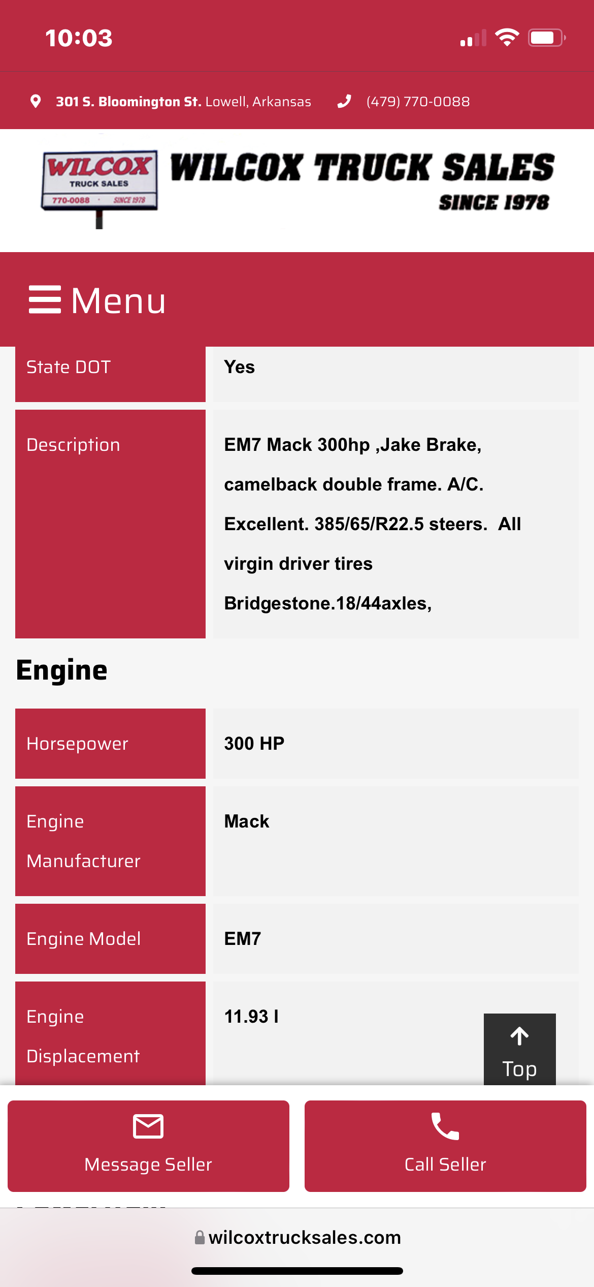

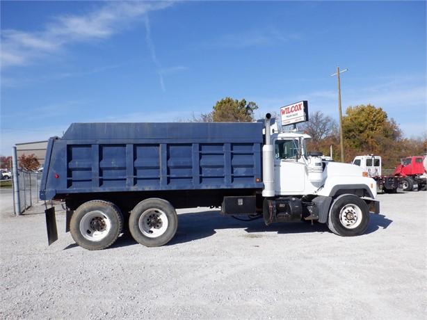

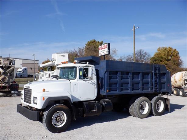

  4. This is just a post for information. Saw an ad for a low miles 2000 rd690s with a seven speed. What little information I can find, not many people like the seven speed for a dump truck. Where these trucks mostly day cab trucks that were converted to dump trucks. Shows double frame, em7 300 horsepower. looks like a nice set up all except the seven speed. Just gaining knowledge so appreciate the information
