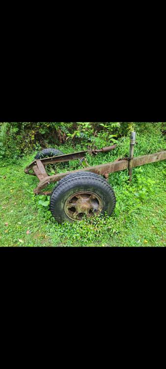

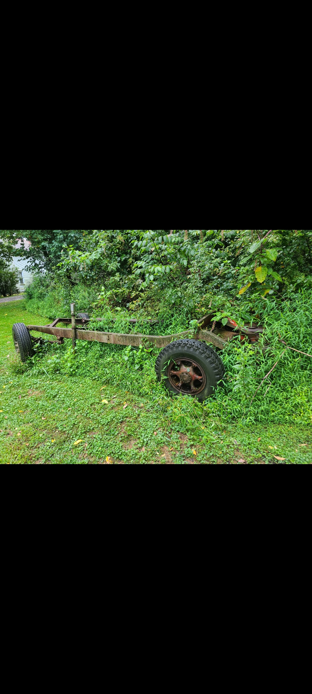

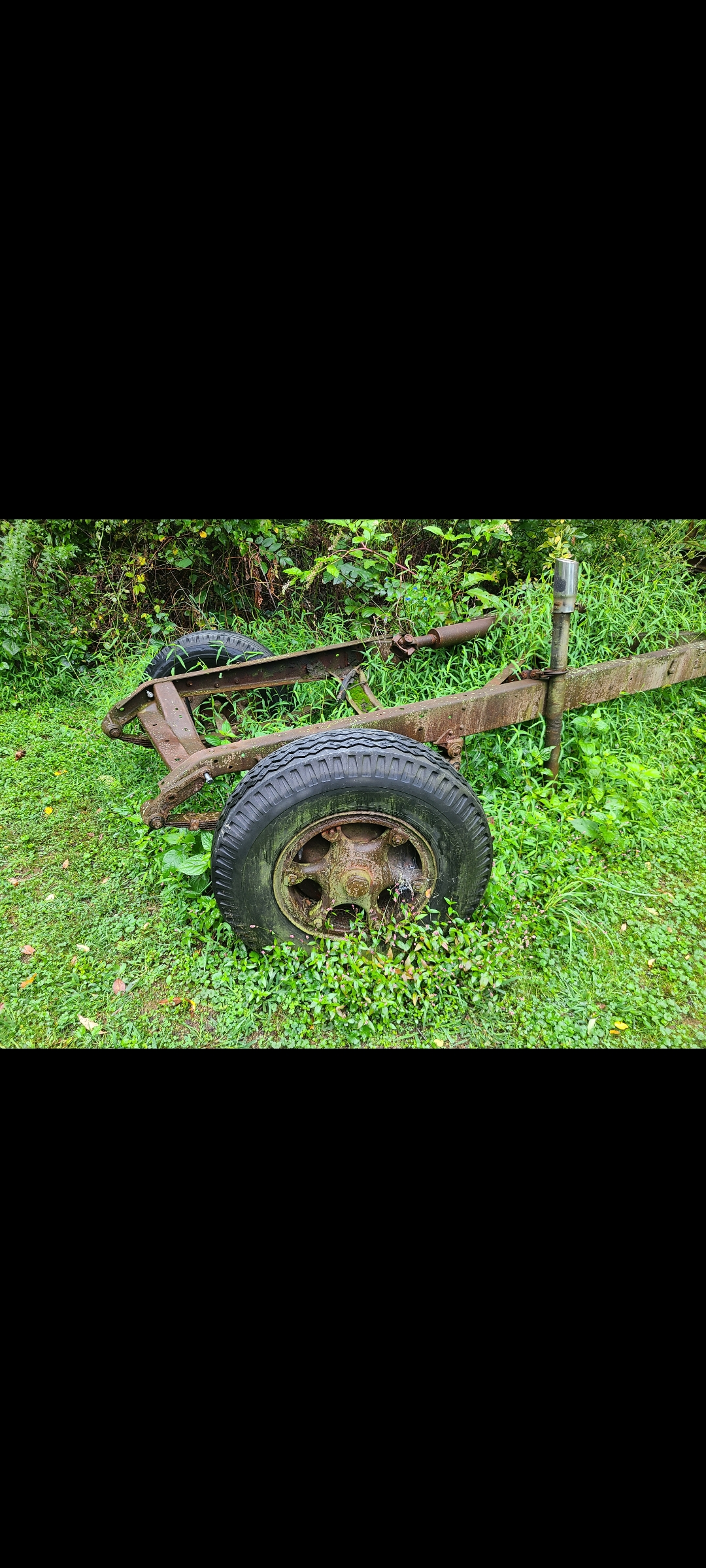

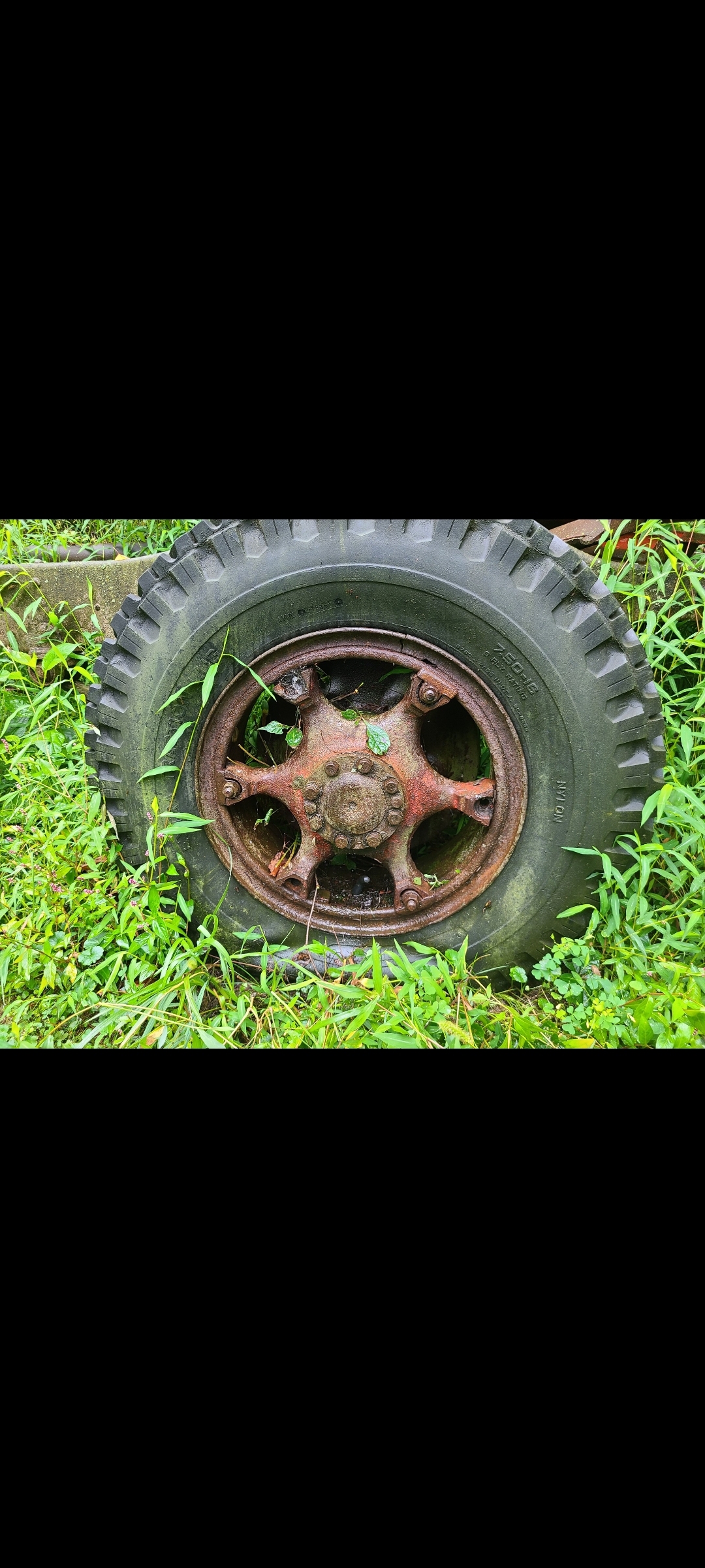

Brockey it had a pretty fat pack in the rear and they were under the axle witch was strange and the humped frame is odd too next time I'm there ill look again from my understanding the owner just passed away -
In my work travels I came across this frame can find no markings has dayton front and rear leaf springs with added coils in the rear was wondering if anyone knew what this would have been from its kinda short behind the rear axle definitely an odd set up
