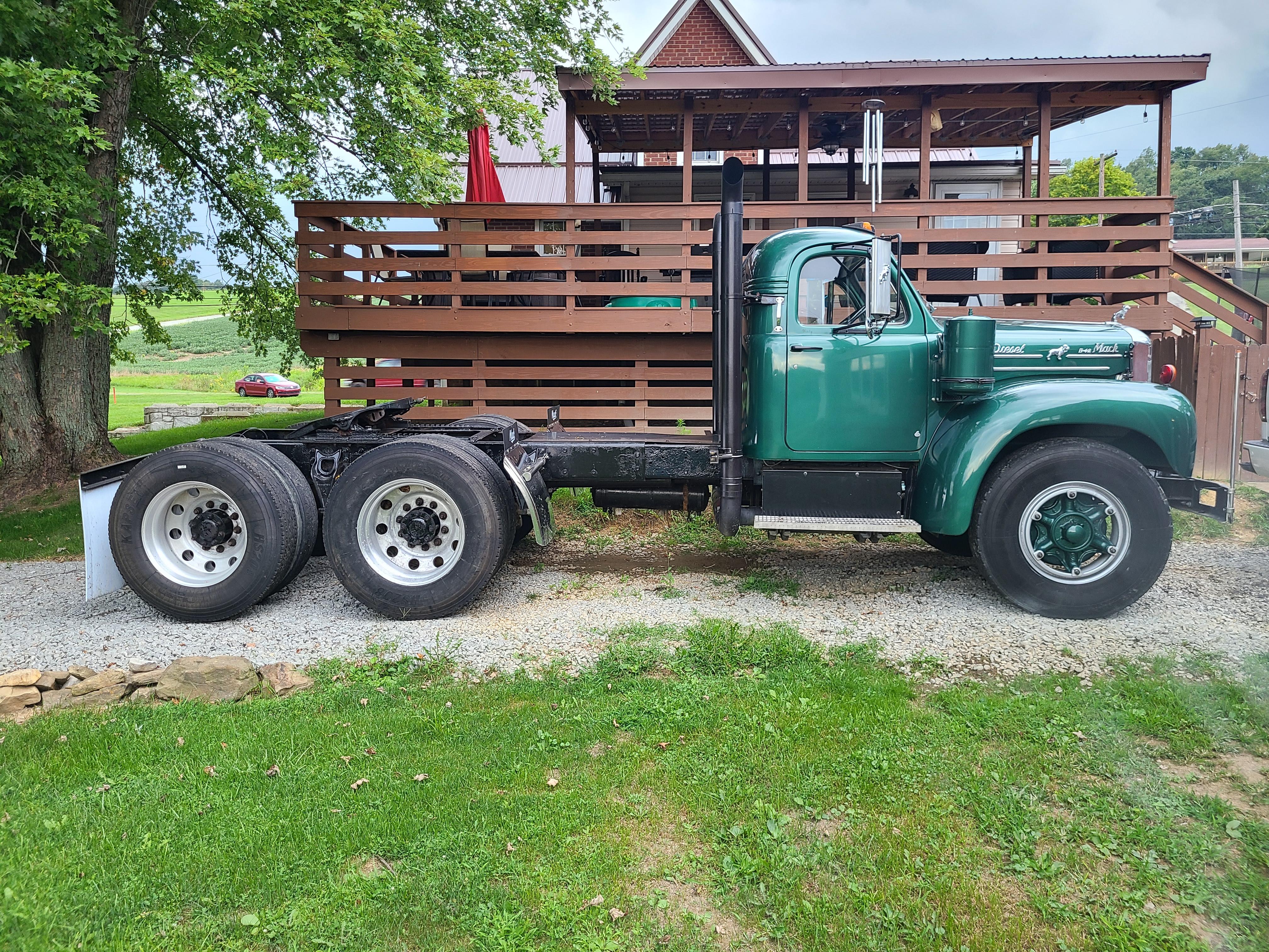

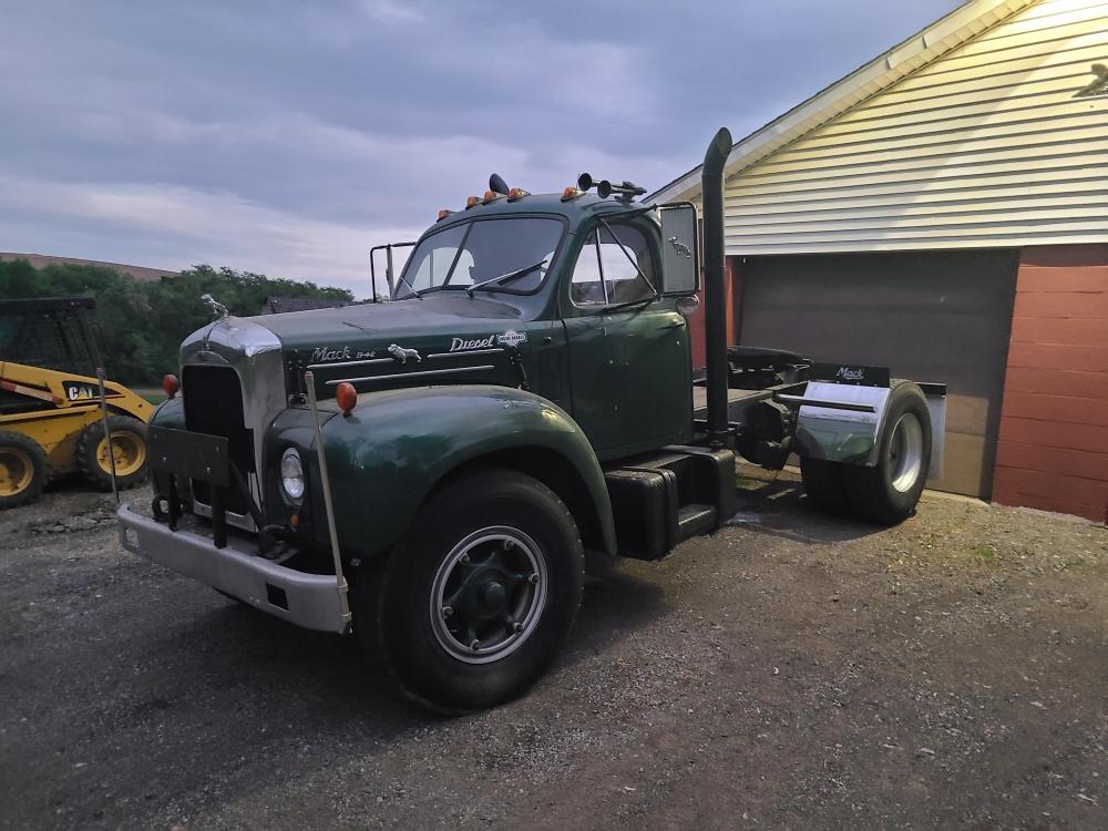

  1. Great looking truck I like the grille that's on it looks diffrent than all the others . diesel would be nice in it I have a converted b 42 that somone did years ago wouldn't go over 45mph rear end was geared too deep you would have to check your rear end ratio

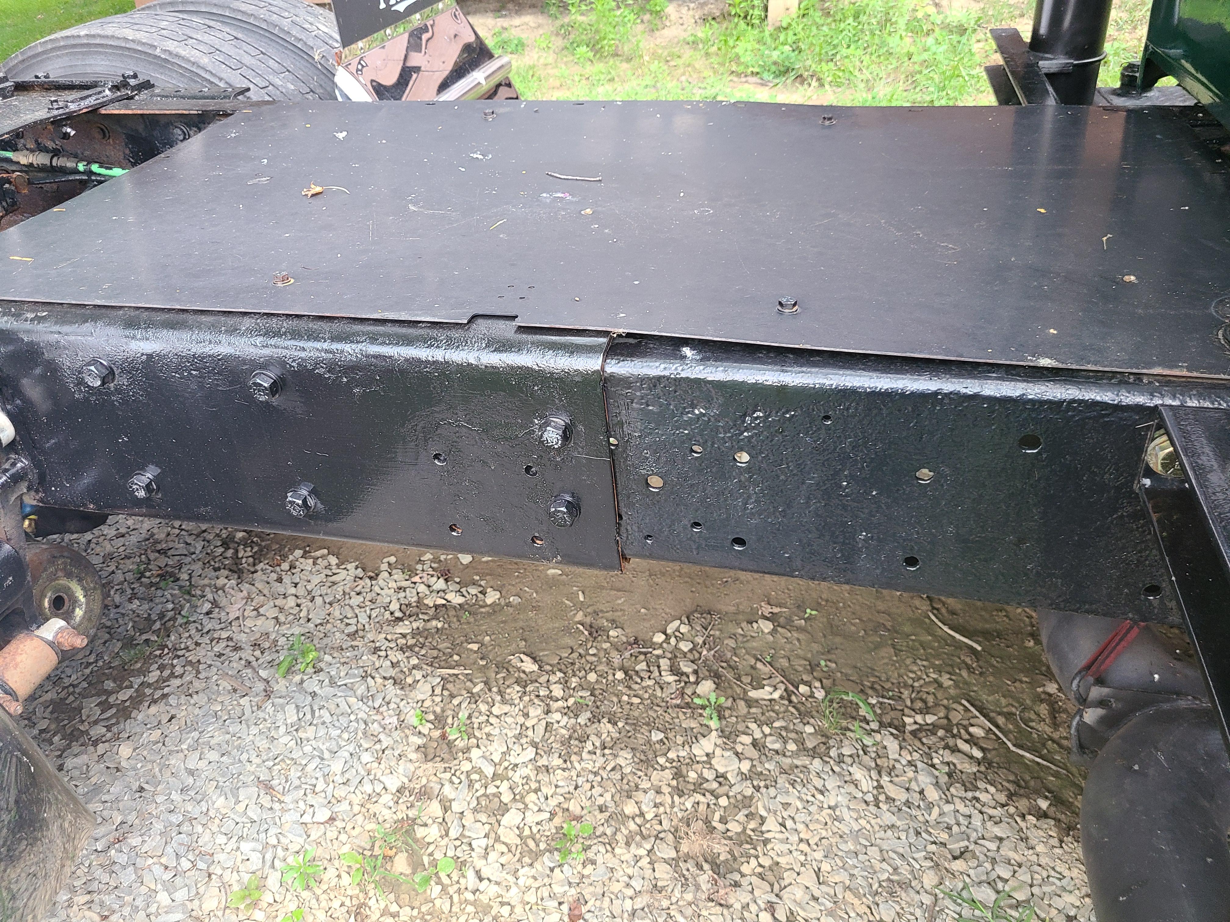

  2. if I had to I can lengthen the truck the frame is overlapped and bolted together I would have to make a new drive shaft

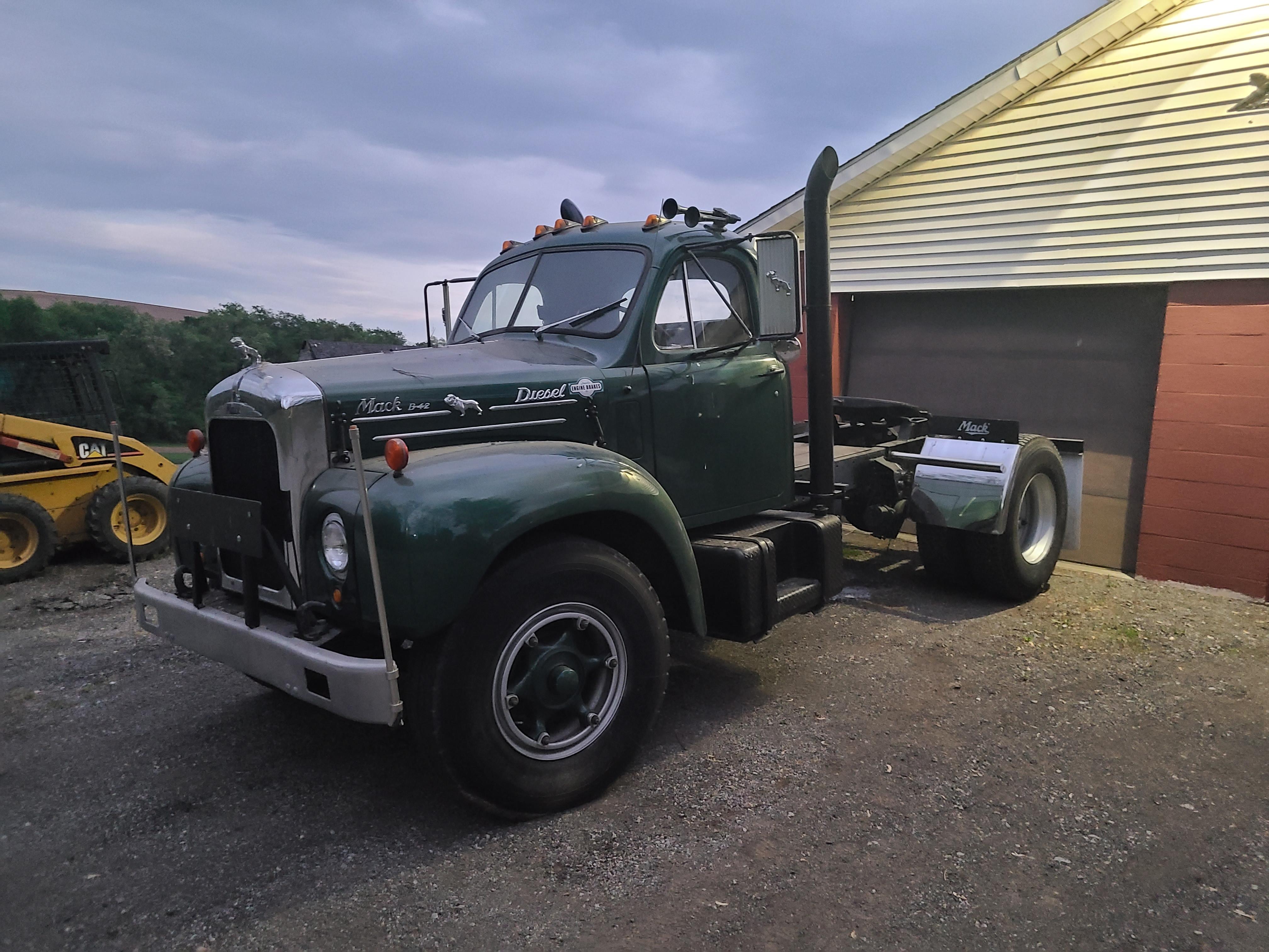

  4. I really like the look of a sleeper mower man it's just finding one

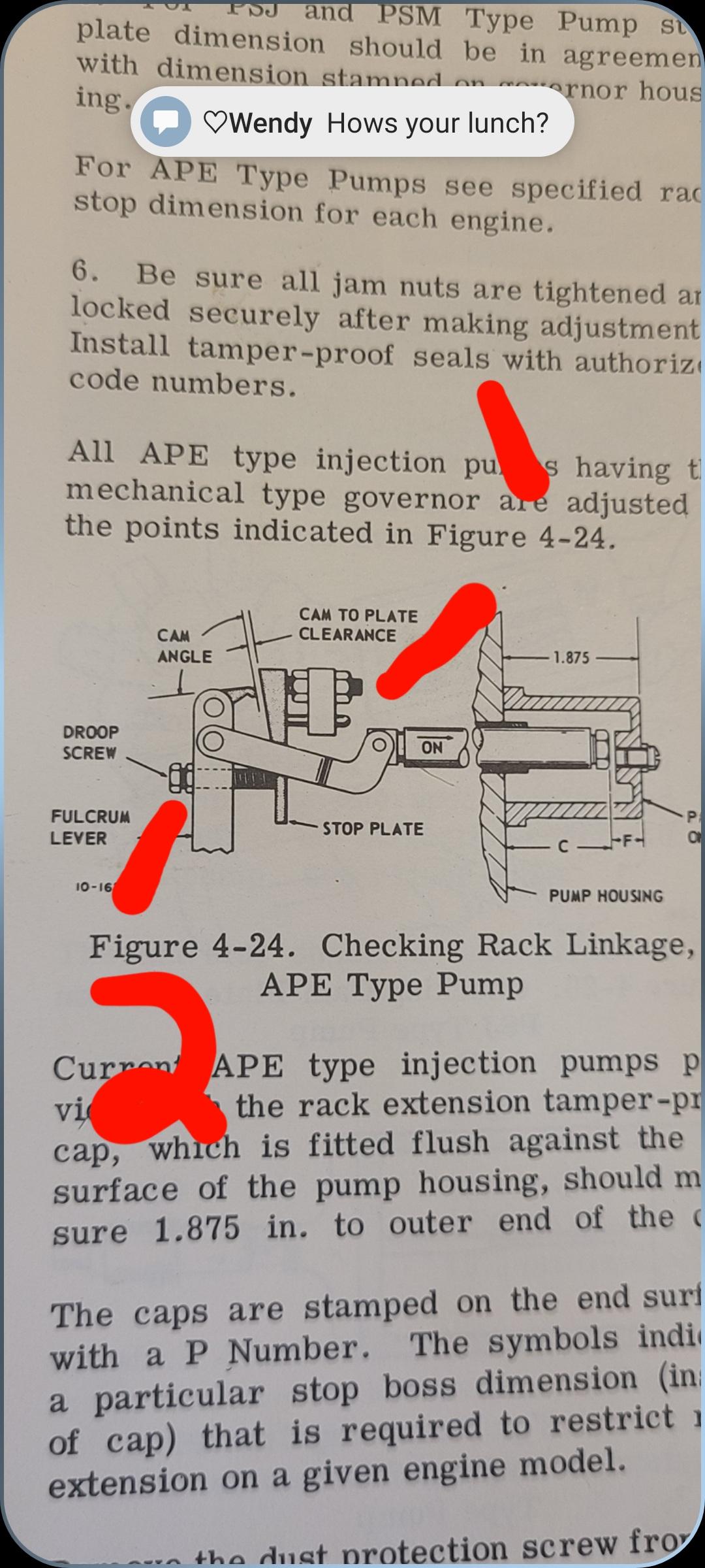

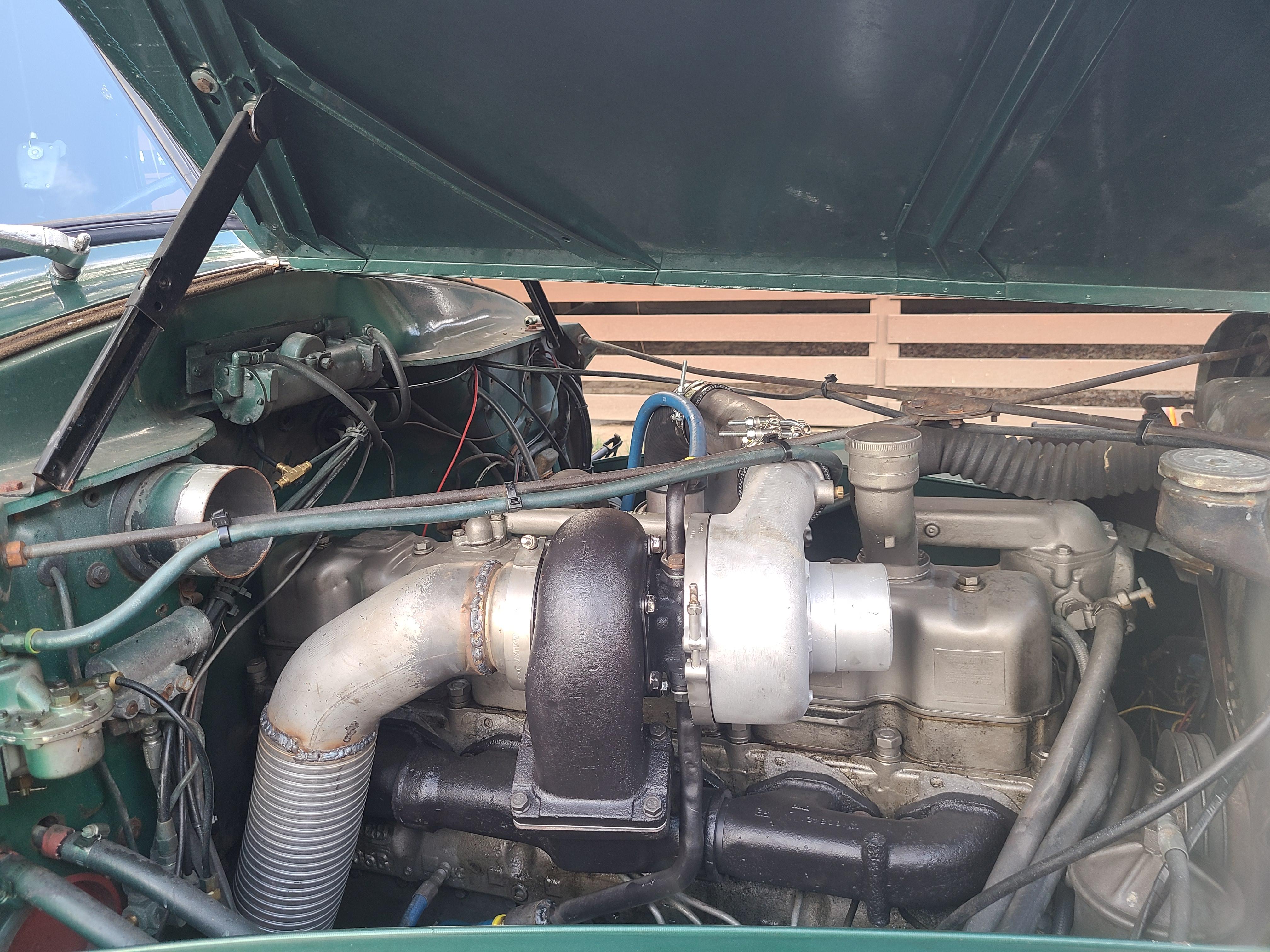

  17. Hello all have a question and hoping I can get some answers I have a 673 that is natural aspirated I just added a turbo to .With the extra air it lacks in powe the truck never smoked before and I want to turn the pump up a bit to make it run a little better I have looked for a good pic of what to adjust but not exactly sure I know I should have changed the inj pump but don't have the one for a turbo I have a picture from the manual I'm including should I adj the screws marked 1 or the ones marked 2 and witch direction the manual really don't say I don't want to remove the pump to remove the screw from the front and I understand the adjustment is limited with the front screw left in any help or suggestions are welcome thanks Kevin

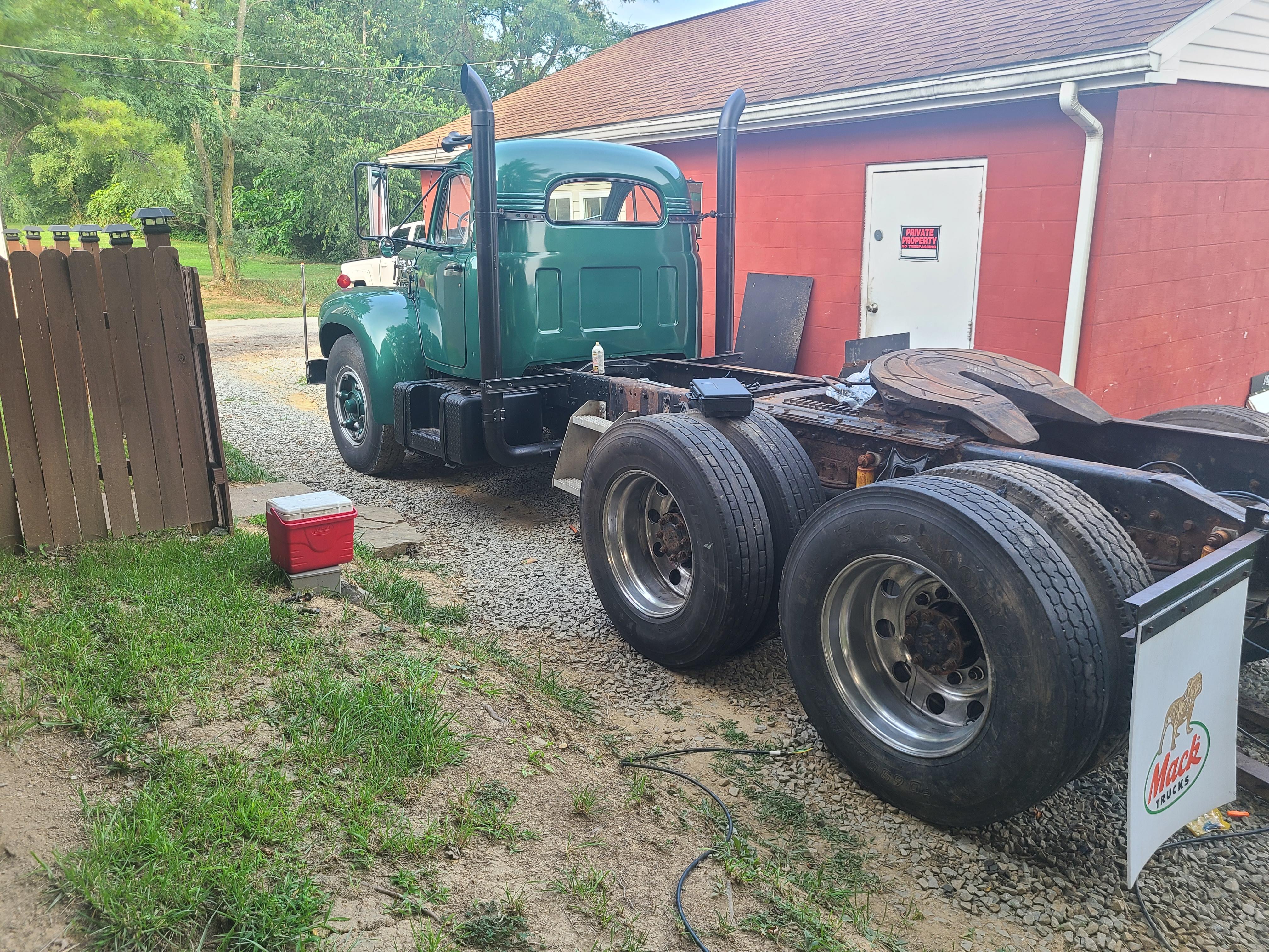

  19. Turboed the b model today worked out ok haven't been able to take it for a run yet but she sure does sound good. A big thank you to Back in Black Pulling for the parts

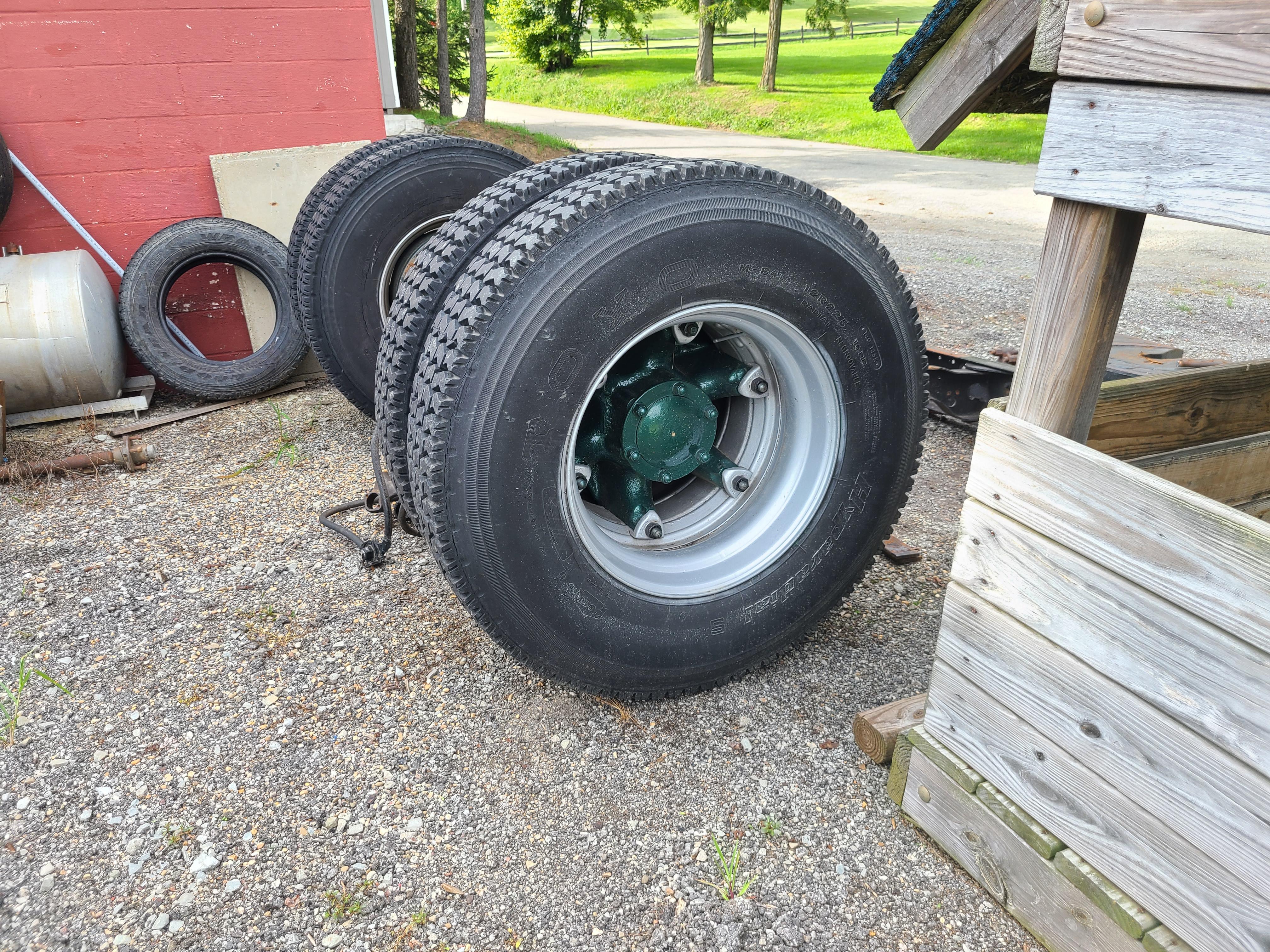

  22. single axle rear end for sale or trade double reduction no rust and works good just removed from my truck tires good tread but weather checked 4.62 ratio comes with lower u bolt mounts would trade for a front axle for a b model that has bud wheels or make me an offer located in latrobe Pennsylvania
