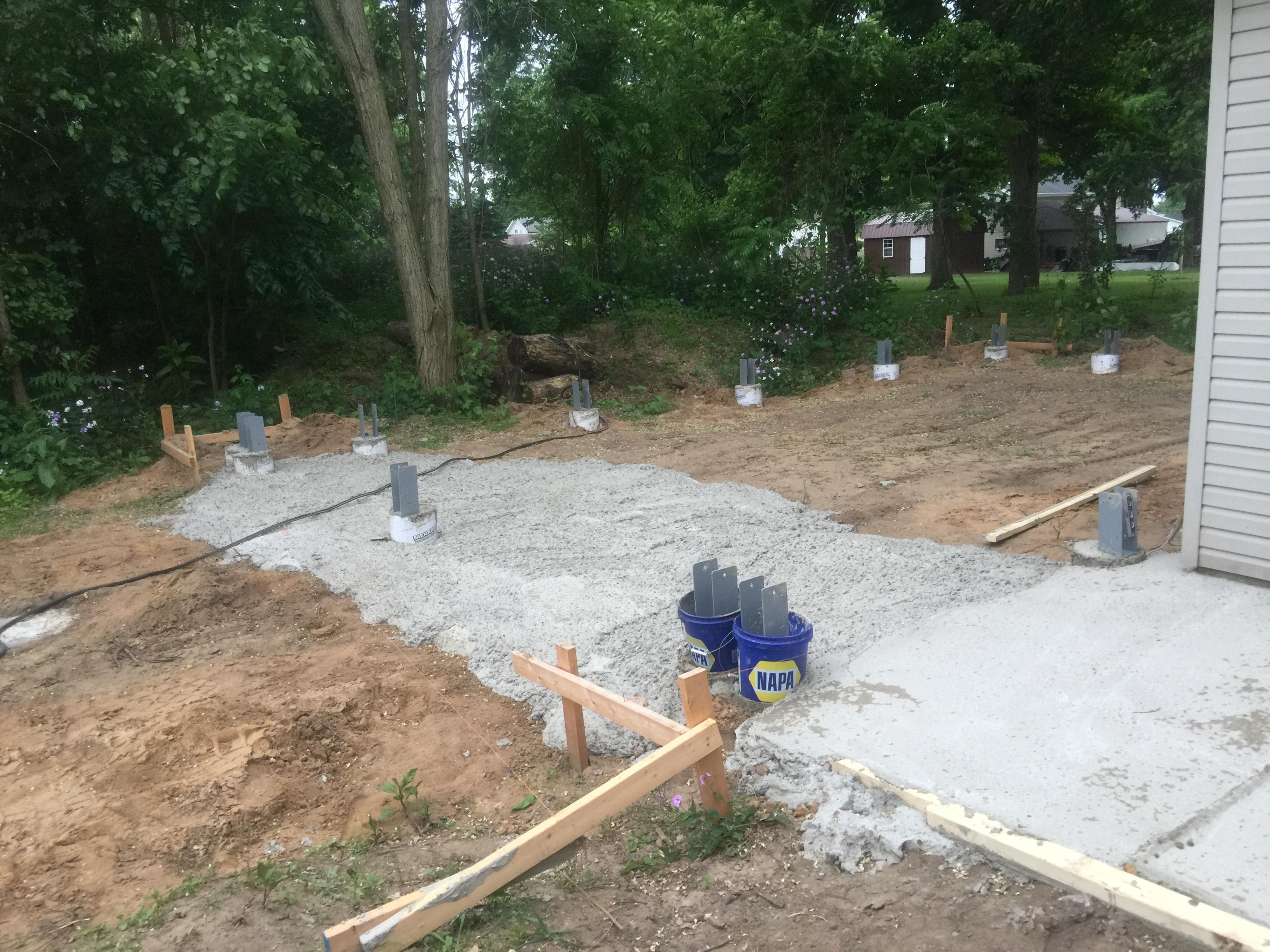

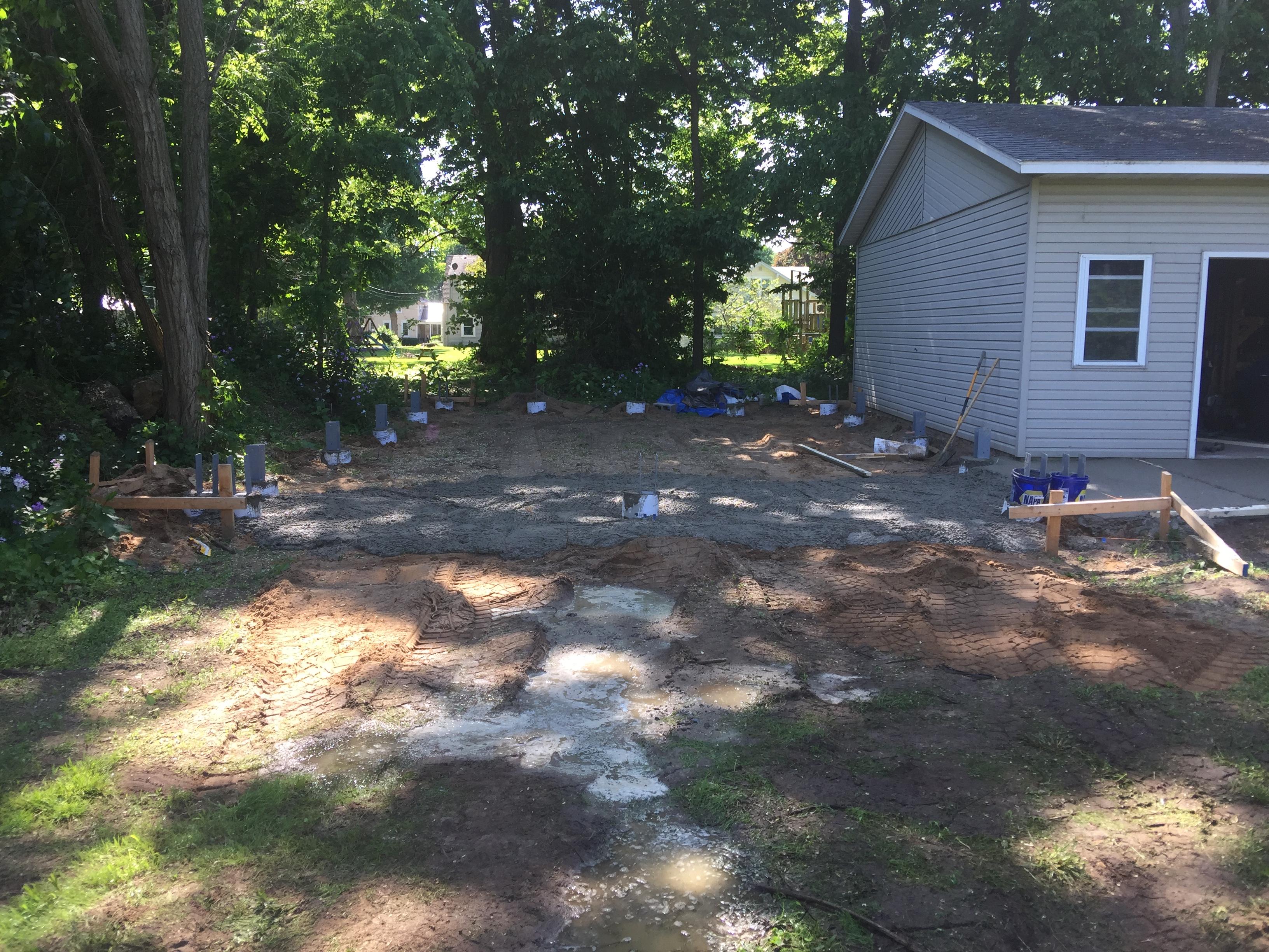

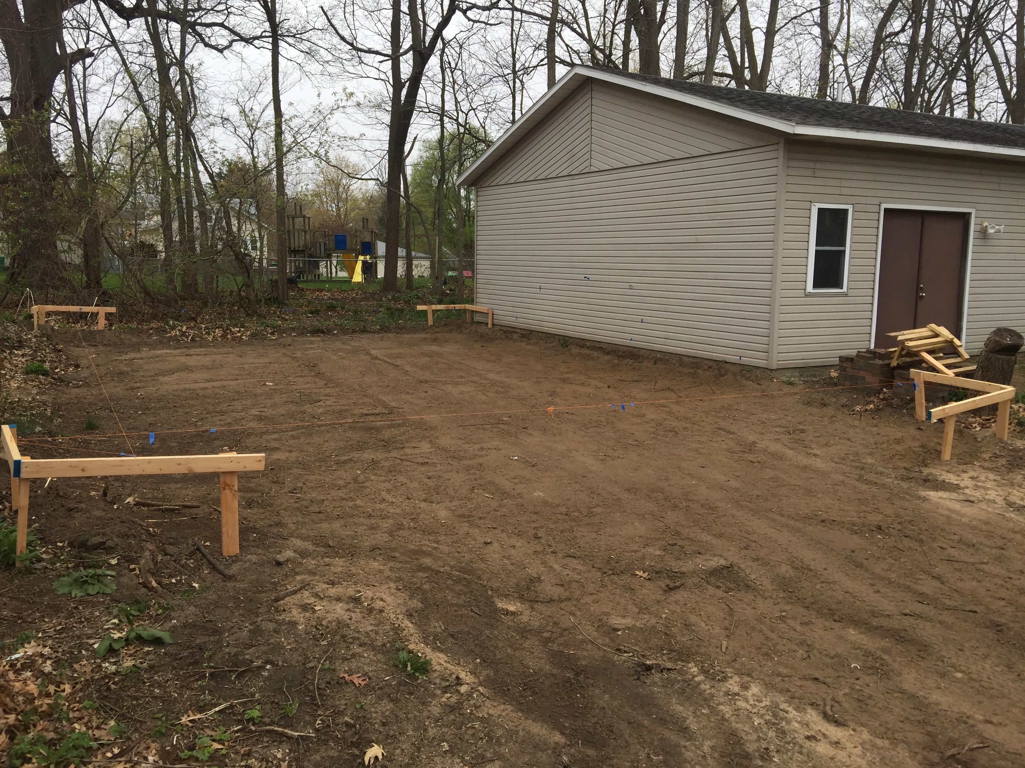

  2. The 24 wide x 36 long x 16 tall barn expansion build has finally begun.😁 Just laying out the string lines,post locations and getting things leveled up.

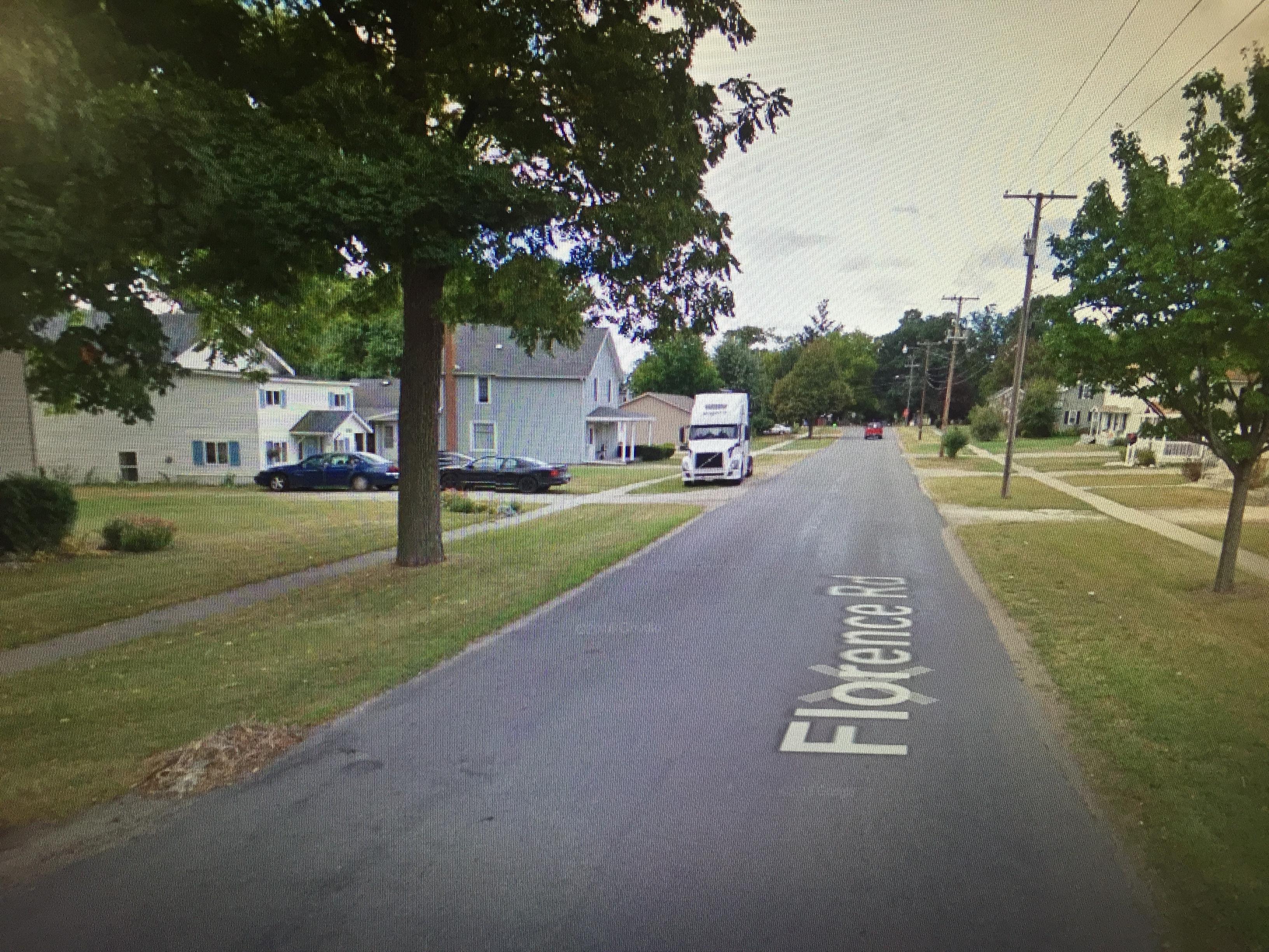

  3. It is quite a busy street as it is one of two roads in and out of the towns industrial park area. Oh no worries on the building I hate having my things sit out side anyway. Now on with the permits and footings 🧐

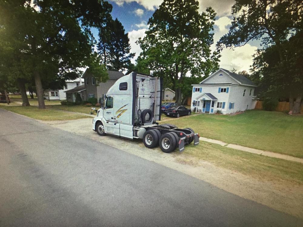

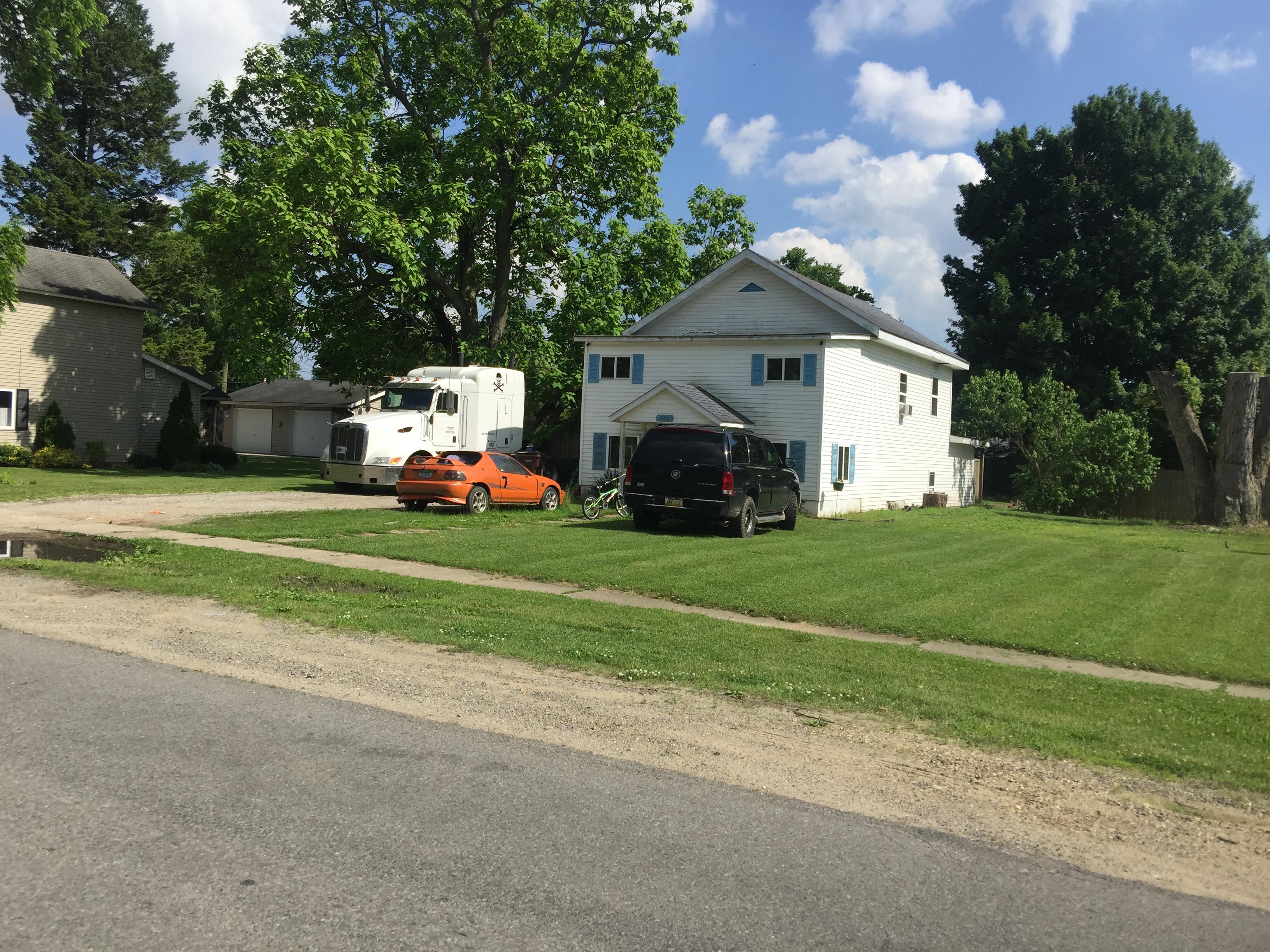

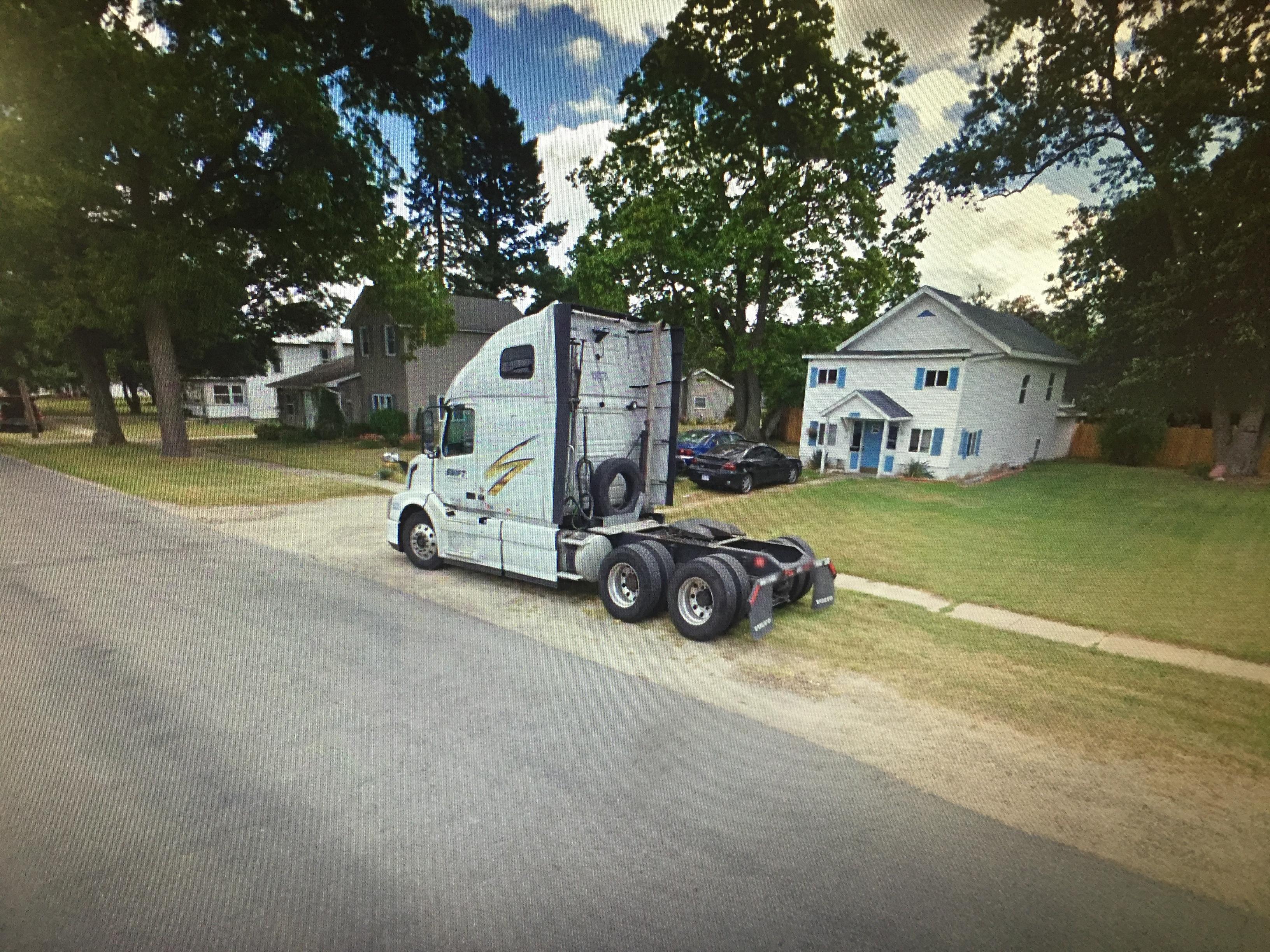

  4. Ah, a final resolution to the issue I finally met up with my villages zoning officer. Plans are in the works for a 26x36x14 addition to my current barn to keep the Mack and trailer inside of. Life is good and I have some time as construction beings depending on the weather . 🙂 Also found the source of complaint . Apparently a swift driver was trying to park his rig in front of his house and few blocks over and was complaining about why I could have mine and he couldn’t . Slightly different parking situation than mine mine I would say

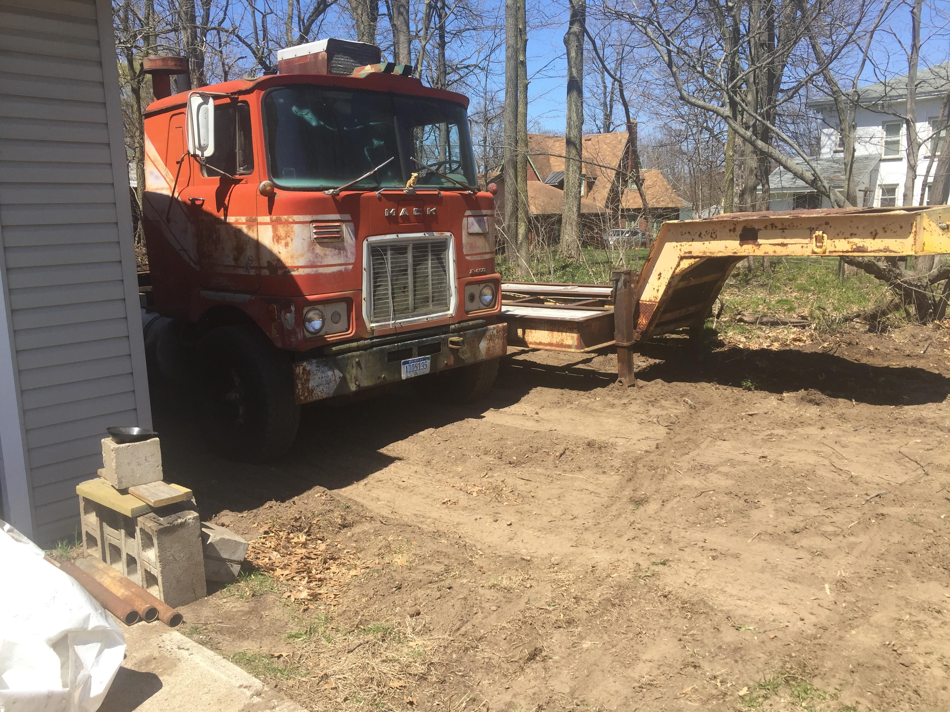

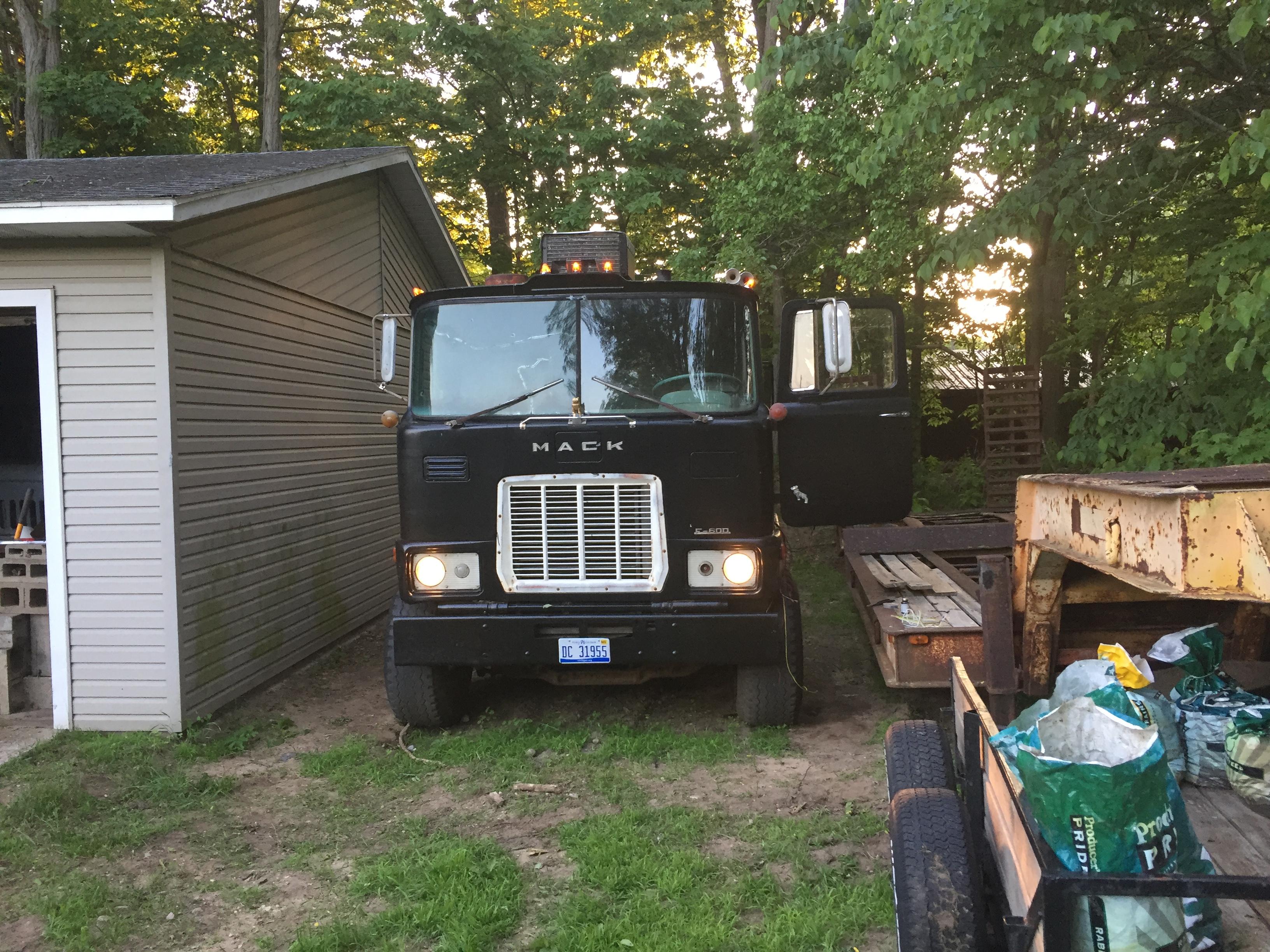

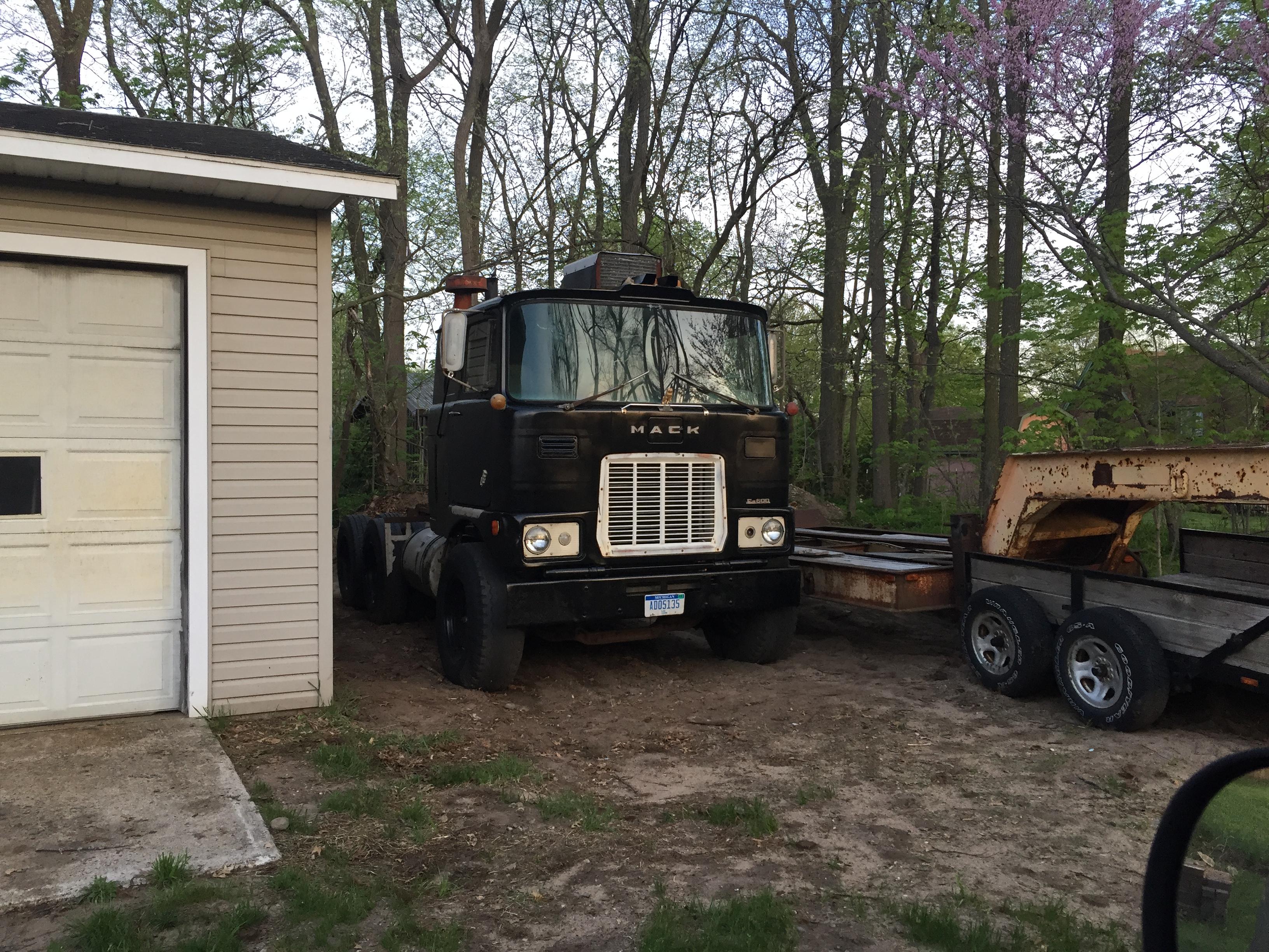

  5. Yep painted it flat black and slid it in where there are trees on two sides and my barn on the third.

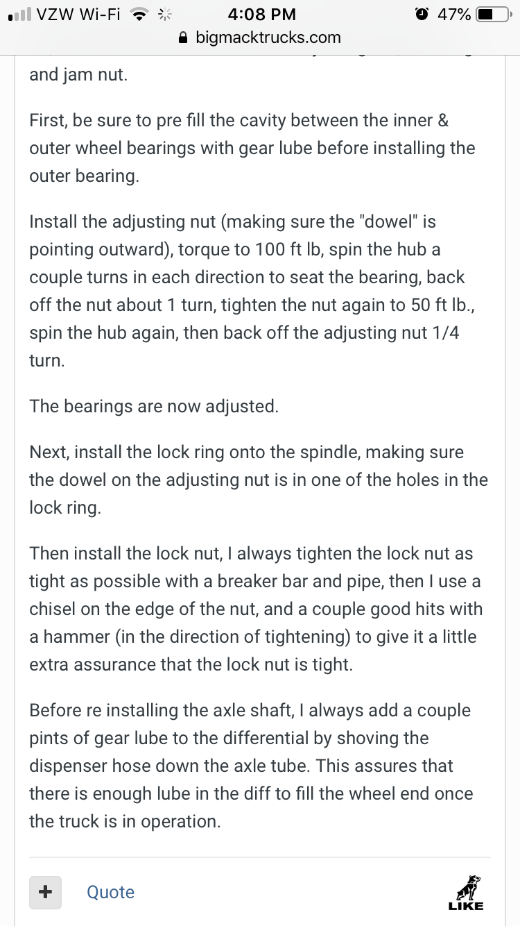

  7. Loctite on the races and I put the large radius bearings in as Vlad’s reasoning makes sense. All should be good. I have to set the bearing preload tonight then onto the other side seals and bearings. Swishy , I do plan on changing the fronts to grease after I am done with the drives .

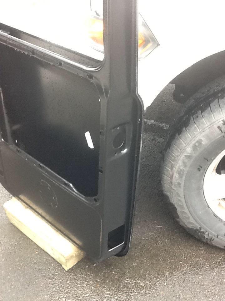

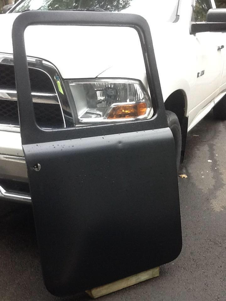

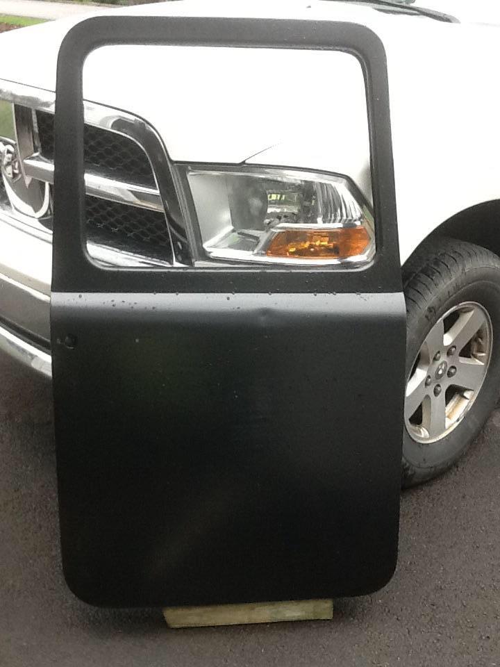

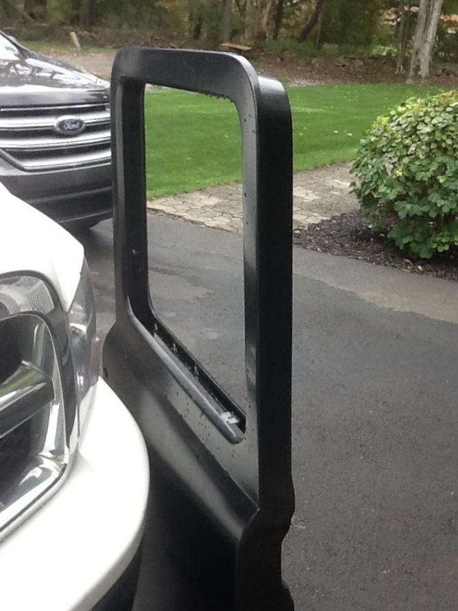

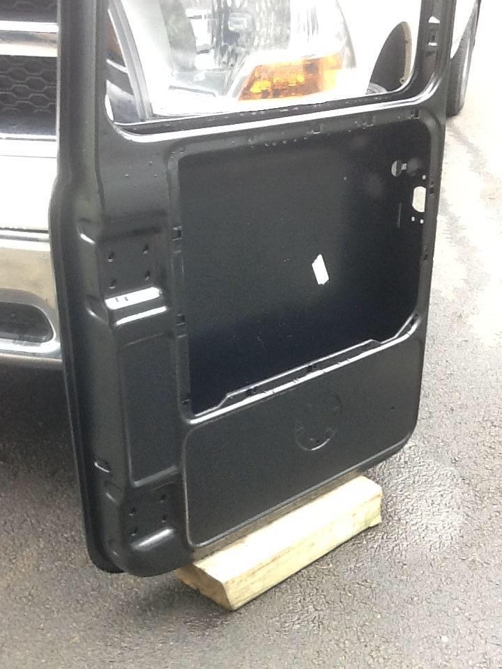

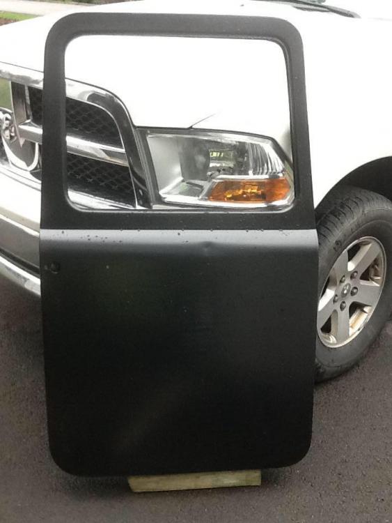

  8. Ooooooooo. That is one nice looking door. 🧐 Sadly mechanical things are inline before cosmetic. Right side up pictures:

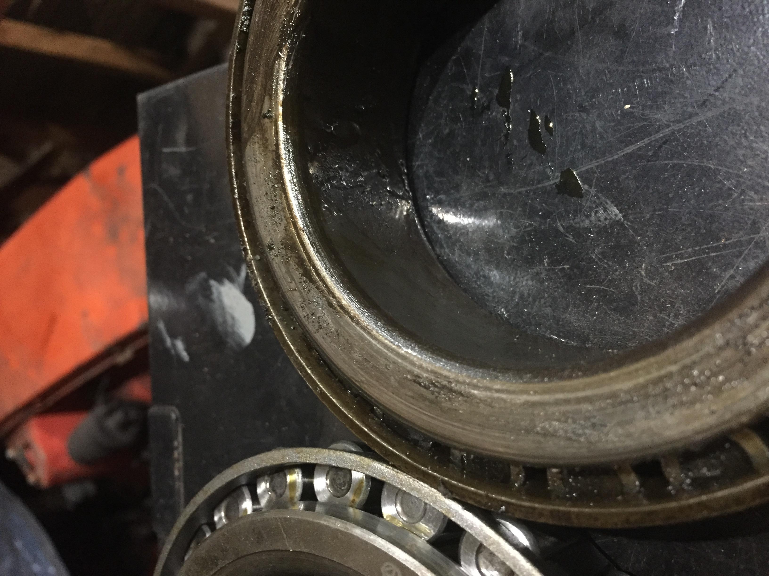

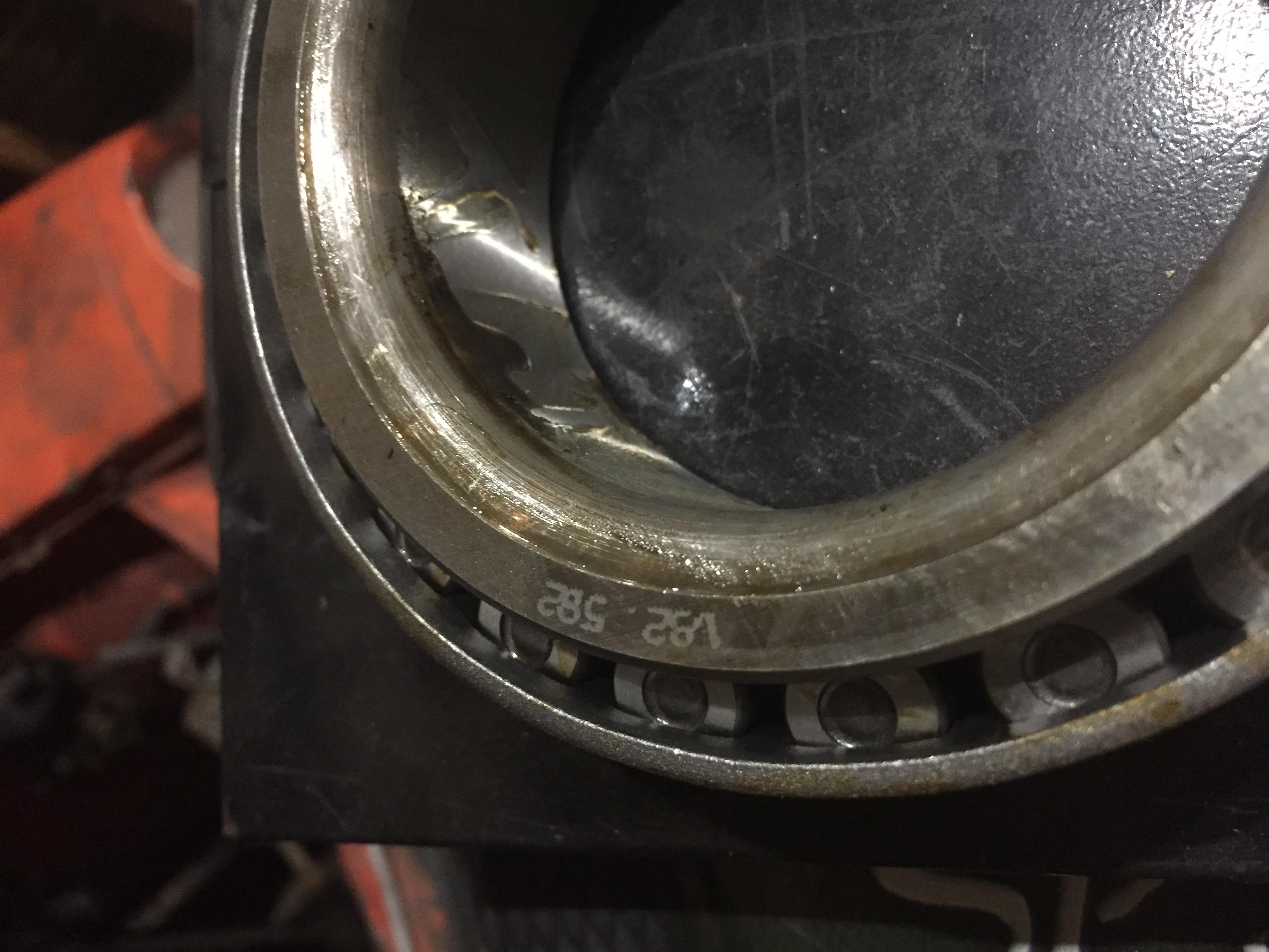

  9. Ran into an unknown this afternoon when replacing the wheel bearings and seals on the f-model. I ordered based on the timken book for my axle,hub casting #’s and year a 382-372 cone cup for the inner bearings . These has a “Mack special radius” according to timken. Now the glitch is the bearings I took out are 380-372 set. Both the 380 and the 382 are identical in dimensions, but the 382 has a larger inner radius. See pictures. Which is the right one for my f-model? Should I go with the timken catalogue or what was installed previously? Thanks

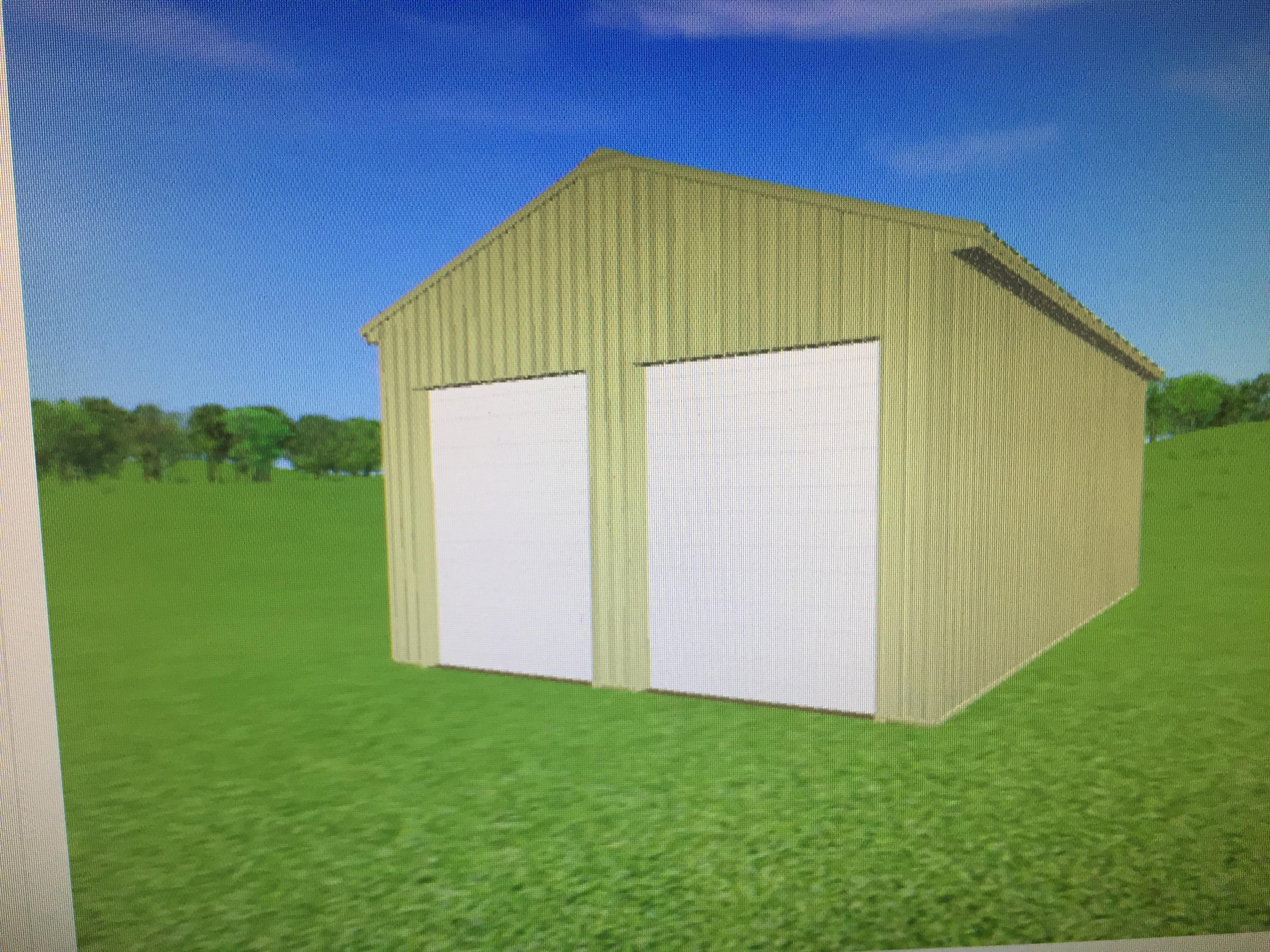

  16. On a happier note. The F-model is sporting the first coat of its new look. I need to do a second coat and then re-do the former accent white design in smoke grey in addition to the fuel tanks and all non chrome trim pieces smoke grey as well. A new slack adjuster, a wheel seal an oil change plus a few odds and ends and it will almost be road worthy. Yeah time to build some diamond plate rear fenders as well.

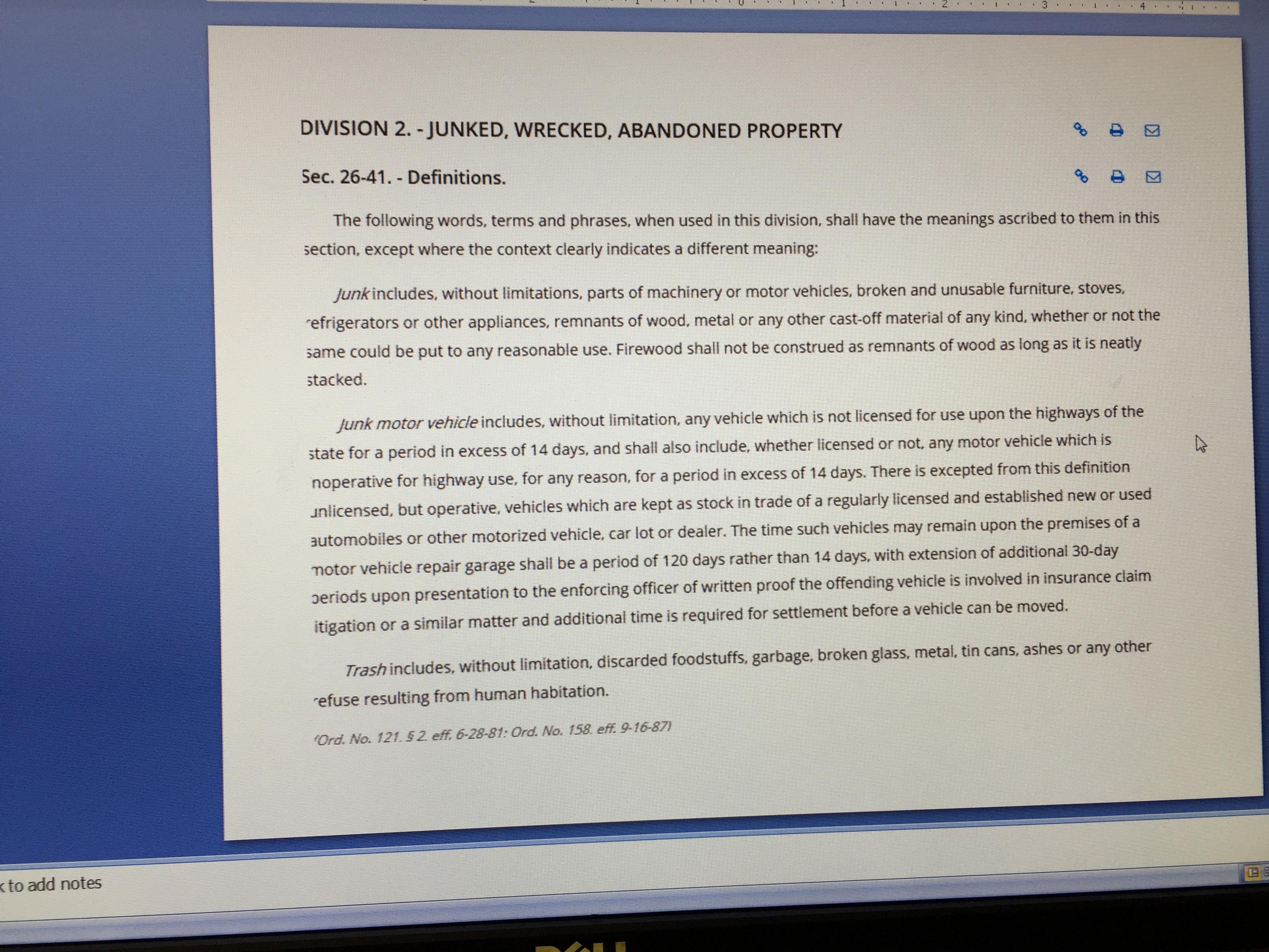

  17. Oh an I happened across an other lovely code/zoning. It bans any "project" vehicle whether it is licensed and insured or not. If it sits more than 14 days and can't be started and driven on the road it isn't allowed.

  22. Thanks guys, lots of good ideas. As far as more info. I own 2.5 acres “the entire middle of a village block” so I have a ton of neighbors all around my back yard. I haven’t used the semi or trailer since I moved here over a year ago. I just fire it up once a month or so and do a loop around the back yard. It isn’t currently registered but I am leaning towards a vintage or historical type plate. I talked to the zoning officer, he seems slightly accommodating. I think I just have to get it agreed that isn’t being used for commercial purposes and is basically a really short RV. Here is the zoning I am up against:
