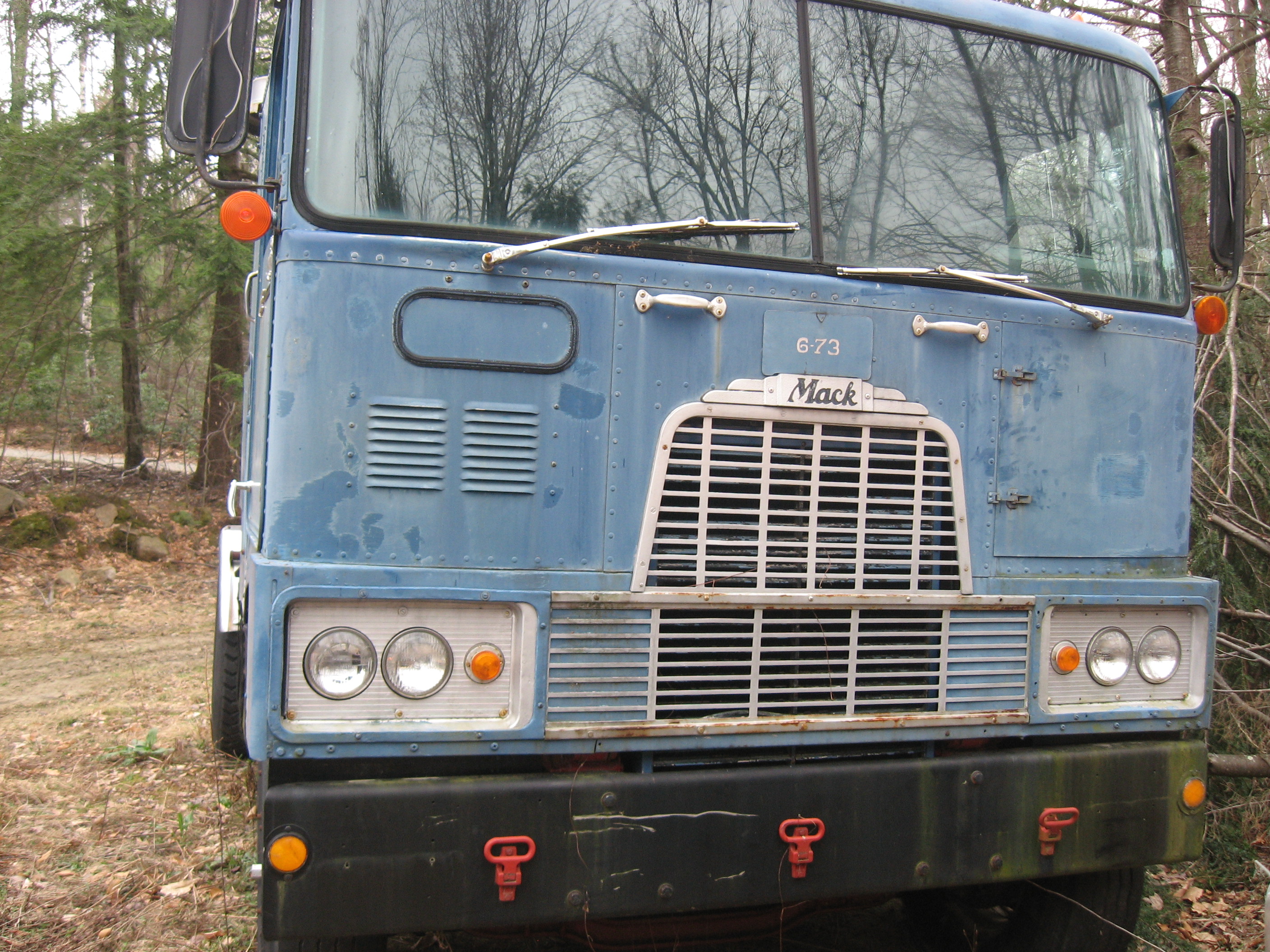

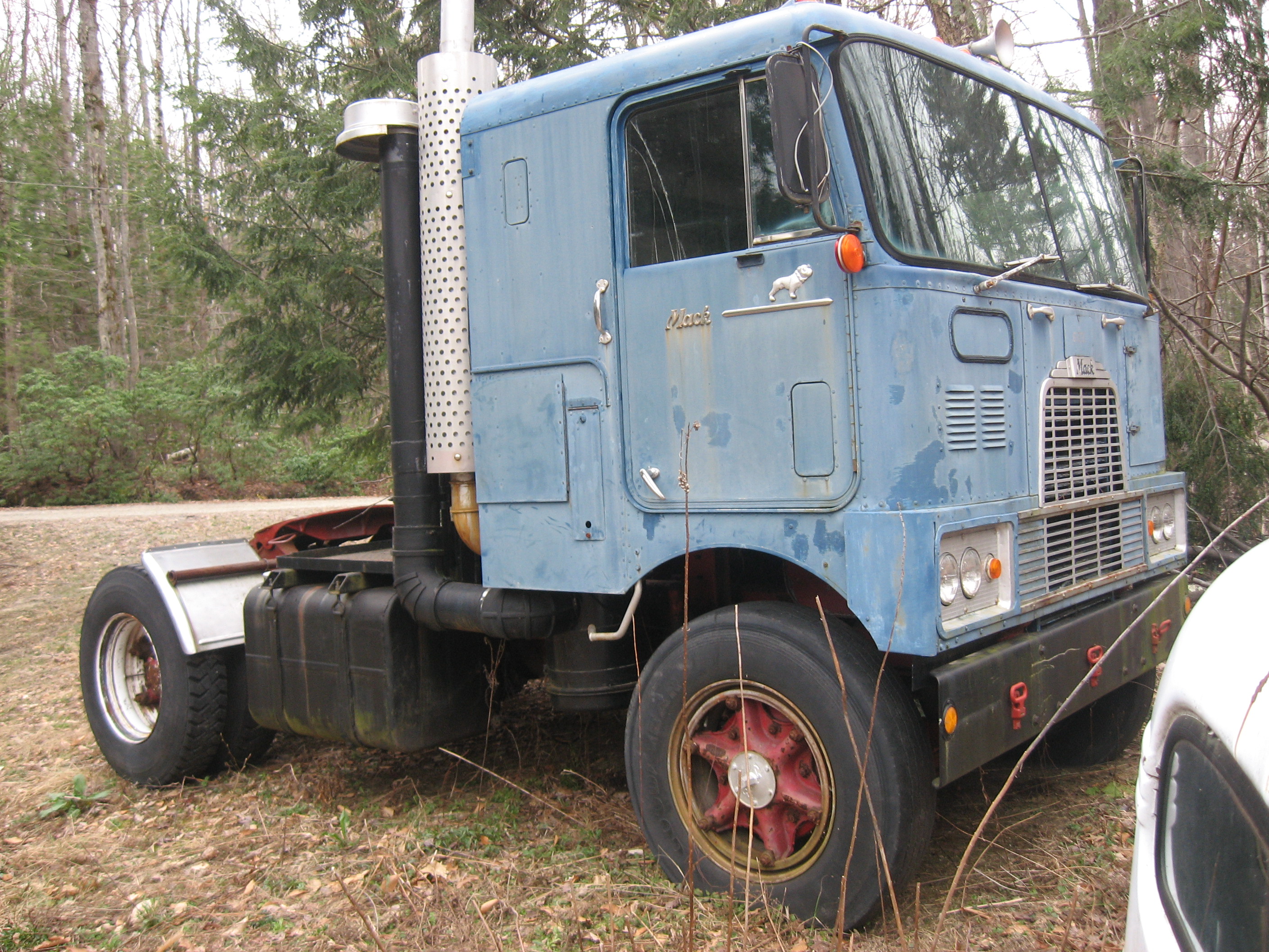

  1. I saw this truck last fall at a place where we were looking at other trucks.Upon return the other day,it was still there and he kind of really wants to move it.It is in fantastic shape for it's year.I figured since junk is high again I would make some sort of deal,we did.It is a 1959 G73,has an NH-220 and a TRT7220 and a top loading double reduction rear.Don't know what I am going to do with it,but it would make a good home for that Model 20 Jake I have had stashed all these years.
  2. Try Marvin S. Tell Co. in Trafford,Pa.They are about the best of the remaining "ML",or any old Lipe clutch shops around.Al
  3. Looks like a B-67,a diesel.There is no VIN tag inside the passenger side door?The VIN number will be on the frame on the R.H. side,between the front spring's rear hangar and the air line to the brake.Those used 4-6 volt batteries,2 in each side in series.
