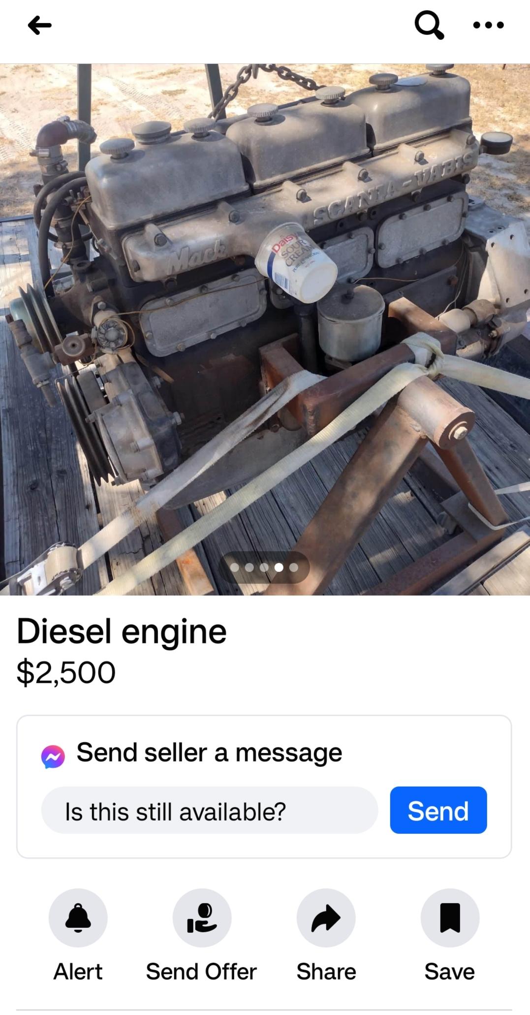

What do you think fellas? https://www.facebook.com/share/1WY1dQ46y9/

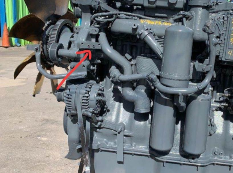

https://www.facebook.com/share/14SusdGPbNi/ Something like this is what you're looking for. Price is a bit high, but it has engine brake. Like previously mentioned, you can tell it has engine brake spacer between the valve cover and the head. -

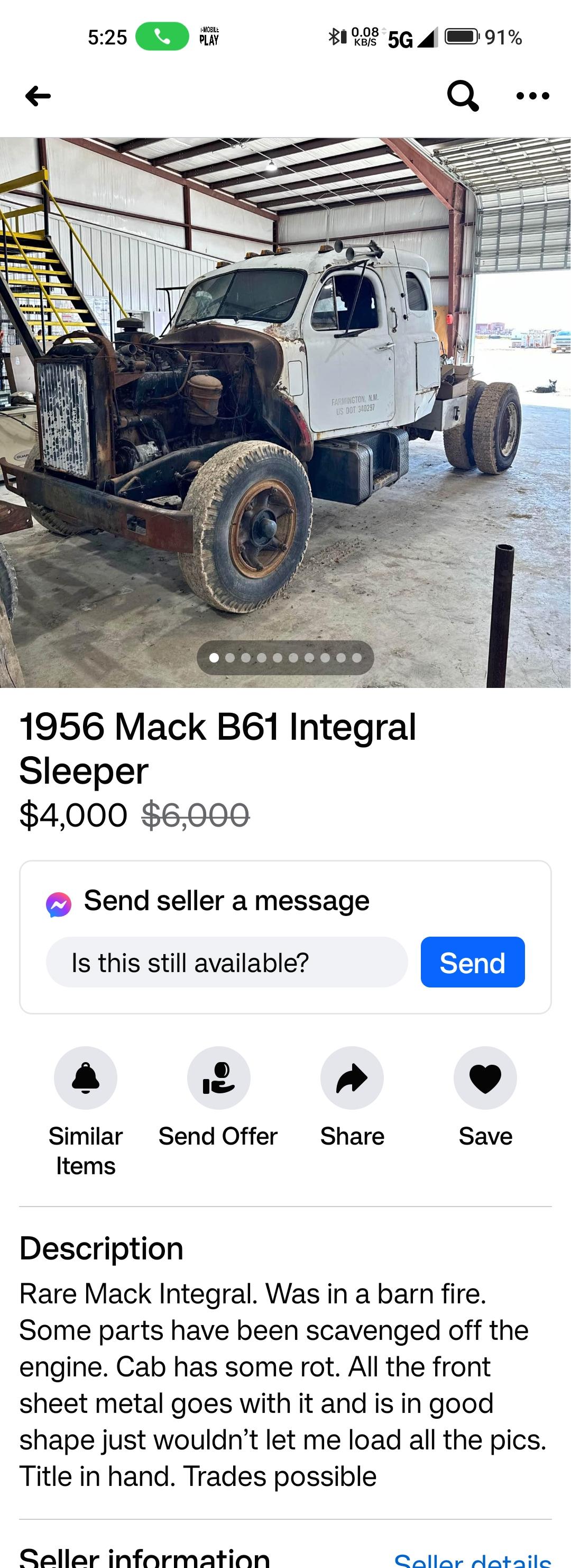

Saw this on book face. https://www.facebook.com/share/r/1BehPzP7M2/

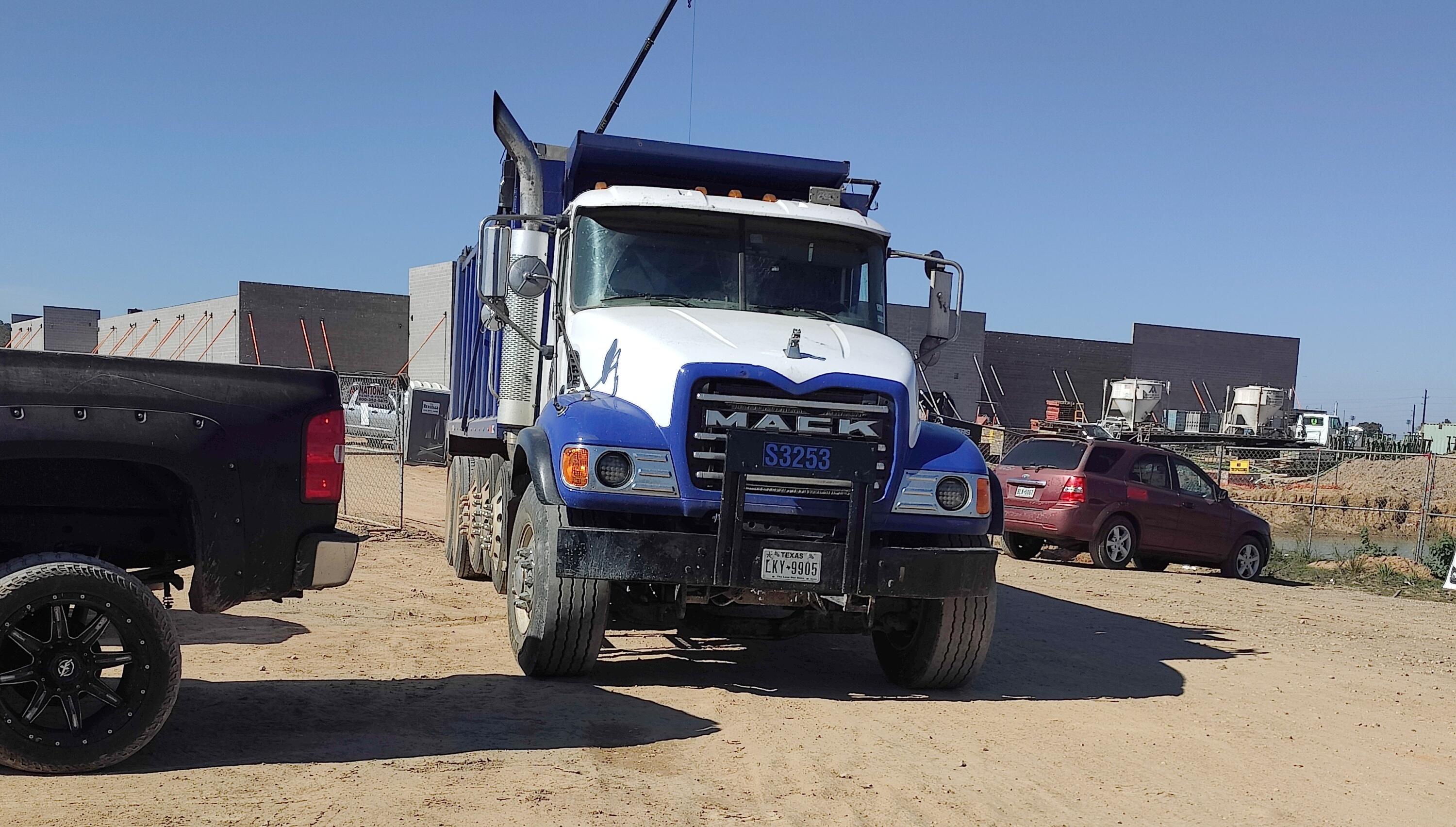

Not mine .This truck is local to me....I've seen it a couple times sitting in a lot of I10 in channel view,tx.. thought it was cool
