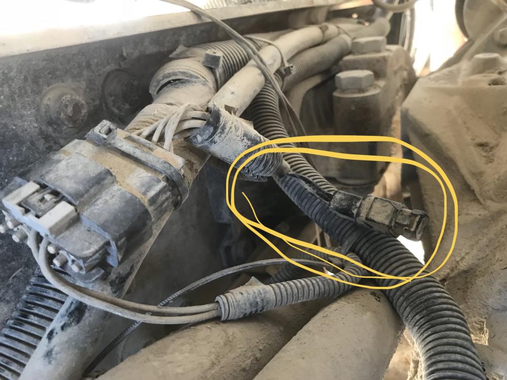

2007 CTP713 no start due to communications
96bulldogpower replied to 96bulldogpower's topic in Engine and Transmission
I’d sure appreciate any info or schematics! I haven’t had time to dig further into it, but any info would help a lot! I am also suspecting power/ground problems but have no real way of getting diagrams for this truck. I did find some corrosion at the plugs on the epdm by the driver side kick panel/firewall inside the cab, I cleaned the plugs but it made no difference. -
