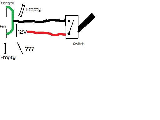

I just installed a toggle switch (non oem) into the fan clutch override connector and hope that it doesnt effect any other operation. I tapped a switched 12v into the jumper(green) wire that came installed in it from factory. I want it to act just like the factory switch is in..... This is what i did. Is this how the oem switch works?... Or does it block the Control and only transmit 12 volt to the fan terminal when the switch is on?... and what is the "???" terminal for? If nothing else i could use a vin from a truck with an electric fan override switch. I did read where the fan should stay on for X amount of time after the override is shut off, and so far it does that.

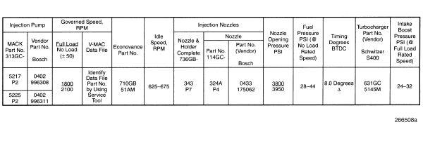

your engine at 1800 rpm with the jake on high(with s3b or s4d turbo) should be building more than 7 pounds of boost according to the mack manuals. My truck that was factory at 400 hp( has a different turbo than yours) builds up to 14 psi with jake on high at high rpms.... max boost under load 28 to 35 psi(keep in mind my truck is chipped with a blixxton power module)..Your boost on load is perfect. 97 e7 @427------- 24 to 32 psi. Thats right out of the mack manual.
