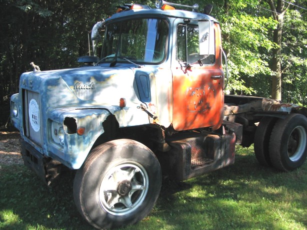

  1. All was going well. I removed the dump body (it was in poor shape) and then I was going to install the fifth wheel. Well then I decided that I should address that frame crack and as long I was there I should...... I think I blacked out then, when I came to this is where I was. I think the cat had somethig to do with it. Hopefully picture will attach. I will try to add others to my gallery. Chuck
