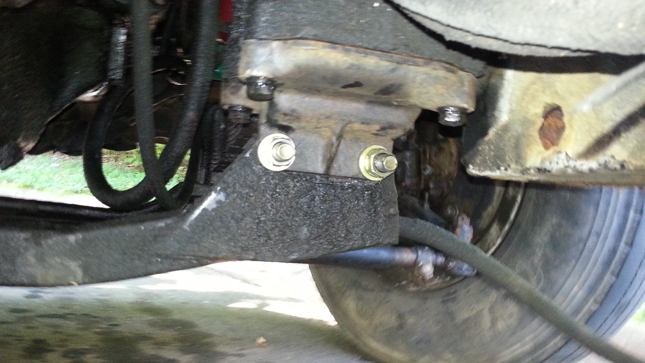

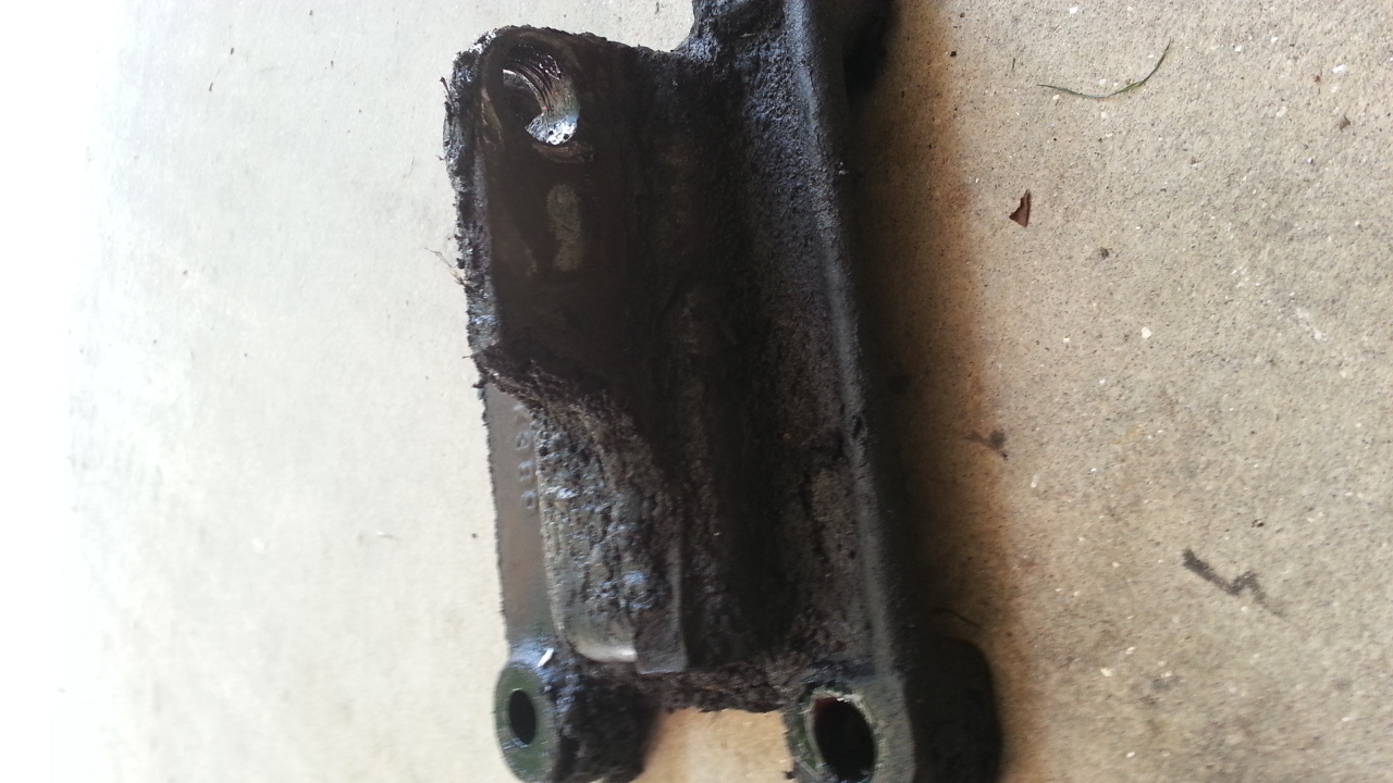

  18. Here's the reason I needed it replaced, and here's the "new" one in place.
