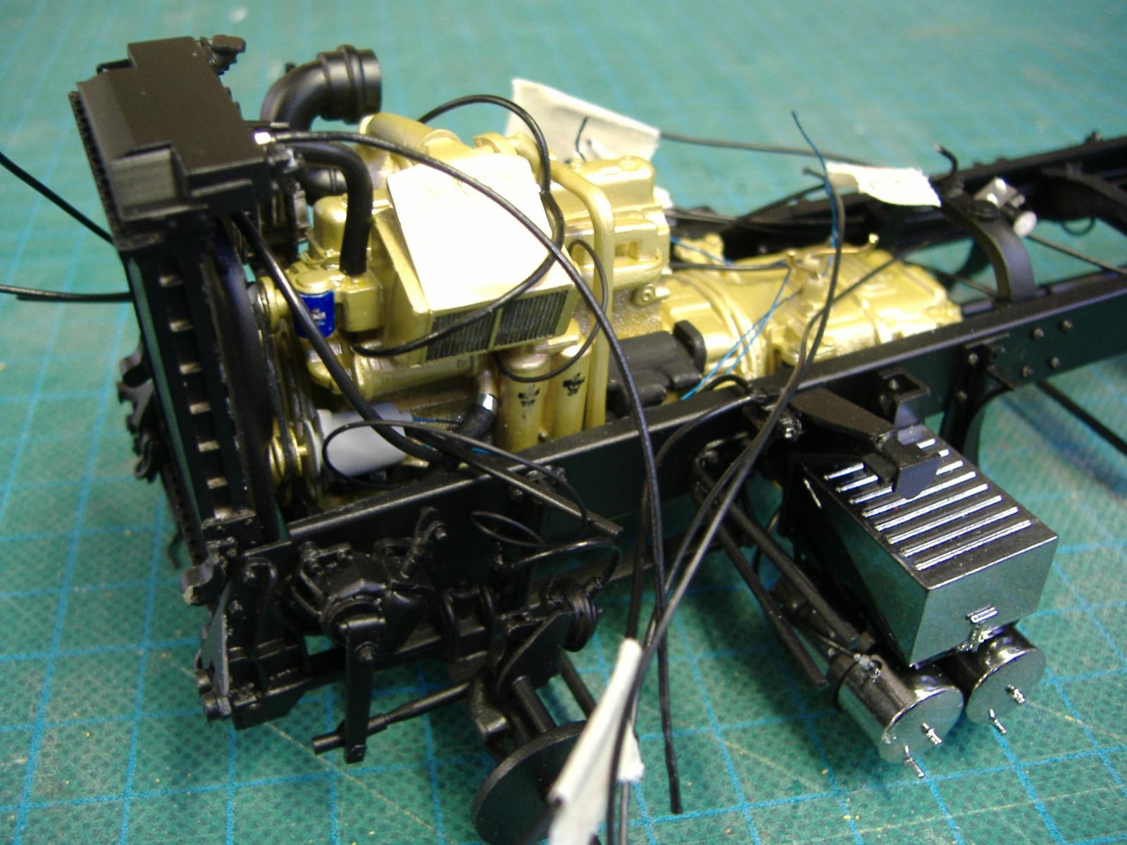

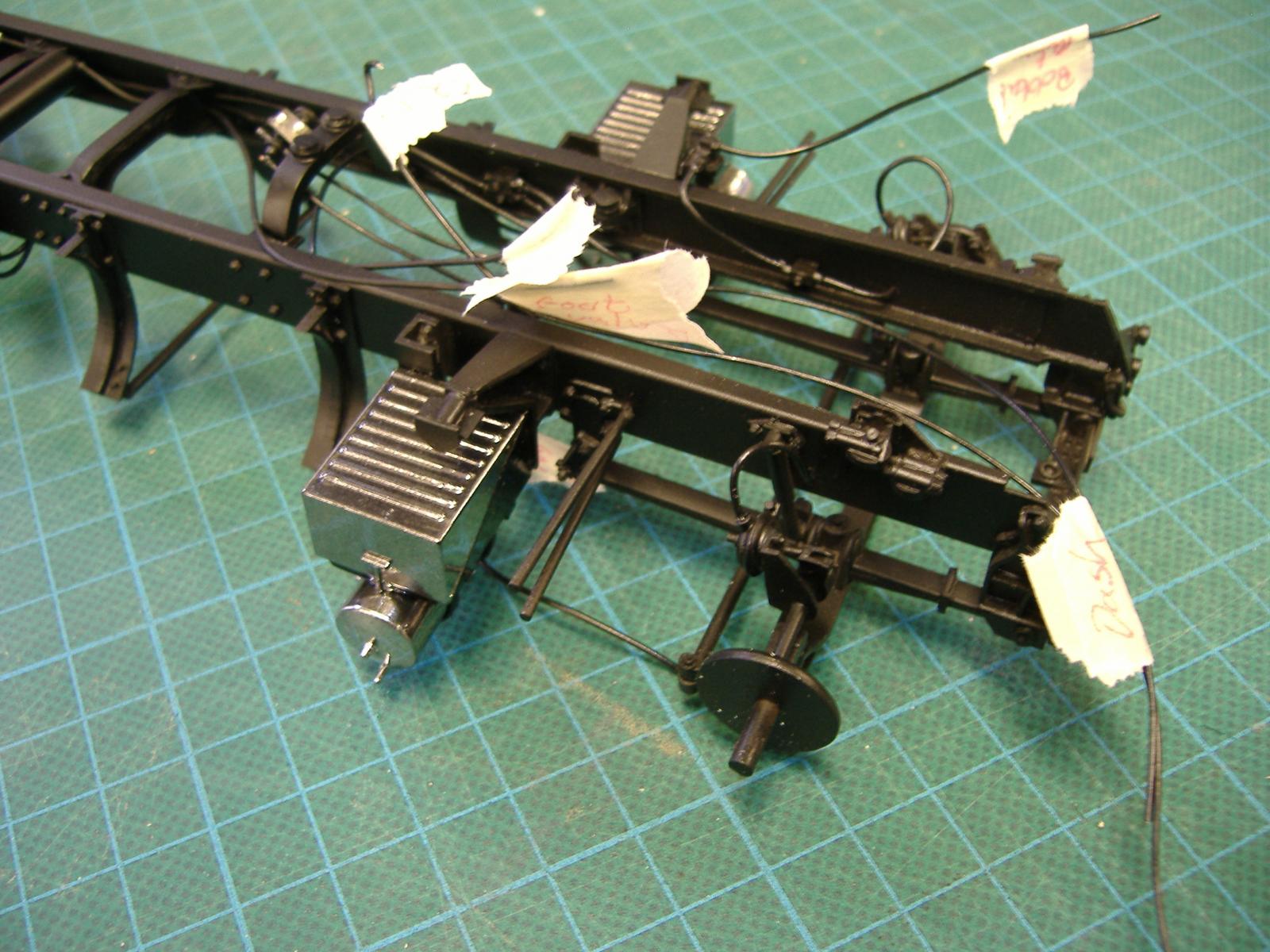

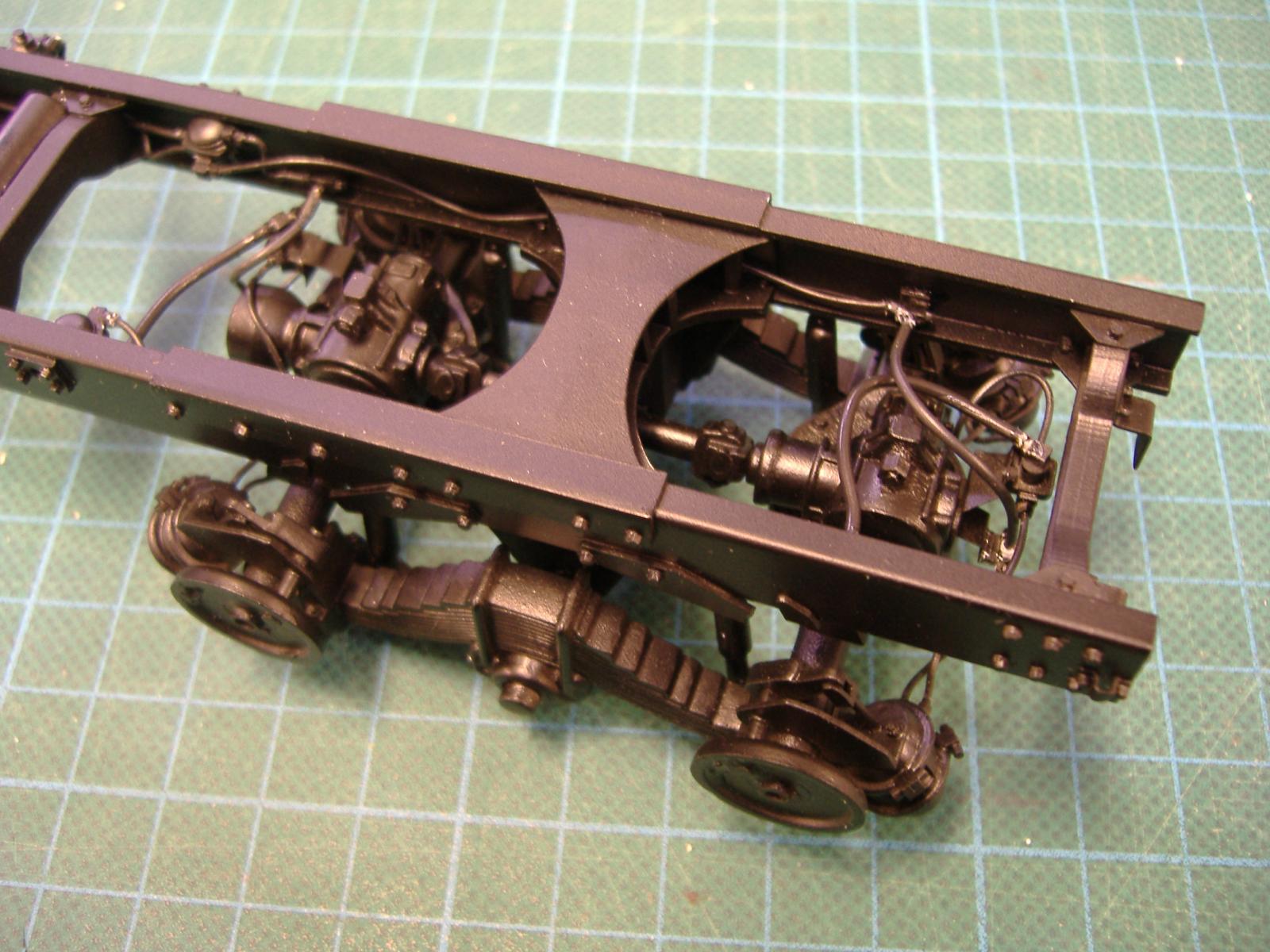

Thankyou. You always come to the rescue with my numerous requests! I'll go for the setup you descibed. I think early valueliners probably had a lot in common with the late model RS700's and over the bell housing sounds like a more direct route than under. One question leads to another though. Where does the trailer electrical hook up go to? I was planning on putting a socket near the tractor protection valve on the crossmember which holds the cab but where would this run back to? I've dug out a few pictures of progress so far although I've since put the fuel tanks on. The cab and hood are all done too but I haven't taken any pics of them yet. I'm on a bit of a deadline now as I entered it in a show in June so I have to get it finished! Thanks again! -
Hi, I need to do a bit more research for my scale model 78 Valueliner. I'm not going to get into replicating the entire electrical system but I wanted to at least put in the battery leads but I don't know where they go to or how the batteries on either side link up. Can somebody help? Thank you.

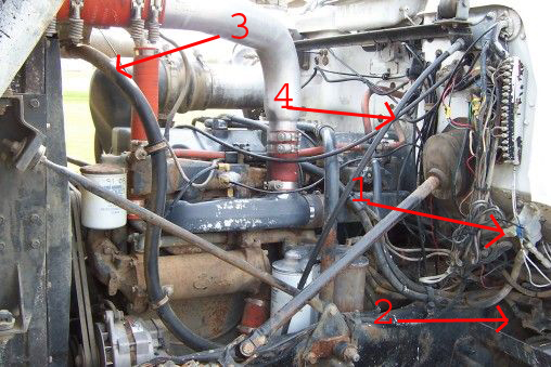

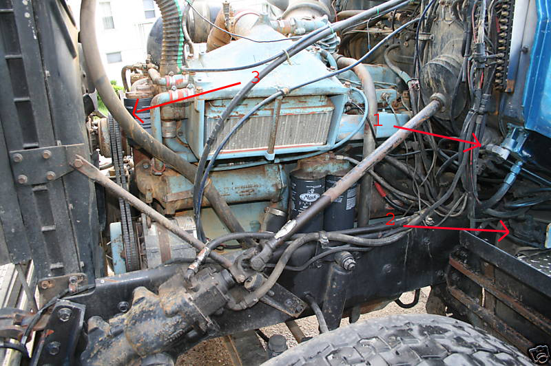

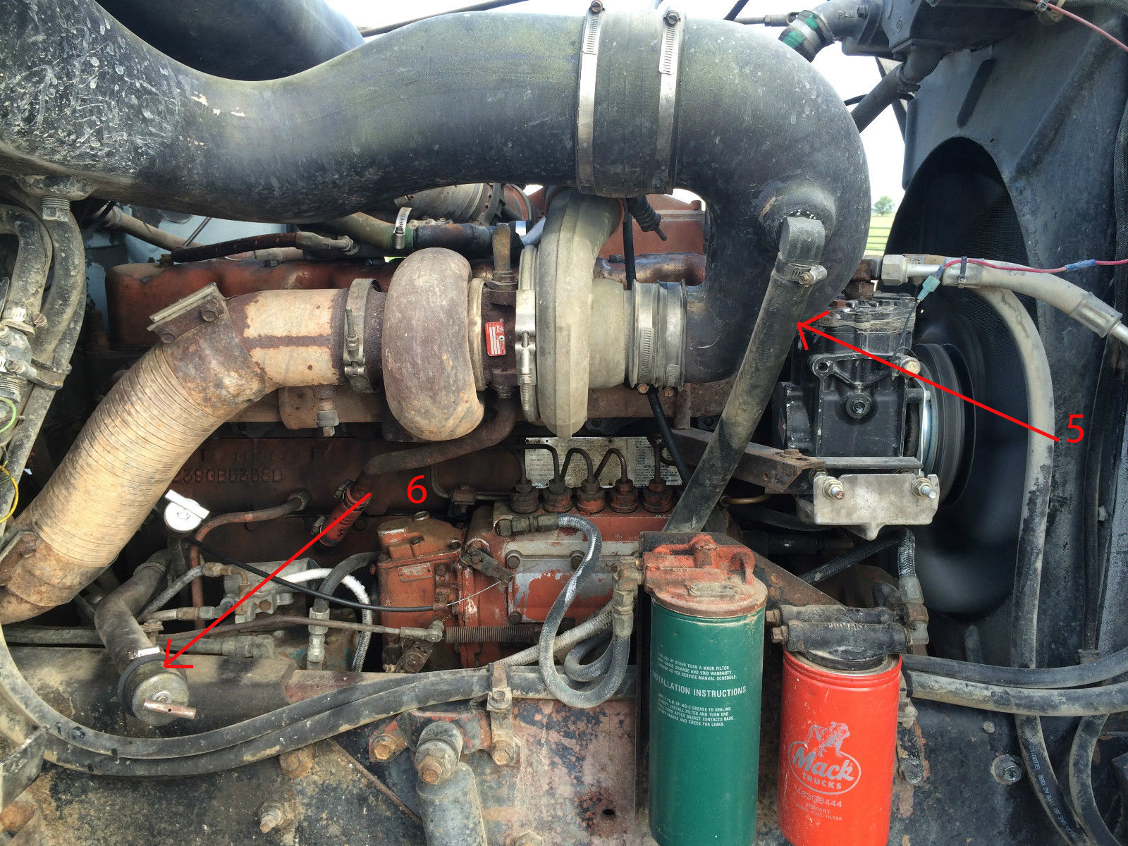

Thanks again. I've just been poring over a bendix catalogue and I think I've got 1. it looks like a front axle ratio valve. What does that do? I've got several air system drawings for 3 axle trucks but can't see one of those. Trouble is, they are all different so I think I'm going to have to make a lot up when it comes to putting in all the lines. lucky it isn't a real truck! Also, do you know where the air dryer goes? I've looked at loads of photos but cannot see one. Thanks.
Thanks for that info. Does that clutch cable loop round to the side of the clutch housing? I've got a slightly better resolution picture which gives a better view of 1 and 2. I think 2 looks like a quick release valve but I don't know about 1. There's also another pic from the other side with 5 and 6 labelled (5 is the hose coming of the intake pipe). Could you tell me what these are? Thank you.
I was hoping someone would be able to help me identify the numbered parts in the picture attached. It's for my Value-Liner scale model project but it looks like the layout is the same for early Superdogs as well. 1 and 2 look to me like brake valves of some sort but I don't know exactly what type. 1 seems to be attached to the cab footwell and 2 is mounted on the cab mount. 3 is a hose coming out of the underside of the radiator top tank but I don't know what it does or where the other end goes to. 4 I have no idea at all. Any help would be appreciated.
