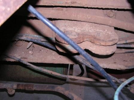

Im still curious about the gearbox setup in this one of mine. There is a set of Mack rear trans mounts about 4'6" back from the flywheel housing that I cant work out. To far back for a maxitorque and to close for an aux. The picture isnt very clear but you can see the mount.
Barry
HI. Barry I will take a stab in the dark about the mountings. My R 600 mounts 12515 R/R are 6" from flywheel housing R/R is roughly 3' 6" long to centre of uni. The maxitouque box without splitter aux would be a bit shorter. 4' 6" would be close for a aux box. The 5x4 spicer setup would come close. The jackshaft was not very long just a couple of yokes and 2 or 3 inches of tube. I will try to find a piccy of a Brambles B model fitted with Quad box and Spicer 4 speed aux. Mark

After my post this morning I got underneath with the pressure cleaner and blew a heap of crud out and found a second set of mounts further back !
Identical to the picture you posted of the Spicer auxiliery so my question is answered. Two sets of mounts about two feet apart.
Now could be the hard bit though, finding a 1241-C spicer box shouldnt be to hard but the mounting brackets on the box could be difficult.
