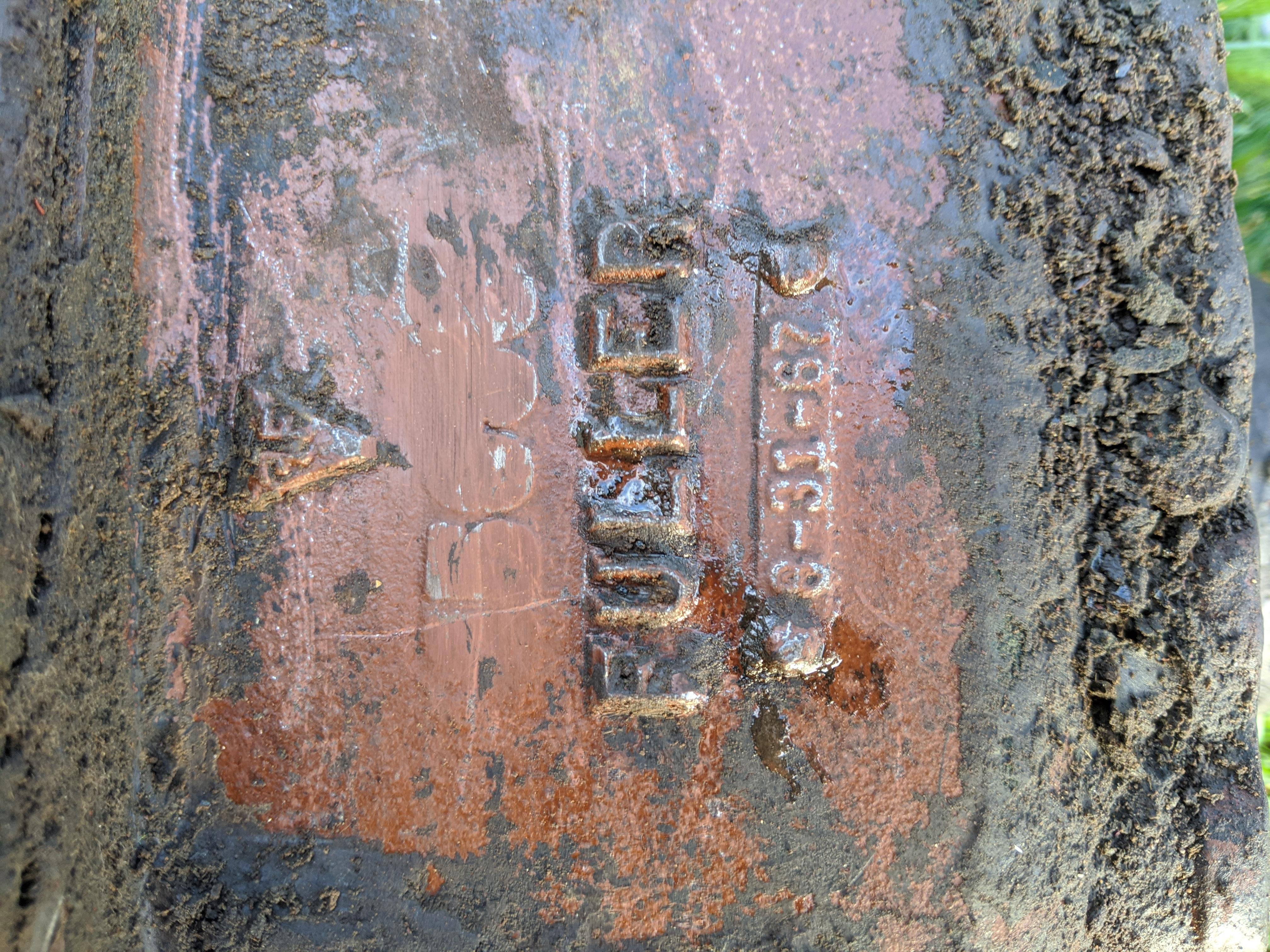

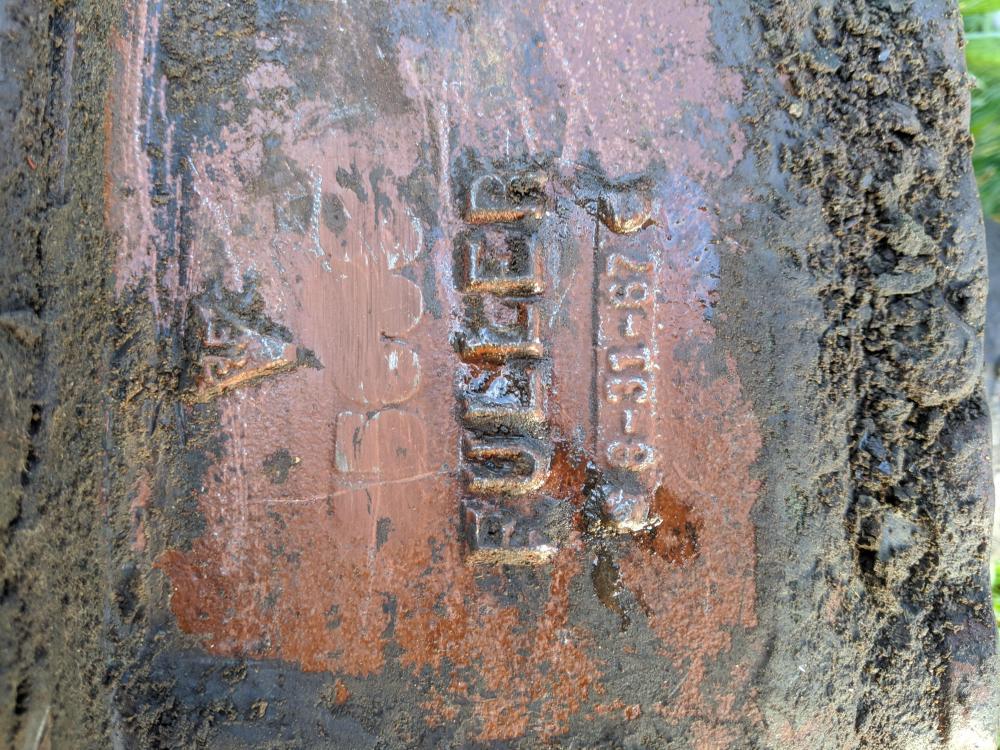

So I recently picked up a 1160 cat with a fuller transmission but I can't find the Id tag all I have found is it says fuller on the top of it in the casting, underneath fuller it also says 8-31-67.
Any help would be greatly appreciated thanks
Edited by Zack88b
To add picture
