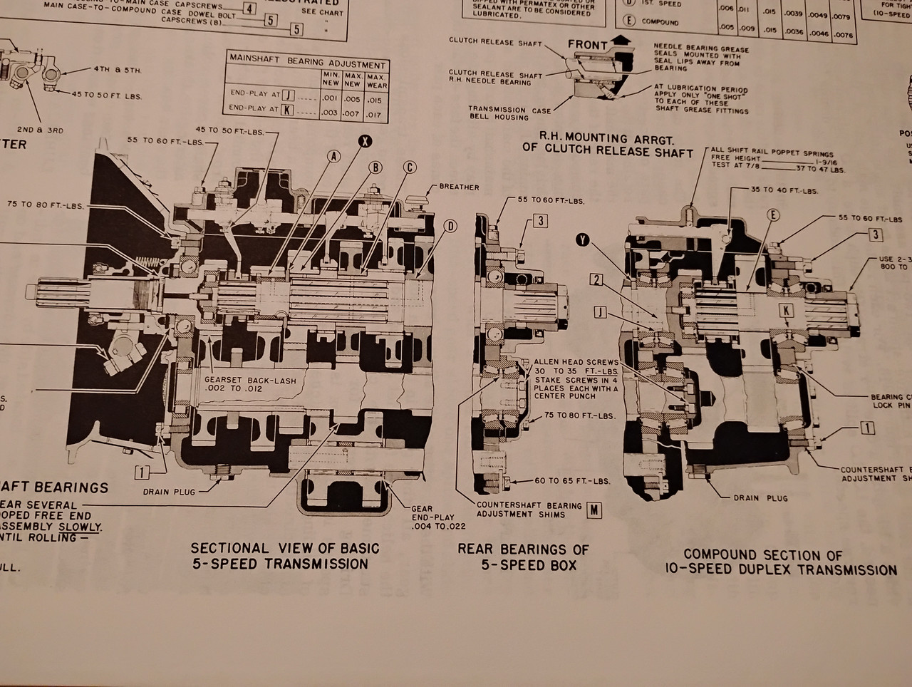

I have a ‘58 B-61 with a duplex transmission that wants to hang up in 1st gear.
I suspect it’s a worn detent/ball.
Does anyone have a parts manual with an exploded view showing the 1st detent area ?
Would appreciate a pic of the page(s).
Thx

This is all the old Mack manuals show.
No other details, just specs for bearings and such.
I rebuilt my Triplex using similar picture and the instructions in the book.  I made three videos showing the process.
I didn't mess with the covers as they were not an issue.
