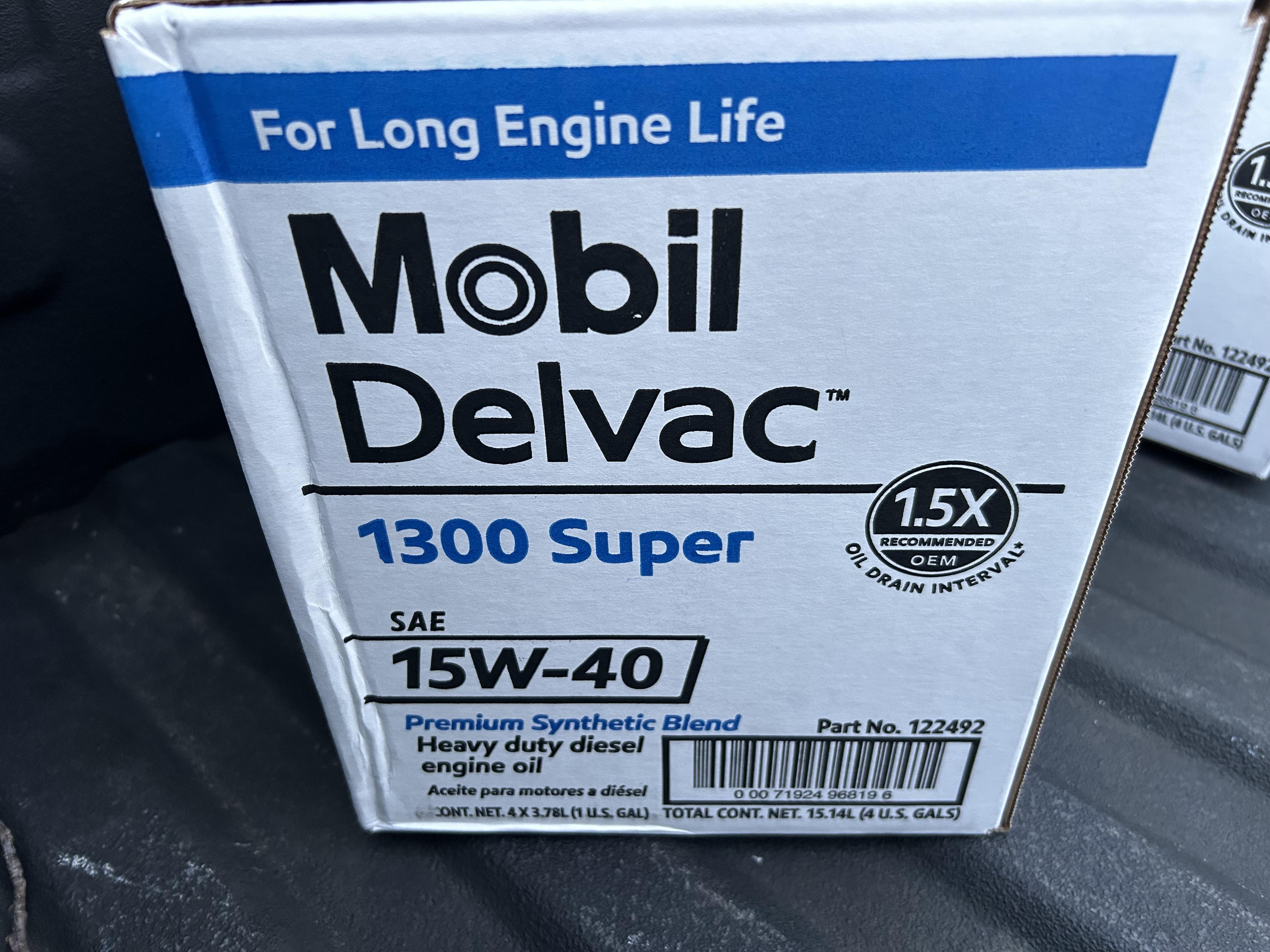

How about series three 15-40 I run it in my old Mack the 31 and 32 fords and both tractors more useable in cooler temps. Back in 1973 I was in Caterpillar engine school, and we had a course on oils I asked about multigrade oils and the teacher had a little fit over me asking back then 30 w. in the summer and 10w. in the winter times have changed and 50w. in the trans anymore I think it was in the late sixty's dodge changed to autotrans fluid in their standard three speed trans I know for certain.
As far as Power steering, it depends, on what gear you have. Sheppard takes 10-40 motor oil as per Sheppard.  15w-40 has been the oil of choice until recent engines.
Trans depends on what transmission. Look to the manuals, for the last word.
