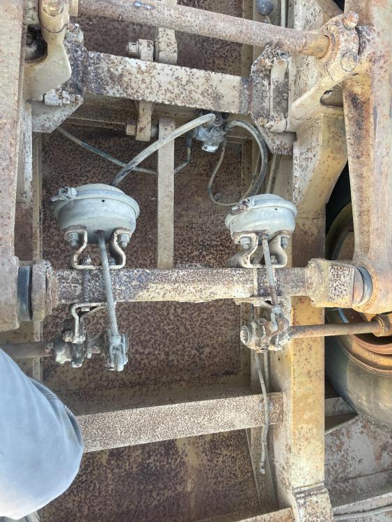

Coupla things, screw clamps on rubber air lines are not permitted. No way "one is fed from service the other from supply". You've got to get what you have legal before trying to add spring brakes. Without seeing the whole air system, I can't tell what is buggered up and what if anything is correct.
What I can see from that one picture will get you shut down in a heartbeat. You've got kinked copper line.
I would correct the  defects that will get you shut down. I towed many trailers without spring brakes (I was a heavy hauler) over the years. Once the system is correct, you can see if there is enough room to add what is needed for spring brakes.
Also need to correct what is wrong with the RH S cam bracket, the push rod is not inline with the slack adjuster. It looks like something with the slack adjuster bushing isn't right, preventing the can as push rod from being properly in line.
everytime I look I see more wrong, right chamber fully extended, left chamber fully retracted, what the heck is going on there? Stuck or air to one chamber only?
Edited by Geoff Weeks

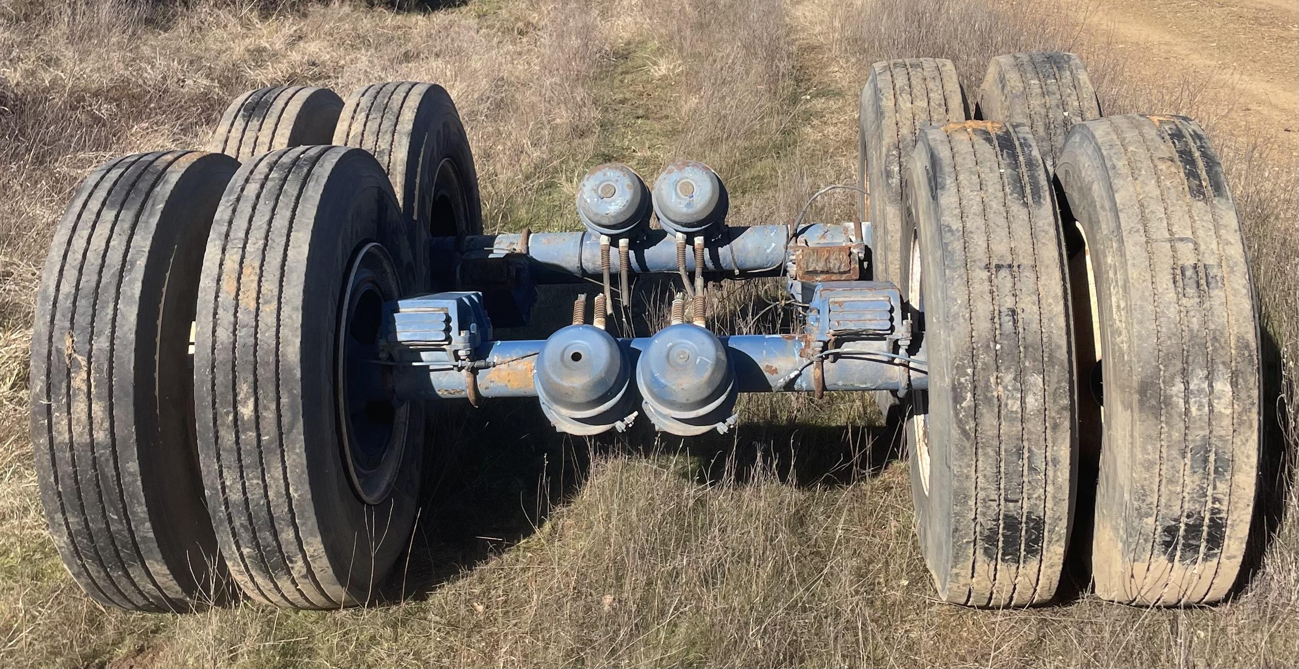

I really don’t know what the previous owner had going on with the brakes. I’m going to cut those axles out and weld new ones in. And will also put new air lines in. This is really just a trailer to haul my trackhoe and dozer between farms. But I want to make it as safe as possible.
I just thought it may be easier to buy one of those tanks with the valves attached and mound it inside the frame.

I don’t think there is inherently anything wrong with the current axles. But I also haven’t tried pulling it with it loaded. All 8 tires are no good is the issue.

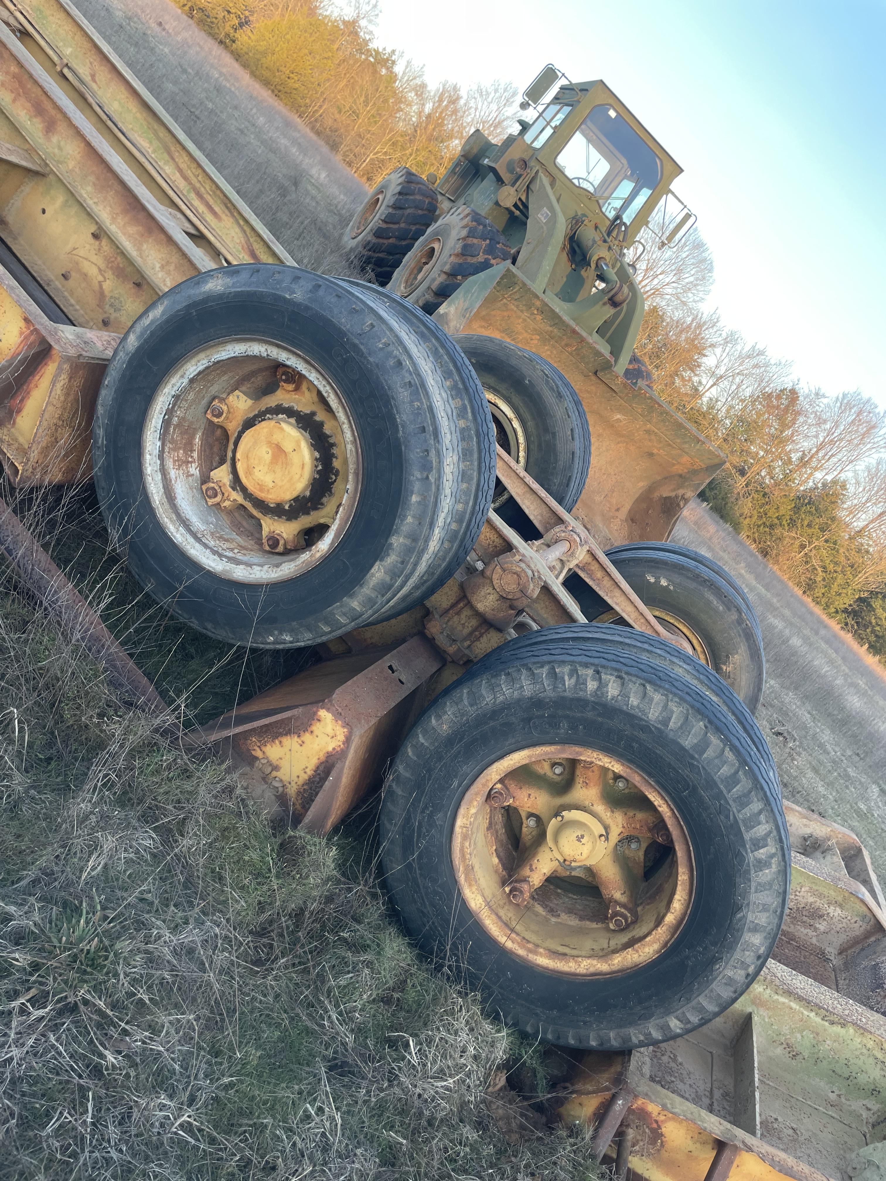

I don’t know the tire sizes off the top of my head but they are the same height off the ground to the top of the tire. The newer axles and tires came off an oilfield trailer. I have enough space between the brake hardware to mount the center bracket for the walking beam suspension. Someone before me has already replaced one of the axles. As it’s not the same as the other you’ll be able to see in the picture.

Those look like 20" rubber not the 15 that most lowboy's from that era had. 9.00x 20, You can mount tubeless demountables on there 295-75-22.5 would be the same OD or you could go smaller 255's which would lower the deck height a bit.
I think I'd start by assessing what is there, and how well it is done.
If the axles are installed in alignment with the king pin, I wouldn't change. If it was scabbed in and everything is out of alignment, then you are going to have to cut it out to align anyway. Alignment is done by how the brackets are welded on. Everything will be "floppy" until welded, and you better get it right.
One looks to be "Propar" axle and one looks to be a axle where the spindle is smaller for the outer bearing.
One thing I see in the latest picture that concerns me: Will the tires clear when the suspension is tilted to either extreme?
It looks like they will hit when the rear is compressed fully and the front might hit when it is compressed fully.
Better to find that out now, rather then after you do all the work. It wouldn't surprise me to learn it had 15" hubs on it from the get go, and someone changed without checking clearances.
New axles with 12" brakes and 17.5 tires would be the modern equivalent. I did one axle job on a trailer, measure 4-5 times and weld once!
Check the clearance 1st. The tires you have on there now are equal to lo-pro 22.5 in diameter, if it hits now, then really the only choice is 17.5 which take a different brake set-up (12.25 x 8 drum) S cam and bracket. Most cases you can't just swap hub and brake spider, as the spider is welded on.
Going off road, you know those axles are going to have to pivot to the extreme going over rough ground. Better to know now rather than do the work and get stuck or tear up tires.
I've not see a early low boy like that with anything other than 15" hubs (which will take 17.5 tubeless "adapters")
Set up with new axle and hub pilot 17.5's would make that a good trailer if the rest isn't all cracked and scab welded.

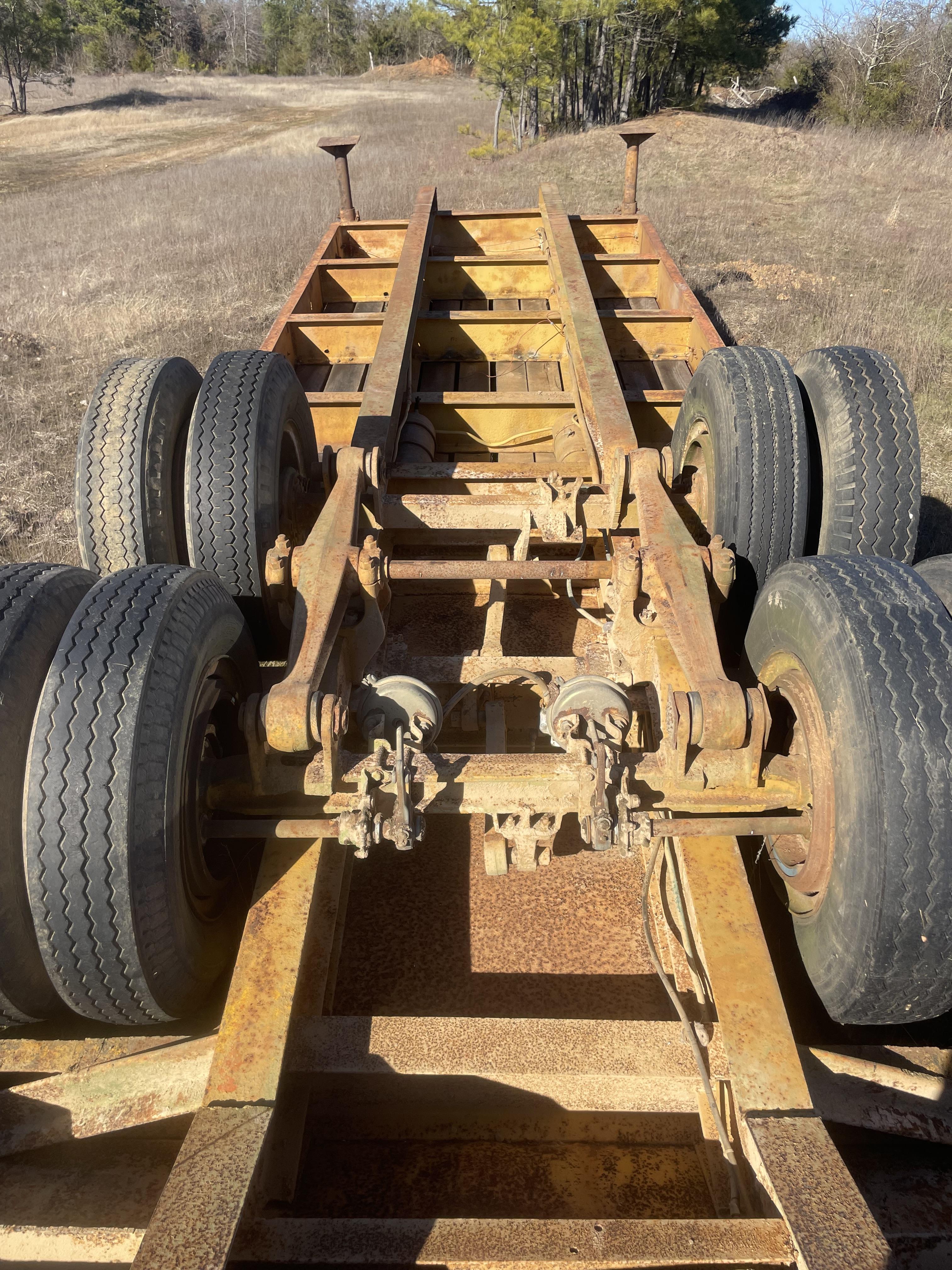

Can you provide a photo of both axles and we can see better whats going on
So like this but showing both axles and braje assembly's
IMG_3419.thumb.jpeg.e24ae00a59080a475dded4238b566767.jpeg.3ed6ebaa9c6a8b033be981bba9ee6a4e.jpeg
And a photo showing a lot more of the trailer length ways like this one but showing a lot more front ways as well
IMG_3420.thumb.jpeg.079cdfa8576f761c2b97bd11f5049f0f.jpeg.d585c881dea94fa4d5217b7bf8e33090.jpeg
Sort of hard to tell what has happened without this type of basic information
At first glance it looks like axle was changed but maybe just a couple of hubs, maybe brake shoes were made of unobtainium so different hubs were popped on a axle to get more common shoes
Maybe it did have 20" wheels from new, however I tend to think Geoff is more likely right with 15" wheels
A lot of maybes and I'm a bit to much of girly man to offer any advice on brakes and axles with out more information
They (brakes and axles) are far to important to be guessing my way

The new tires are only 2” larger in diameter than the old ones so I should be fine as they are after doing some more clearance measurements.

This is the only photo I could get to upload. Getting an error -200
Edited by Jizzo17
well, I don't see any brake chambers on the front axle. That is not legal either.  Time to fully assess what you have and don't.  Law is brakes on all axles, functioning and plumbed with DOT approved fittings.
Where you are now is no where near legal, and "upgrading" has to take a back seat to getting legal.

Pretty much, nothing on the front axle and one S cam on the rear all the way out, and the other???
definitely only one axle brakes. the valve mounted on inside of cross member shows only two rubber air lines coming off. the feedline must be brass looks to have a major kink in it ; bet those brakes were slow reacting. I'd say the one brake with "offset" push rod is missing a snap ring! if that was the only failure on this system.!!! the "new" system is greatly up dated ;but I 'll bet on a clearance issue with the 30/30 cans. 24/24 might work if they are even available any more. had customeryears back had a martin lowbed similar to this. a real P I T A
