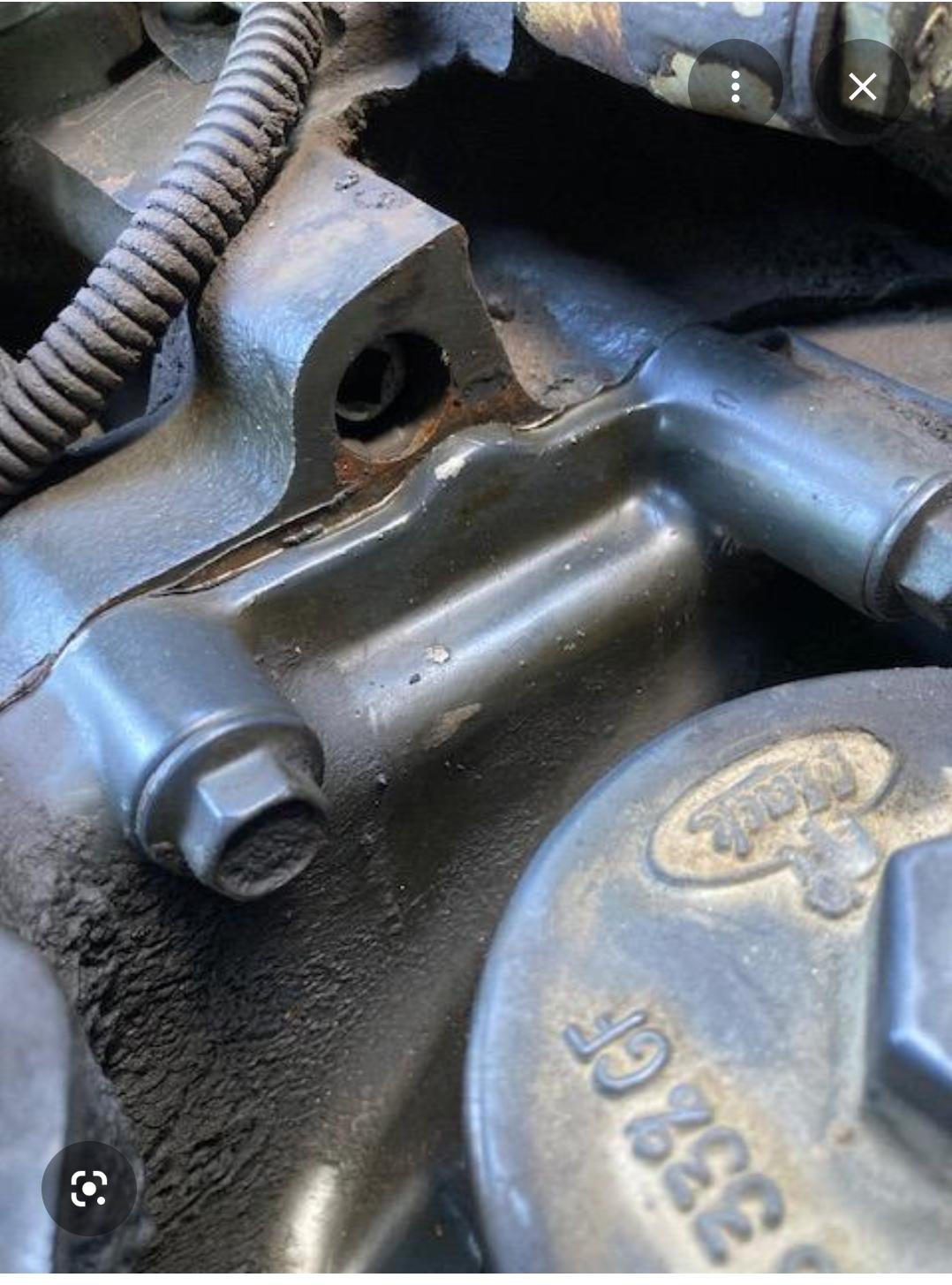

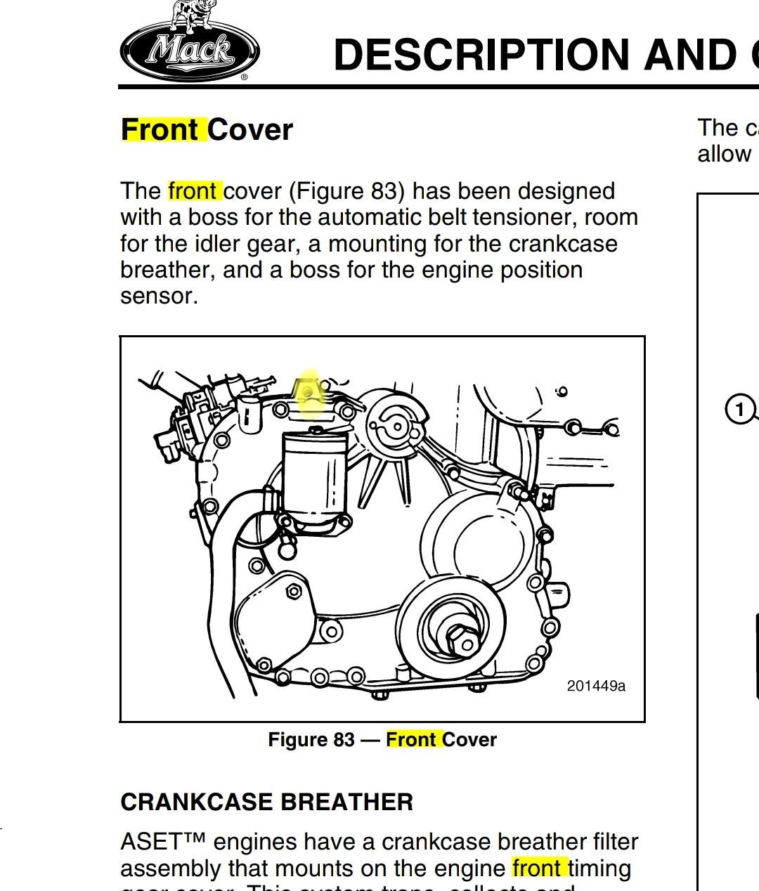

So hear is some more ignorance on my part I haven't found a port to check pressure so do I take the return check valve out and tap in there
There is a 1/4" pipe plug behind the overboard breather. You can tie in there, if the plug wants to come out, or you can 'T' into line going in to the block below the #4 cylinder...
