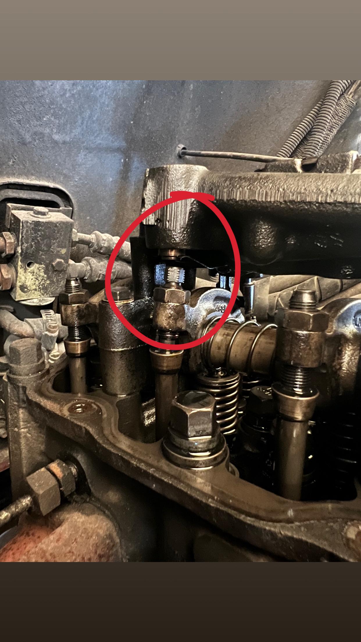

I had a guy send me the procedure from the book. Sounds like .080” for mine if that sounds right? Mine is a 94 e7 350 horsepower. And yes mine is the 680. While we’re on that subject, these are horrendously poor performing. That’s part of the reason I’m tearing into it as it kinda sounded like only half were working. Haven’t gotten that far to troubleshoot that yet but noticed this gap between rocker stud and the trigger piston. This rocker is at full motion. Is that large of a gap normal? Only other one I’ve messed with is one on a 3406 mechanical and if I recall it has a lot closer contact. Like it would push the trigger piston in flush with the housing. If that’s not normal I could see that affecting performance
The gap looks large, but likely correct. The E-7 on into the E-TECH series have terrible engine brakes.  They Suck!!! Dont loosen any of the set screws before checking lash. Make sure the engine is under 100 degrees or just plain cold.
That big gap between the Jake and the valve adjustment doesn't mean anything. When the Jake is activated the master piston comes way out of the bore and closes that gap , so sitting there without the engine running.....it looks kinda like it might be a problem.  The Jake may need a tune-up kit. Lots of times when they get older the little control valves in the Jake are worn.  A 350 ?   I wouldn't be afraid to open the Jake's lash to 90 thousandths ( or a little more even ). This is all of course after determining you don't have a bad solenoid  or wire off or oil bleeding off somewhere else.
Sure is on all counts.  Screw it, check lash, add the .010" like you said Mark, and down shift more.. it ain't worth taking it apart..  i have a pair of 680 heads in my shop. There might be some usable parts for him when he takes them apart and says ,,Ohh Sh!t... Now what do I do?

A rebuild would be good, but at what price.  The last one i did was 4 years ago and it was a thousand dollars for the kit.
wow. One for my cat was $2-$300 I’m pretty sure. It looks like nearly identical to this one

The control valves might be the same. Sometimes when you go to change them you discover broken springs holding them. Sometimes the broken springs sneak out under the cover too.  But ??? they're a problem if those valves are bad.
