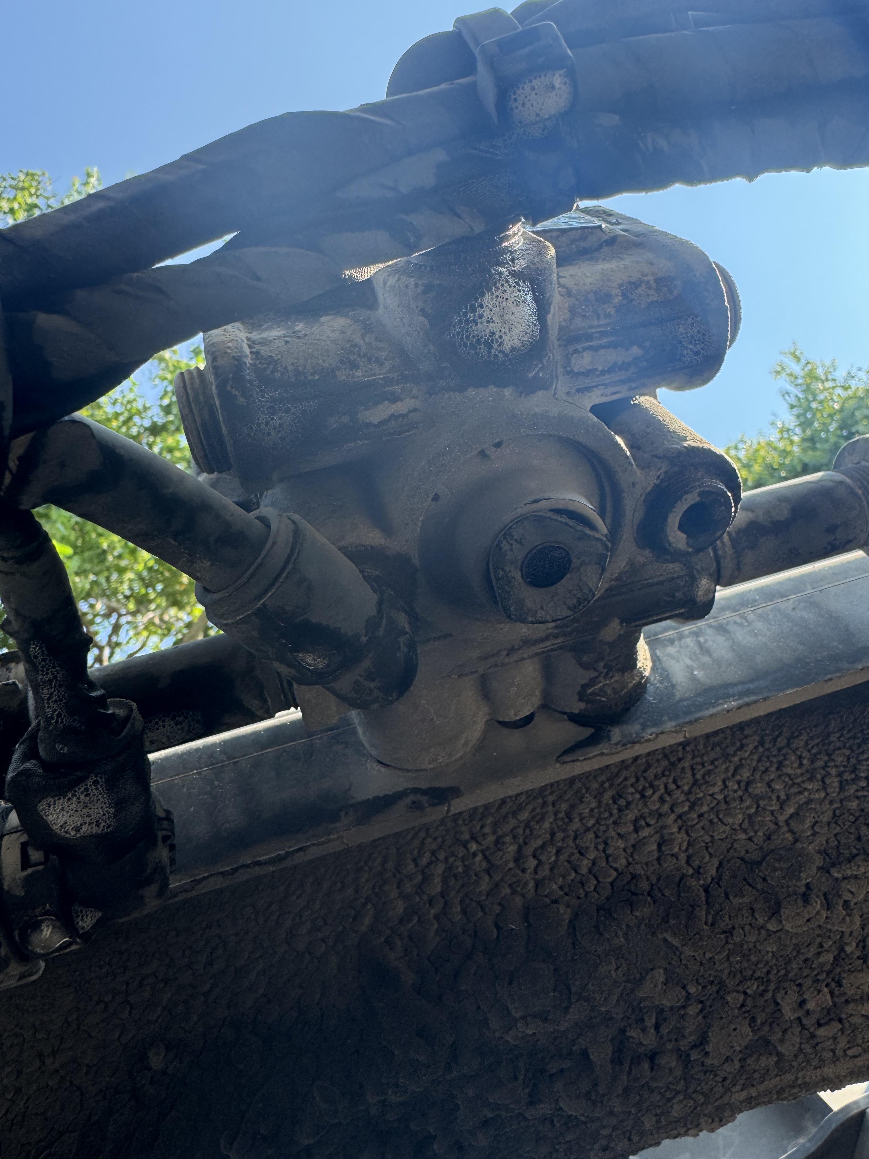

Is the data tag still on the valve? You may just have to remove it to I.D. it. Mechohaulic makes a good suggestion. At $600.00 i would take it apart and inspect it and clean it, and try to rebuild it. Is the air system Bendix or Wabco?
Bendix

8 hours ago, 67RModel said:
Did their price include installation or was that just for the part? Mack might be asking double what its worth. Get the part number off of it and see what one can be obtained for from an independent supplier.
Just part. Part# on the valve is Bendix T-5019505

3 hours ago, mechohaulic said:
noticed no one questioned WHEN is the valve leaking ;; constant (shouldn't be) ; during service brake application or after service brake applied and released? might make a difference where the hunt starts.
Constantly no matter brake apply or release
being a constant leak WITH  parking brakes set; I'd go with earlier post I wrote and look at the lower section of that valve. if you have a "helper" a quick check would be to BLOCK the wheels safely; release the parking brake unit having full air pressure and truck shut off ; have someone have their hand on bottom side of leaking valve ; helper in cab step on brake pedal; air leak changes /slows chances are it's the flat rubber diaphragm in valve. to replace bottom kit ::parking brake set ; make sure all air is drained from tanks. larger pair of snap ring pliers (also safety glasses on ) , remove the snap ring .valve assembly has slight spring pressure. important thing air tanks MUST be empty.

21 minutes ago, mechohaulic said:
bchances are it's the flat rubber diaphragm in valve.
In the link I posted to the Bendix "manual" on that valve, it is all just plain O rings, and the manual even lists the size, so you can go to where you buy O rings, and have them all before you start.
 There is a small chance that there is a small (internal) leak from the solenoid valve on the top, but think it is much more likely a piece of crud is stuck in the valve, disassemble, inspect and install new O rings. Cost would be the cost of the O rings, but if you have a good supplier, then less than $20 would be my guess.
Follow Mecho's testing to make sure it isn't some other valve backfeeding into this one.
No delivery port on that valve I can test for backfeeding. I’m the diagram there are two delivery ports but one got closed off and other one connect to other valve by metal pipe.
https://www.bigmacktrucks.com/topic/75877-relay-value/page/2/#findComment-581132
The two pipes go to ABS actuator valves then to hoses to the brake chambers, Make sure the brake chambers aren't backfeeding. The ABS valve on either side are just straight through unless the ABS is in action. The 3rd hose on the bottom should go to a quick-release on the spring brake circuit to prevent compounding (anti-compounding QR) .
Any of these could backfeed it there is a problem "down stream"  all would only leak back when the parking brake is off. If your valve leaks with the parking brake on, then it is the valve itself.
If it leaks all the time, whenever there is pressure in the air system, it is most likely the bottom portion of the valve, which can be taken out and cleaned and new O rings install by removing the snap ring (spring loaded parts behind the snap ring, so be ready to ketch them.
There is a small chance that solenoid valve on the top has a small leak, and I think that would be harder to repair/get parts for.
For the cost of O rings, I would start at the bottom of the valve, if it leak all the time there is air in the system (parking brake on or off)
https://www.bigmacktrucks.com/topic/75877-relay-value/page/2/#findComment-581133

13 hours ago, Xe18 said:
Thank you so much for all your help. I disassembled bottom half today and cleaned all the parts and greased 2 oring and rubber washer. Done no more air leaks. I will get the rebuild kit next week for backup in case it leaks again later on. Again thank you all of your inputs and saved me couple hundred dollars.
Thanks for update especially since it was positive results  not costing $600.oo
