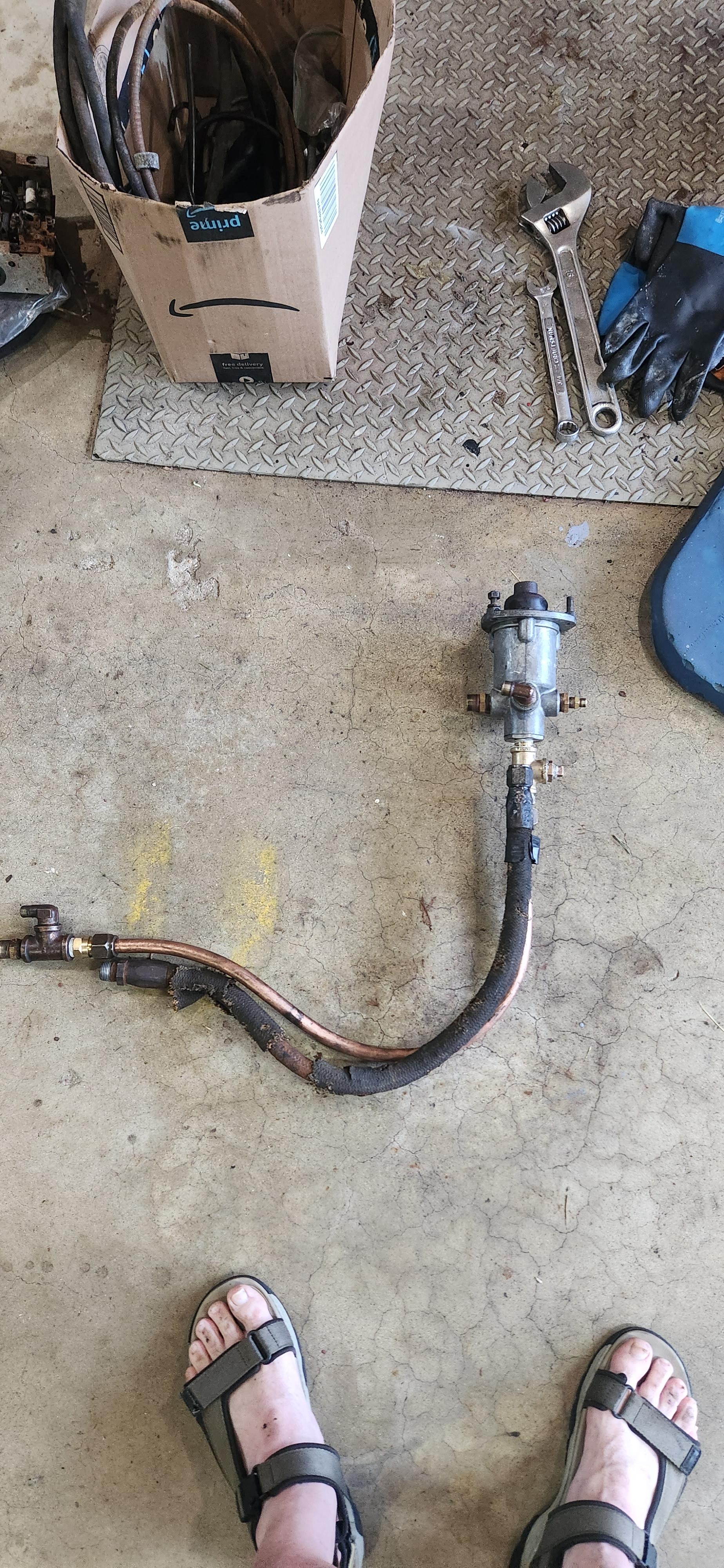

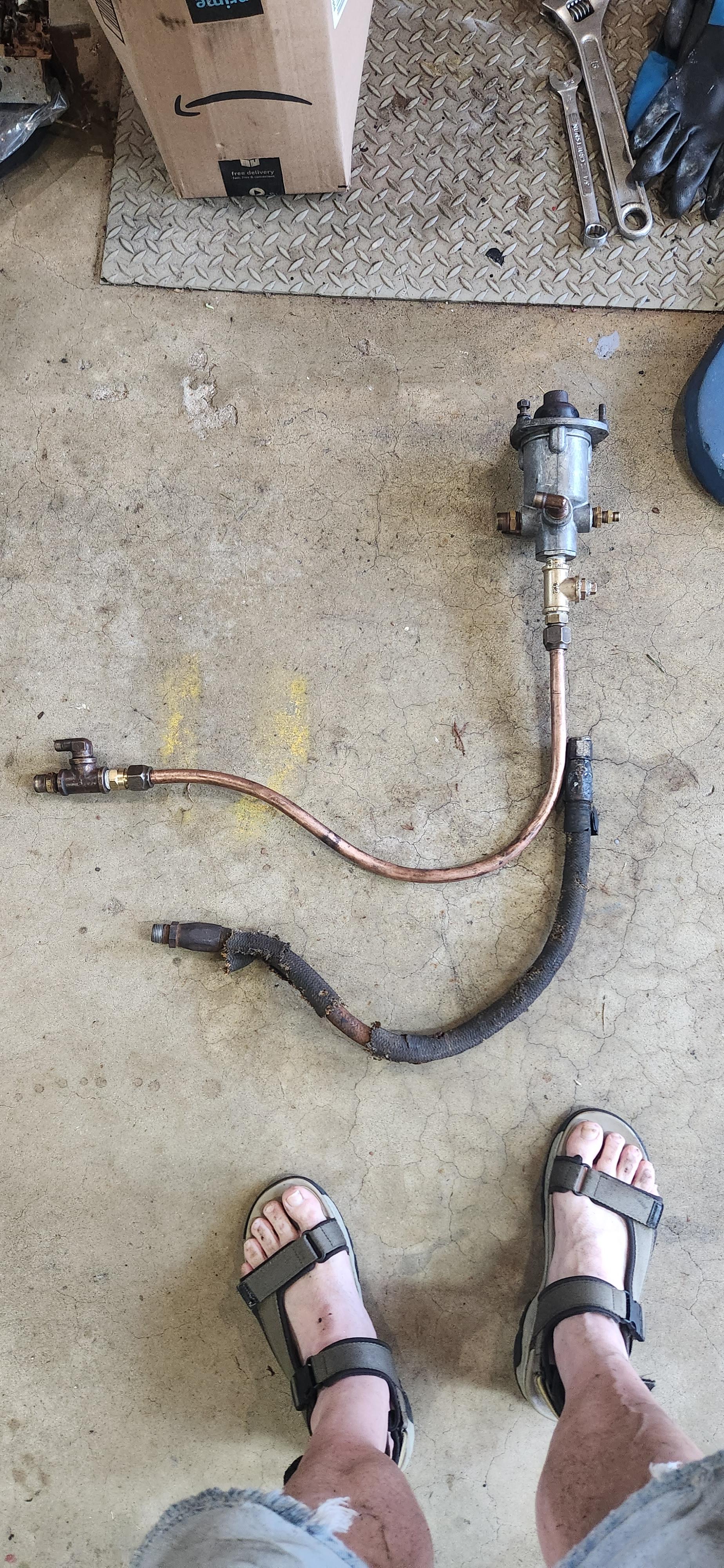

I have a question for those that know.  On our 1957 fire truck with air brakes (B85F-1211),  the treadle valve supply line is a flexible hose but all the other lines on the treadle are copper pipe.  The question I have is, should that supply line be a flexible hose,  or a copper pipe?   If you have a 50's era truck, what's on yours
The reason I ask ......  when we took the fuel tank out to get repaired,   I figured I would take the mounting brackets (J-Brackets) off and clean and paint them and the frame rails.  Well, to get to the bolts I had to push the flex hose a bunch and it now has a leak.
1-flex is there; will be easier to replace with same, 2- the flex braided (? doubt ) or rubber flex ; basically a hyd line  (#8)?  remember treadle having a rubber (hyd) line ; don't recall which position. 3- won't be seen or change originality.
