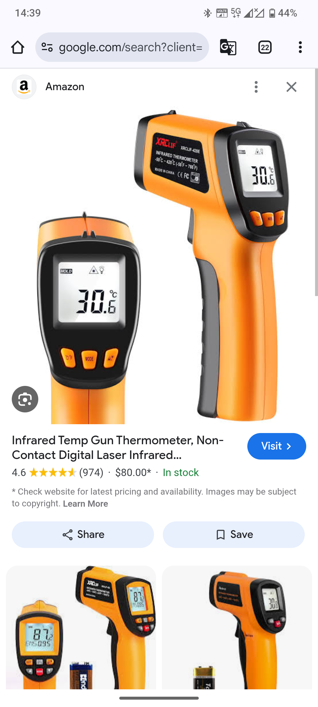

Get yourself an infrared temp gun and check the top pipe outlet to check the temp against the gauge
