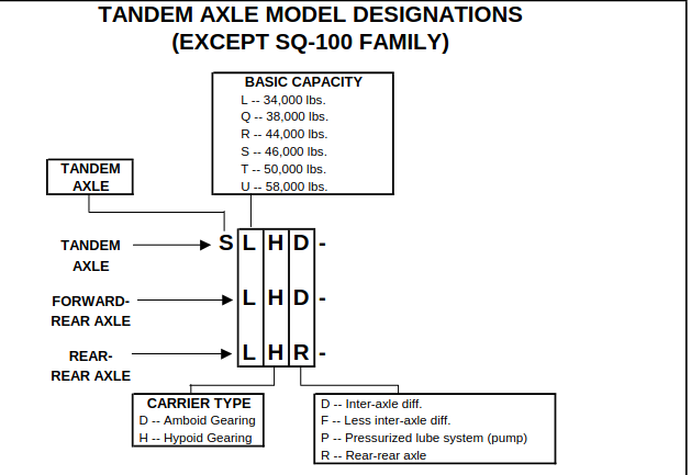

It should be fairly easy to find Hendrickson  housings with the torque arm weldment on top. Do you have SQHP, or SQHD's? By the time SQ100's came out I think the ratio switched to 3.73.
 The reason I ask, is the rear, rear is Amboid (pinion enters above the axle centerline) on the SQHP and the housing is different then the later SQ100 (which is hypoid) essentially the rear-rear housing is "upside down".

SQHD's don't have the best reputation, I know one guy who calls the "sure-quitter's". They have an idler gear between the power divider and the front pinion. Later SQHP's and SQ100's don't. They beefed up the powerdivider section and eliminated the idler gear.
They are way obsolete, Heck, the SQHP and SQ100's are obsolete. The 3.70 gear ratio is also not made anymore, they went from a 40-10 (40 tooth ring gear, 10 tooth pinion) to 41-11 for 3.73 ratio so finding gearsets (should they be needed) may be a problem.
Before making one big change that would require a lot, it may be time to re-assess and decide if you want to stay with that model and ratio or if you want a whole new cut-off, or just repair what you have.
Later SQ100 housings will not be right either I don't think, so you'll be needed SQHD housings unless you weld brackets to what you have now.
The SQHD's both pinions turn the same direction and are on the same side of the ring gear (front and back) SQHP, and SQ100's the front pinion turns the opposite driveshaft rotation on the front and are on the opposite side of the ring gear.
SQHP rear-rear is amboid (essentially turned  upside down) with the pinion above the centerline, SQ100, they went back to the lower hypoid gearset with the rear-rear pinion below the center-line.
All this means is although all the models are related, the housings can be different for the different models.
