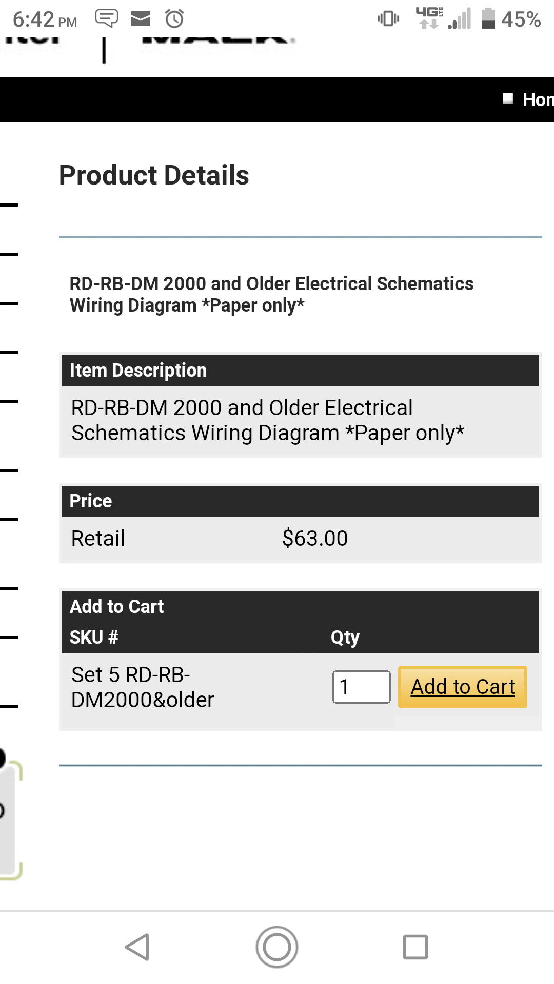

On 4/25/2024 at 7:08 PM, JoeH said:
https://macktrucks.vg-emedia.com/ProductDetail.aspx?ProductId=6543&GroupId=-1
You're looking for Mack manual 8-201, if your dealer is halfway decent they should be able to order it for you, but you can also download it for free by clicking "View File"
Thanks for that link, could be handy in the future.
