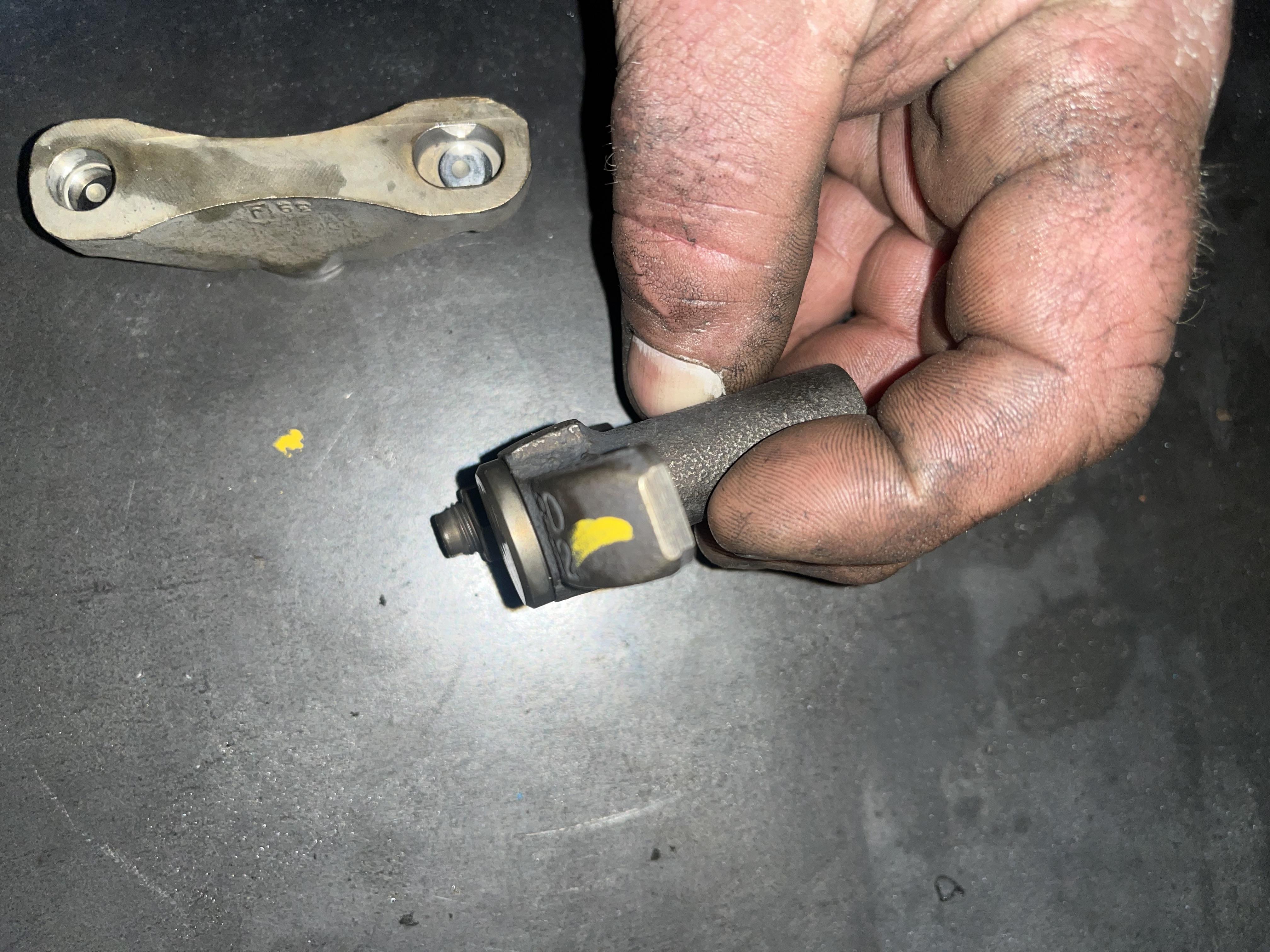

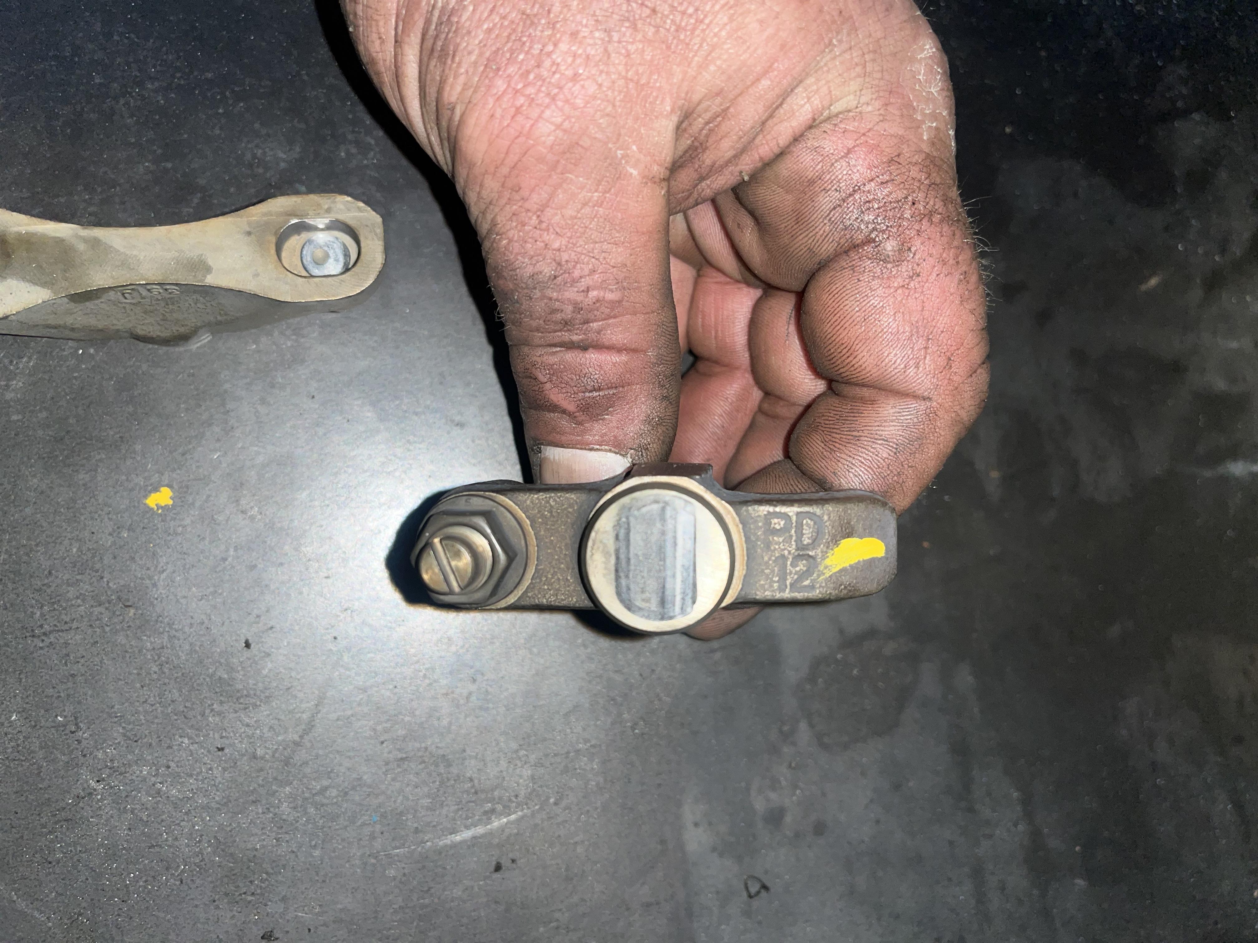

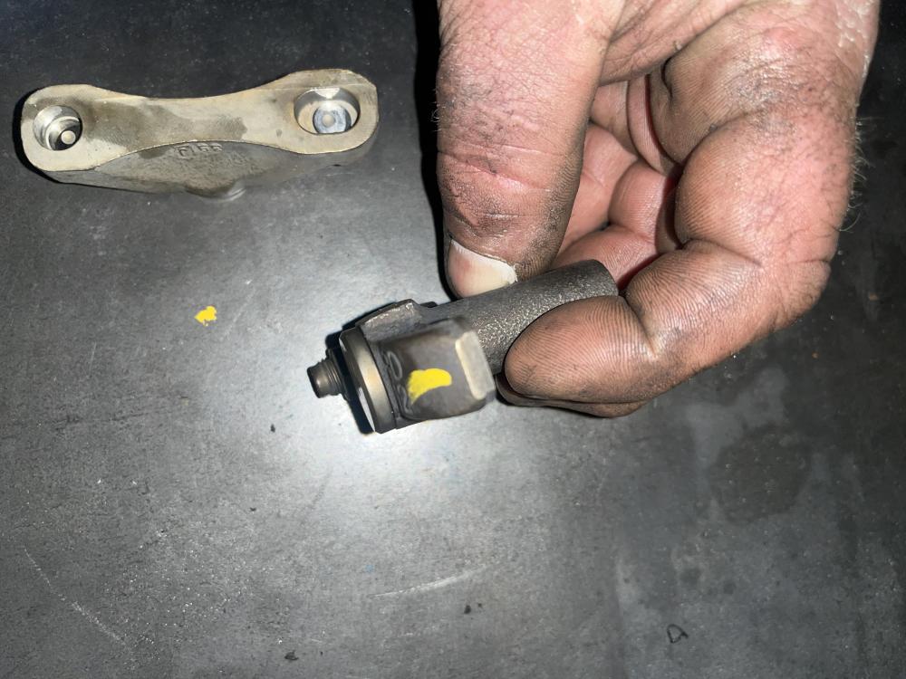

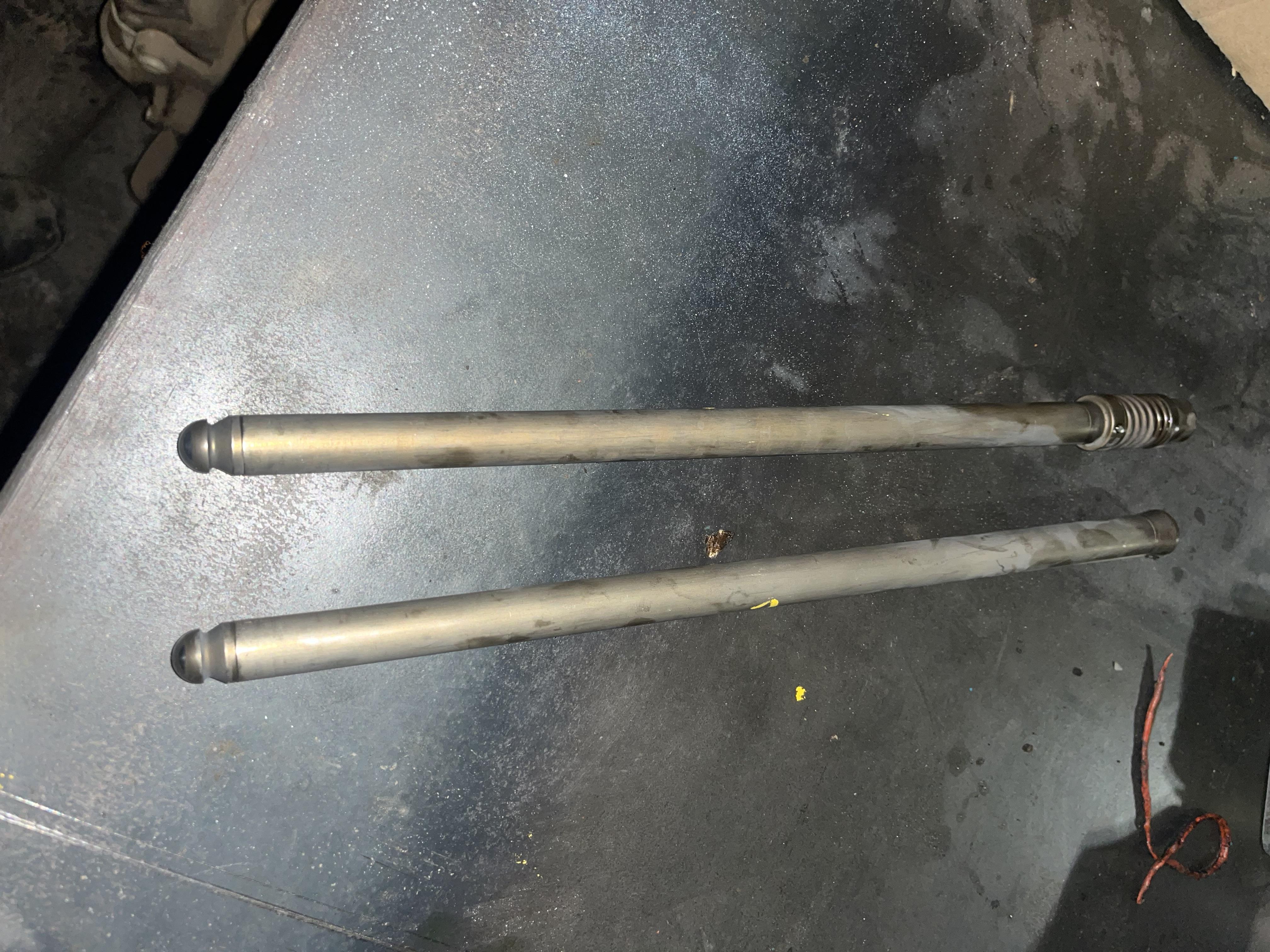

The motor has no Jake or engine brake…I have both an E7 and also a ETEC service manual….the ETech manual says that using ETech exhaust valve yokes/bridges on an E7 can release the valve retainers and drop a valve….would AI-300A motor exhaust valve yokes/bridges cause the same potential failure of dropping a valve….I attached pictures of the exhaust valve yokes/bridges that were in the AI-300A that I can use if they are the proper ones and also I’d like to use the pushrods that were in the AI motor if they are the proper ones….can anyone tell me if these are correct ones to use on an E7460? I can provide the casting numbers of the heads that I’m using to convert it if needed….I just don’t have them with me right at the moment
Thank you Joey Mack….what made me question all this was the diagram in my etech service manual…in the section on valve yoke installation it had brought up this issue with interchanging e7 and etech bridges….they had a diagram on how to differentiate the two but my bridges didn’t appear to match either bridge….my bridges aren’t rounded on the end like an e7 bridge nor are the underside of the button on same plane as the plane under the adjuster locknut….also my bridges don’t have .140” between them planes…more like .090 to .100” between the planes so I ask myself why don’t my bridges fit the profile of either the etech or e7 bridges as per the diagram…then I ask if my bridges not matching either profile are safe to use….thats what got me reaching out for help….
