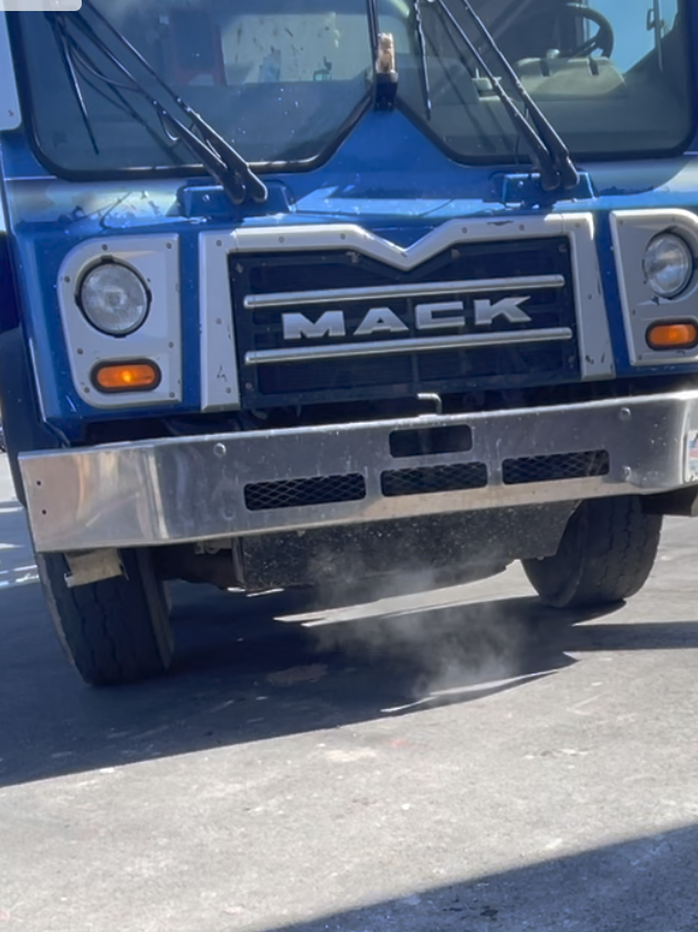

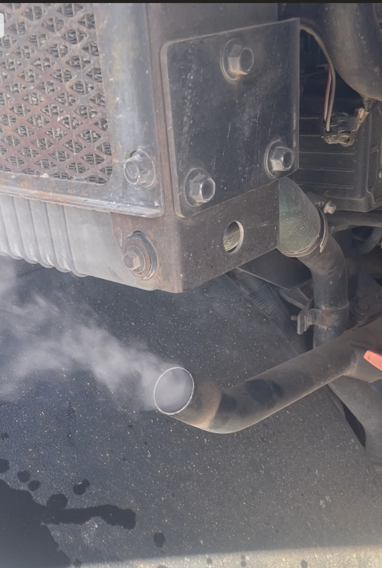

Coolant vapor in crank case, coming out blowby tube and oil fill tube. 2013 Mack MP7
Hey guys help would be appreciated!
Truck blows coolant vapors out of the blowby and fill tube. It's definitley coolant and not blowby from the rings. Coolant slowly drips out of blowby tube after the vapor condenses enough. We took off the valve cover and oil pan and everything inside looked clean. No sign of coolant in the oil. We then pressurized the cooling system for a couple hours and could see no leakage around the liners or up on the valve train. We bumped the starter a couple times to put the pistons in different positions in the liners but still could see no leak. We have heard maybe an air compressor could cause this? How do we test that? The EGR had been blocked at the exhaust manifold so we are doubting it's the EGR cooler. Engine runs great, no smoke from exhaust. Obviously we are concerned. Any theories?

So if it was a turbo wouldn't I get white smoke blowing from exhaust? coolant would leak into the exhaust then correct? how would I test if it is the turbo? It runs clean and has no smoke from exhaust. As stated before we dropped the pan and pressure tested it for two hours with no signs of coolant.
how often and how much coolant do you add to the tank?  have you pulled the top off the CCV to see if its got 'mayo' in it?
so the CCV is clean as well? no mayo........  I wonder if the air compressor is bad and passing coolant into the crankcase?
Ive heard that before it might be the compressor. But how would I go about checking that? Where would the coolant enter the crank case if it were doing that? the actual crank case breather has slow coolant drips coming out of the overflow tube as well as vapor.
coolant can pass through an air compressor that has a blown head gasket.  no different than an engine..  unfortunately, if you bypass the compressor cooling lines for too long you risk more damage to it.  so, in the morning after sitting over night, have you loosened the oil pan plug to see if coolant runs out around the plug ? does it blow mist/steam right away or does it need to warm up first?  Heck???  does the compressor look like its old and crappy? does it build air pressure good?
Ive drained the oil and have seen no coolant coming out of the threads of the oil pan or at all. Compressor was replaced by us two years ago. It seems to build pressure ok. The steam mostly come out when its under load and its in PTO. When it's idling out of PTO it's not as bad. (This is a concrete pump truck fyi)
ok,,  I dont have enough knowledge on MRU concrete pumpers. I assume with an Allison transmission, with its own cooling system, and cooler..  Is it possible that there is a leak in that system?  the tube you showed in the picture was new to me,  so I may not have enough knowledge to help you..
