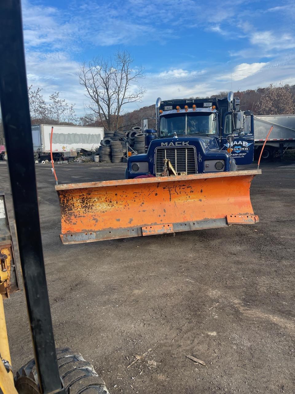

My 91 rd688s windshield fogs up severely in snow plowing conditions. I feel that the heater core and ac evaporator should probably be cleaned, is this something possible to do without removing either of them from the dash? I feel like I'm not getting enough airflow to the windshield to keep it thawed. Any tips? Thank you

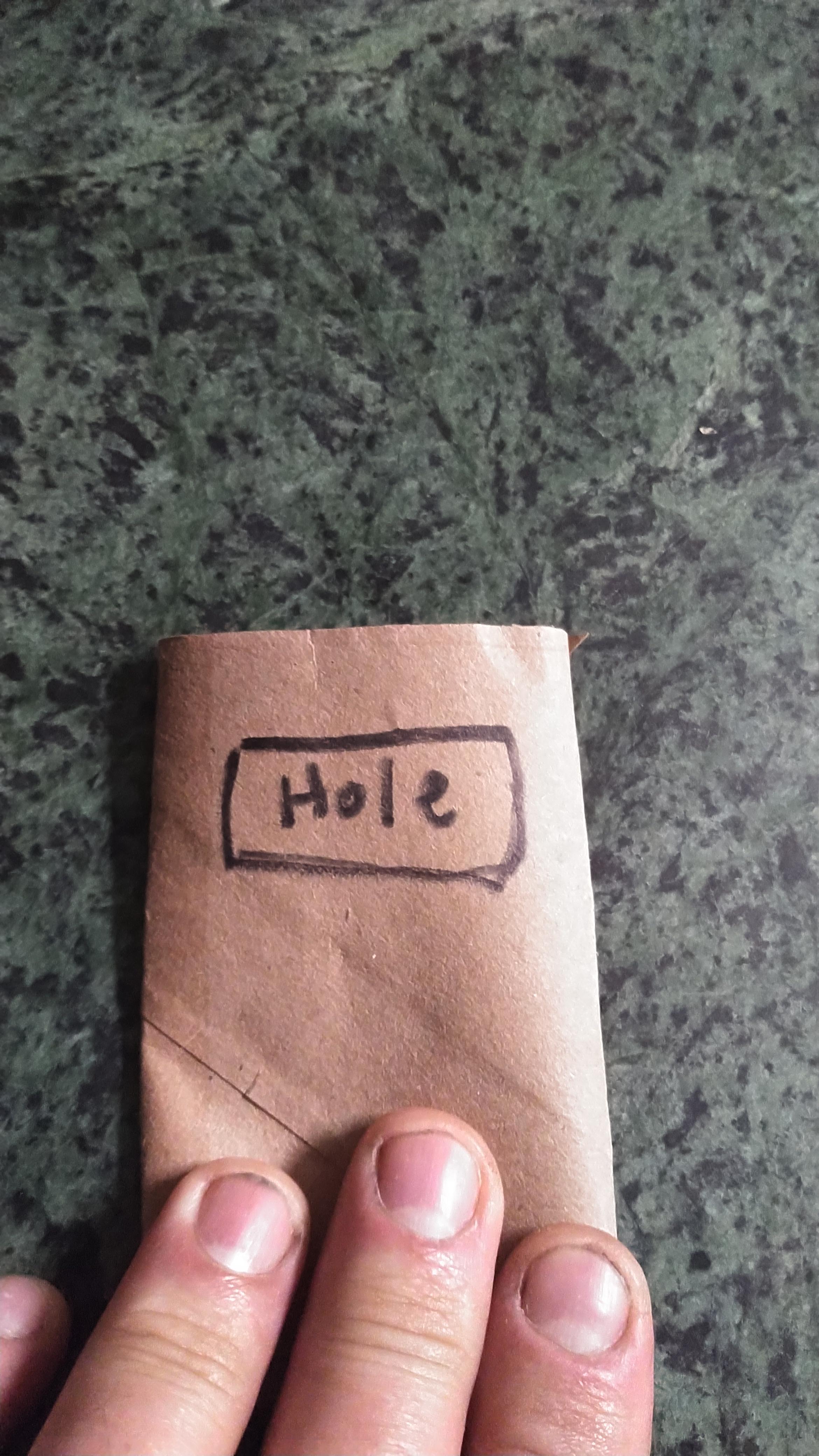

I am  well versed in this...  remove the screws where the large duct goes up to the heater core housing.  there is a rubber boot that seals the duct. slide it back a bit..  it may be dry rotted.  it is a PITA to get back in place when your done..  I made a cardboard tube round enough to fit over my shop vac. hose.. (12-16 inches long) then I flattened all of it but the round end for the vac.  I put layers of duct tape over the flattened end to keep it flat.  then I cut a rectangular hole on one side ( not through both sides, just one) , in the flat end 3/4'' from the end..  basically making a sideways sucker for the vac.  then I used a wedge to hold the large duct open and stuck that sucker in there.  I chose cardboard because it wont damage the core.  a combo of a blow gun and my fancy pants tools and some patience will get the dirt out.
