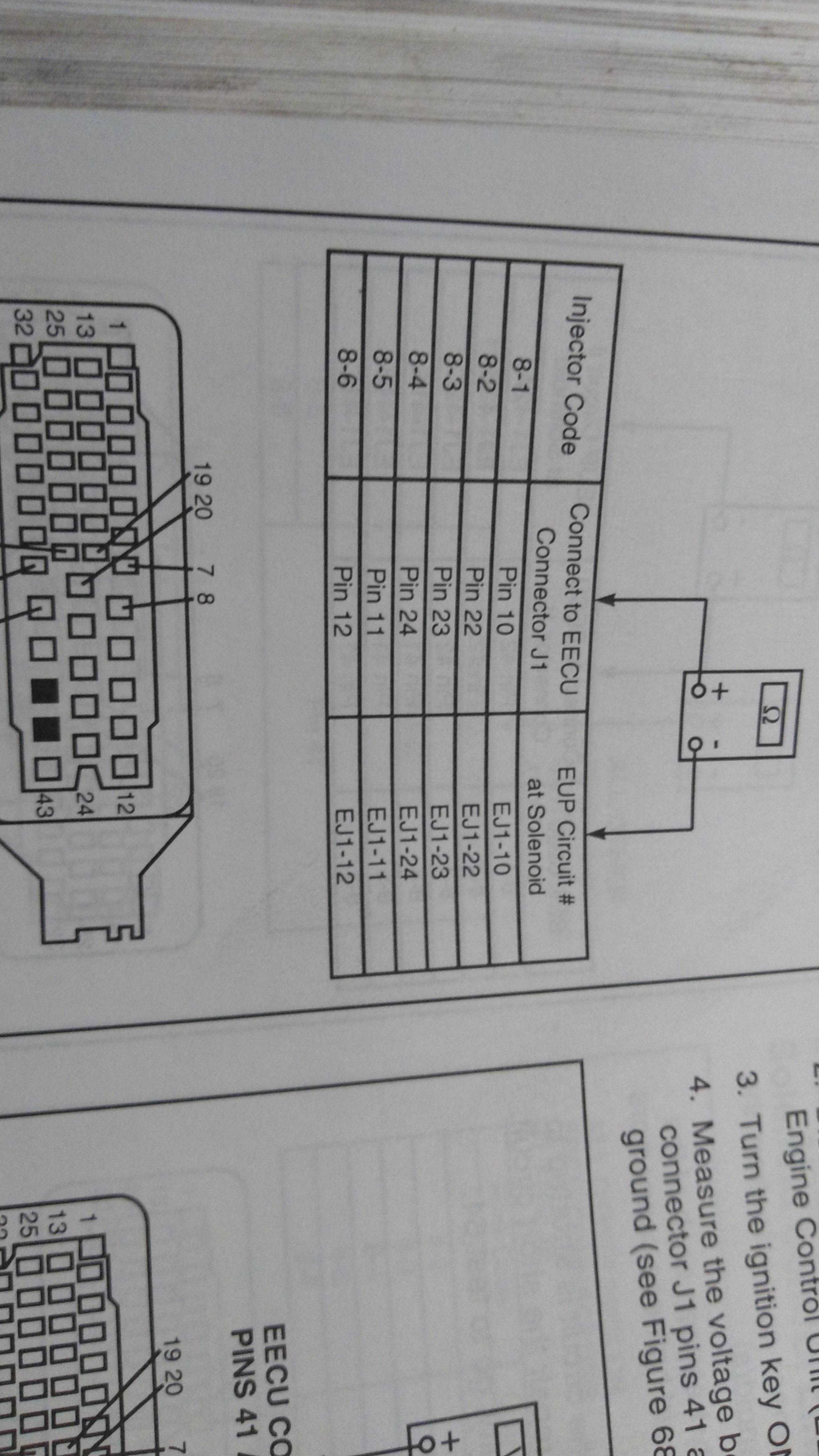

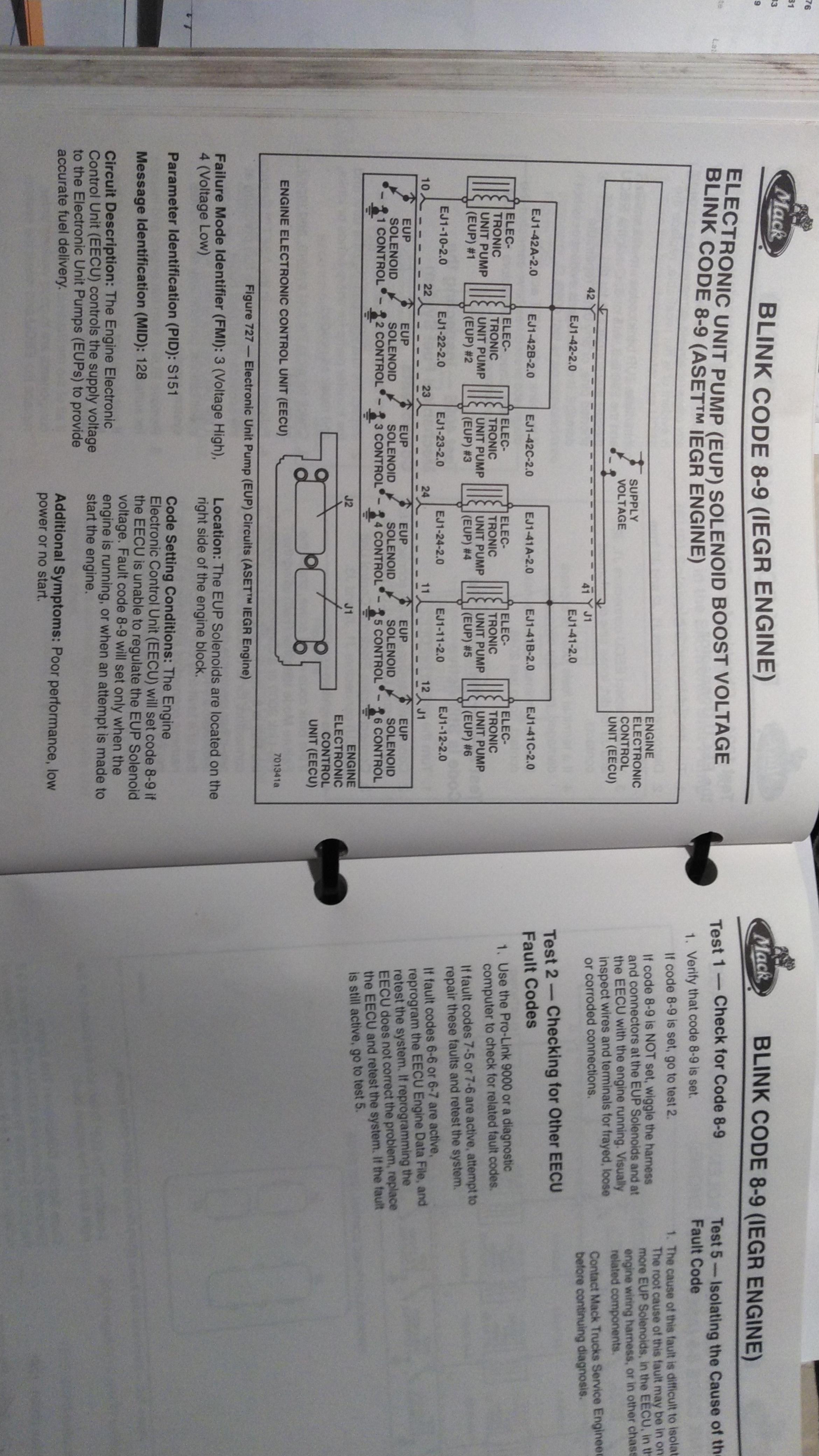

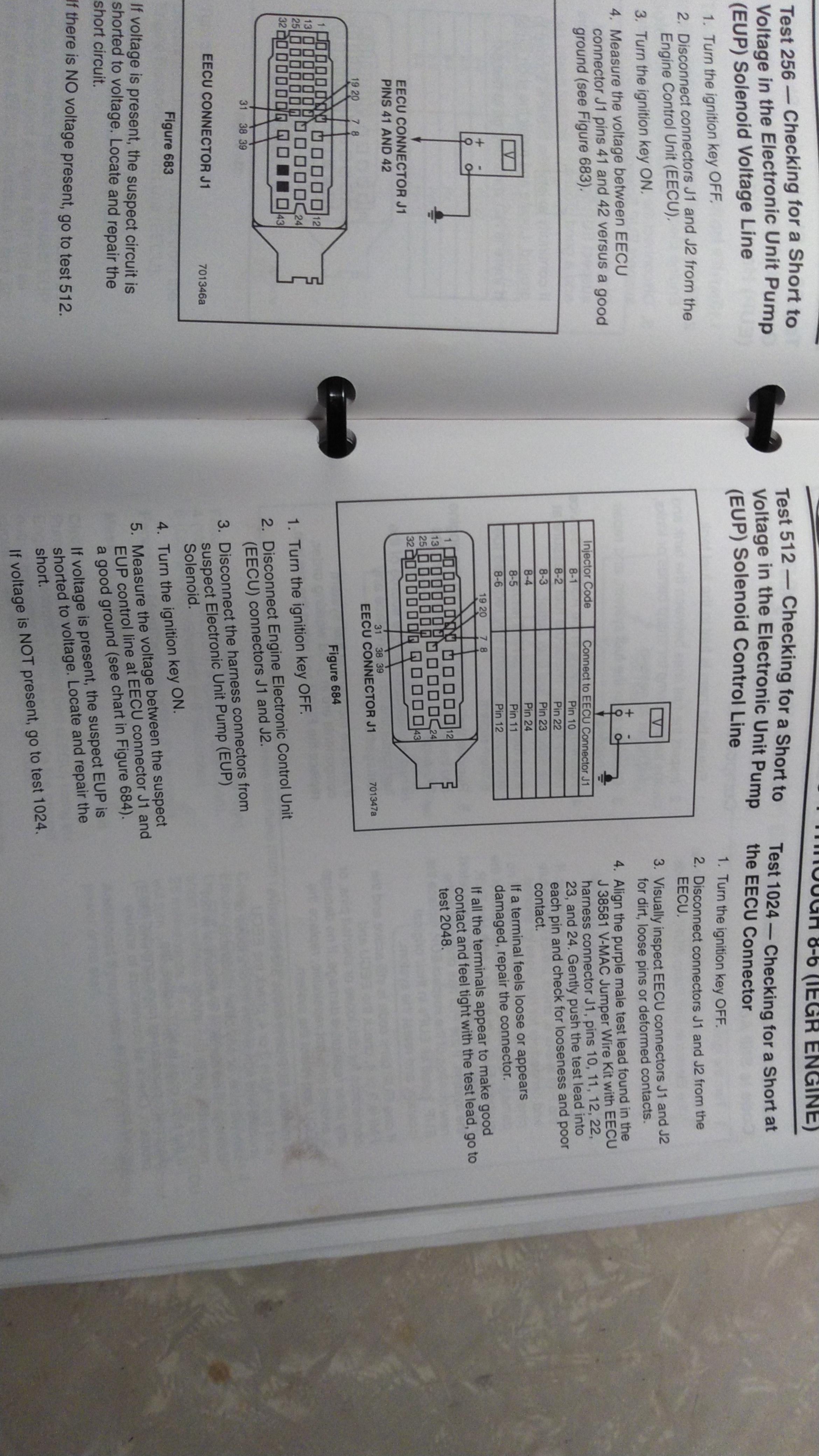

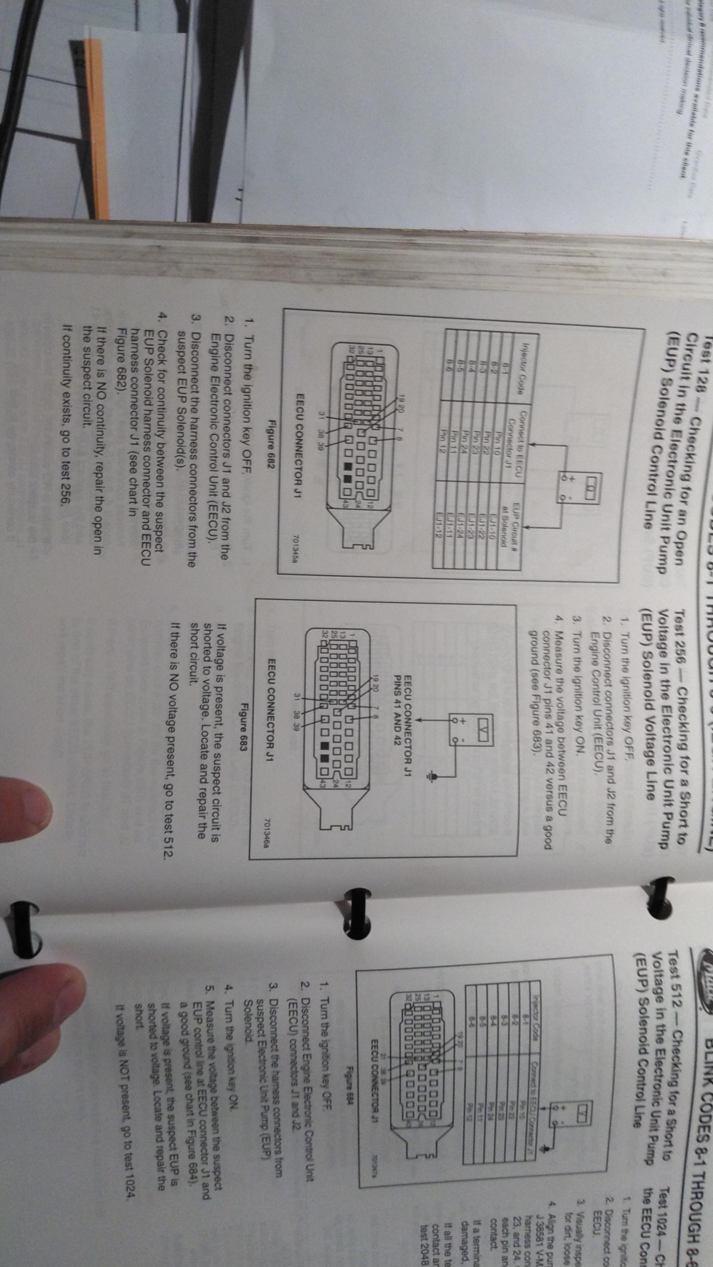

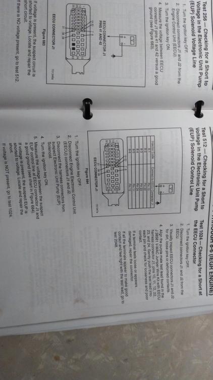

8-9 is related to all of them.. don't buy any pumps yet,  check the condition of the wire harness.. I Believe the ECM has only 2 plugs.  I know I posted the pin out diagram for them on other threads. And a couple others have too.  I think pin 11 + 12 in the J-2 connector are the comm lines.  1-3 are on one line and 4-6 is on the other.   To me, this is likely a wiring issue and not an EUP issue.. due to the 8-9 code... Jojo
I really wish I knew why the pictures would post in the " Batman Mode''...  I'm sorry..  i guess you can tilt the laptop to read it..   :)
Went through the wiring and everything looks good now I am only getting a 8-6 code. How much of a big deaL is it if I change the eup and it might be awhile before it gets programmed
well, #6 is not bad, just have the turbo pipe in the way..  How about pulling it and swapping it with an easy one,,, say...... #2 and see if the code follows it..  if it does replace the EUP and the orings on the swapped EUP, and put the swapped one back in its original hole, to keep the cal. code the same..  Jojo
P.S.  USE NEW EUP BOLTS, THEY TORQUE TO 60 lbft.
