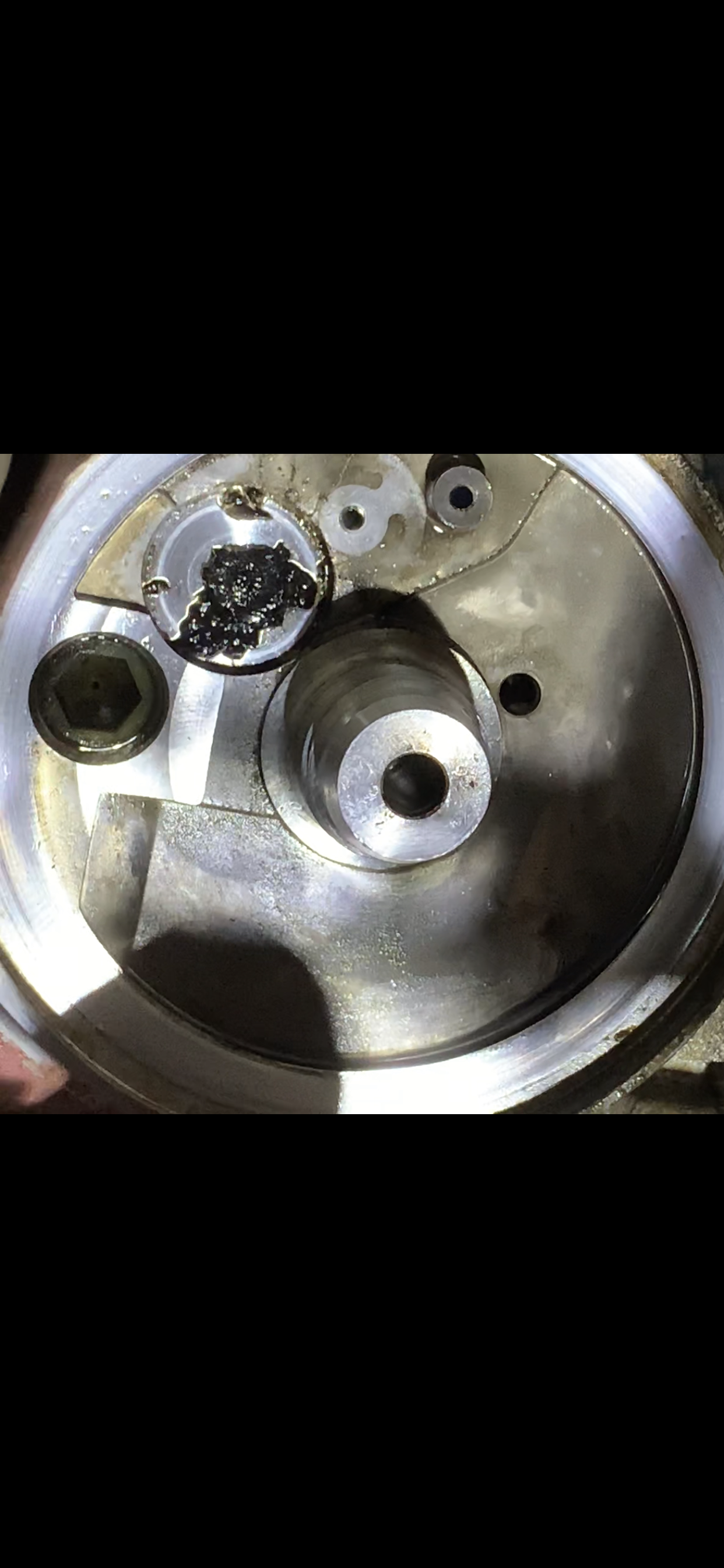

Mack deleted the fuel supply pressure on the common rail engines starting in 2017. They added it back on in middle 2021. Has the EPRV delete been done by the dealership? Biggest problem we see is trash gets stuck in the orange flapper in the rear of the fuel filter stand. Pull off rear fuel filter and remove flapper and check for trash. I’ll add pics soon
Here is one that I had already removed the orange flapper and it was plugged solid. One time I did have the screw that holds the flapper on break off in the filter housing so be careful. Might be possible to clean it out without removing the flapper

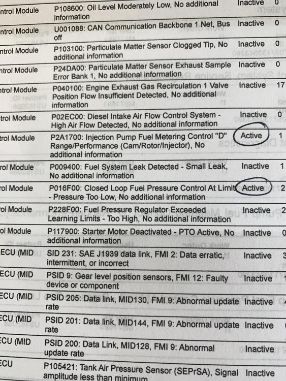

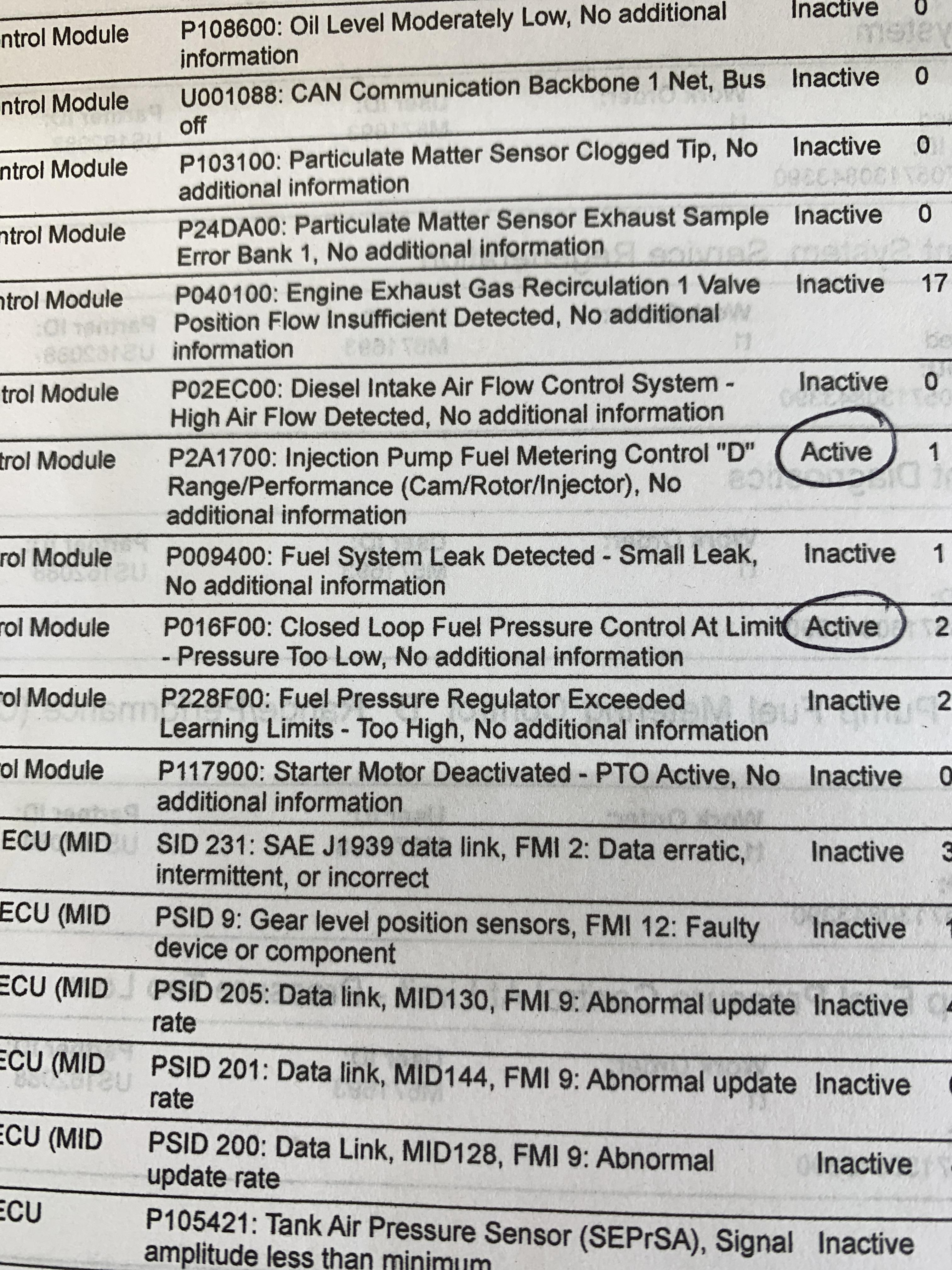

If you are getting either of the codes I have circled, very possible camshaft lobe on one of the pumping injectors has slipped. We had 2 in one week throw these codes and the #4 injector cam lobe had slipped on both trucks. One was a 18 CXU with 600,000  miles and the other was a much newer Anthem with 300,000 miles.
