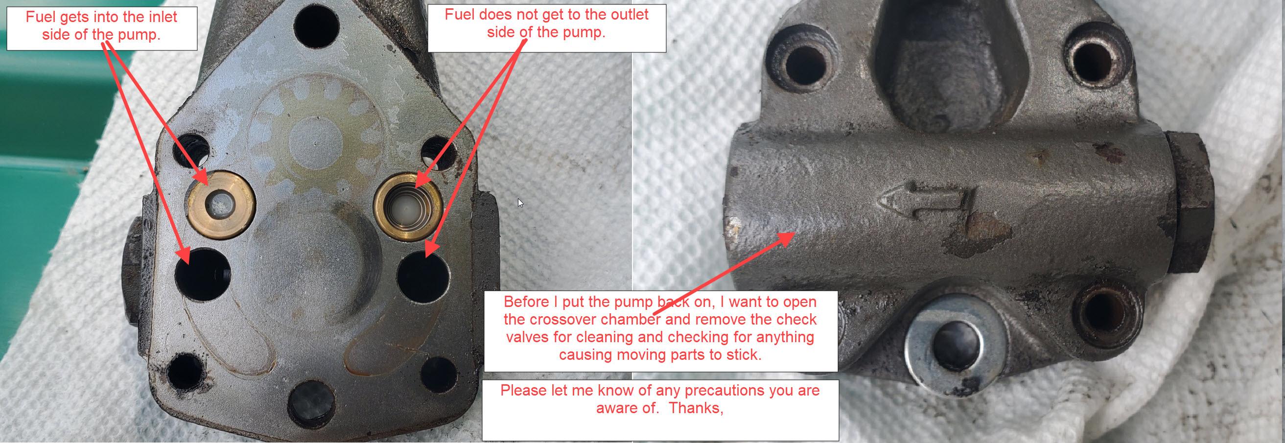

Hand primer easily pulls fuel from tank to pump.  Fuel just won't go from pump inlet to outlet.  Can the passage be opened and cleaned to unstick, or does it need specialized rebuild?  Any ideas on a source for a replacement?   Thanks,

I'll try blowing air through the lines, but, it seems the problem is internal to the lift pump.  Thanks,
It sounds like a blockage or a bad check valve from the description.  I mean, if you can't even hand pump fuel through it, there has to be something blocking the path.  And I'm not familiar enough with the internals to tell you what to do or not do.  But there are others on here who probably know that pump inside-out.

Before I put the lift pump back in, I want to clean and check everything in the crossover chamber to ensure nothing is hung up in there.  Fuel does get into the inlet side of the lift pump, but, not to the outlet side.  Let me know if you are aware of any precautions I should take before opening this up.  Attached photo for reference.  Thanks,
